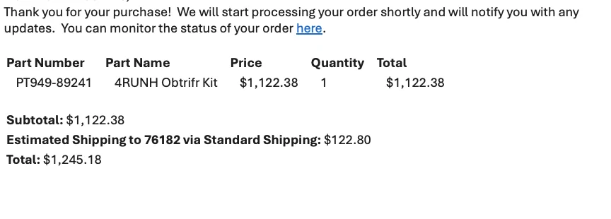

Well, I called the guy who did the video and left a message for him to call me or email to let me know if this will definitely work with a TRD ORP non-hybrid. I also spoke to his parts department and they said it will. So since I'm a glutton for punishment...look what I did :)
Best of luck. I honestly hope I'm wrong but I just don't see the similar trim spot above the right rear wheel on the non-hybrid photos that I see on the Hybrid (including TH where it comes and Pro where it is option - and my TRD ORPH.) I suppose the power connector might be in there somewhere but am not sure where you would mount the compressor and the control panel. To be clear, I am using these photos as reference
