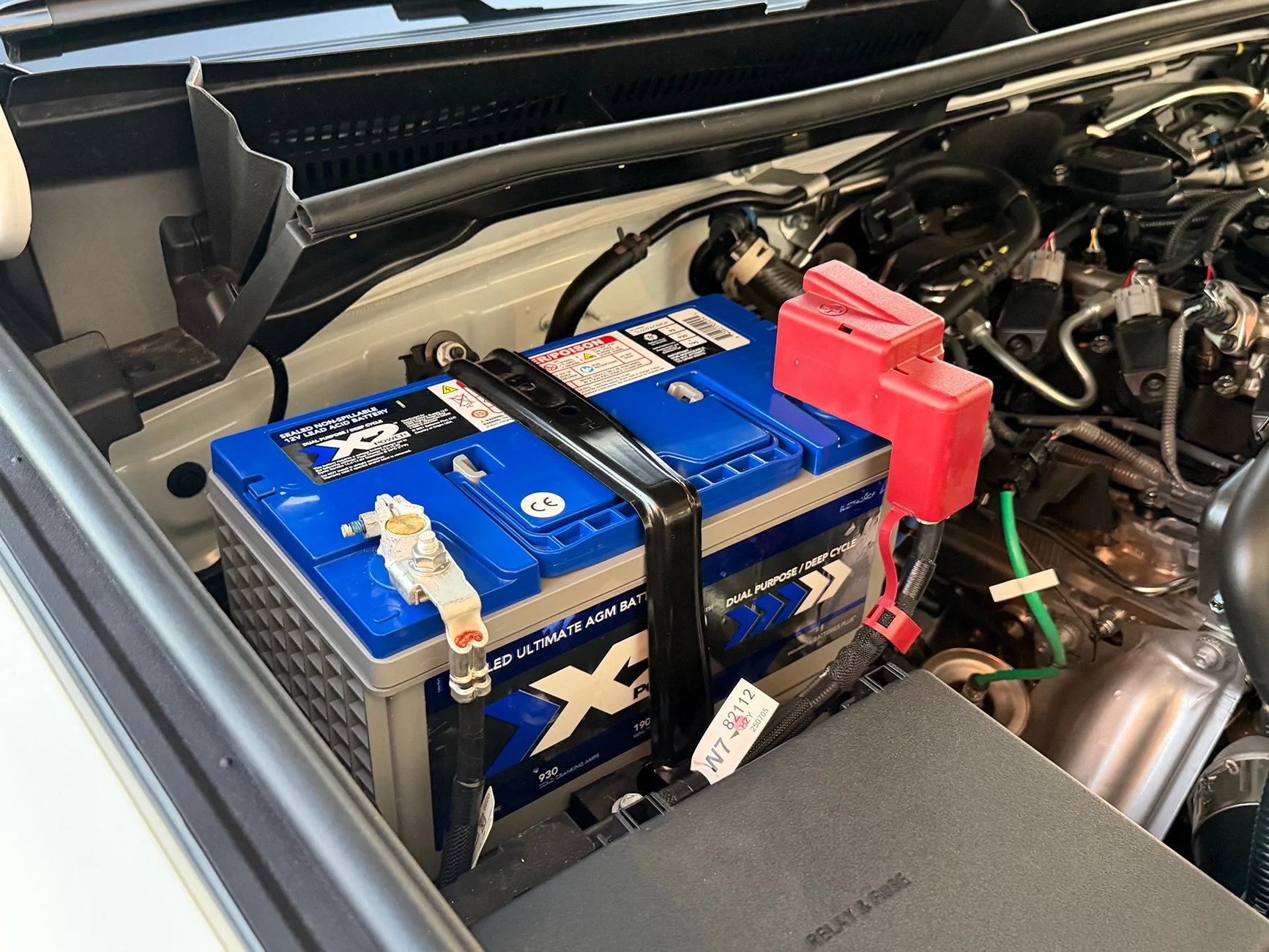

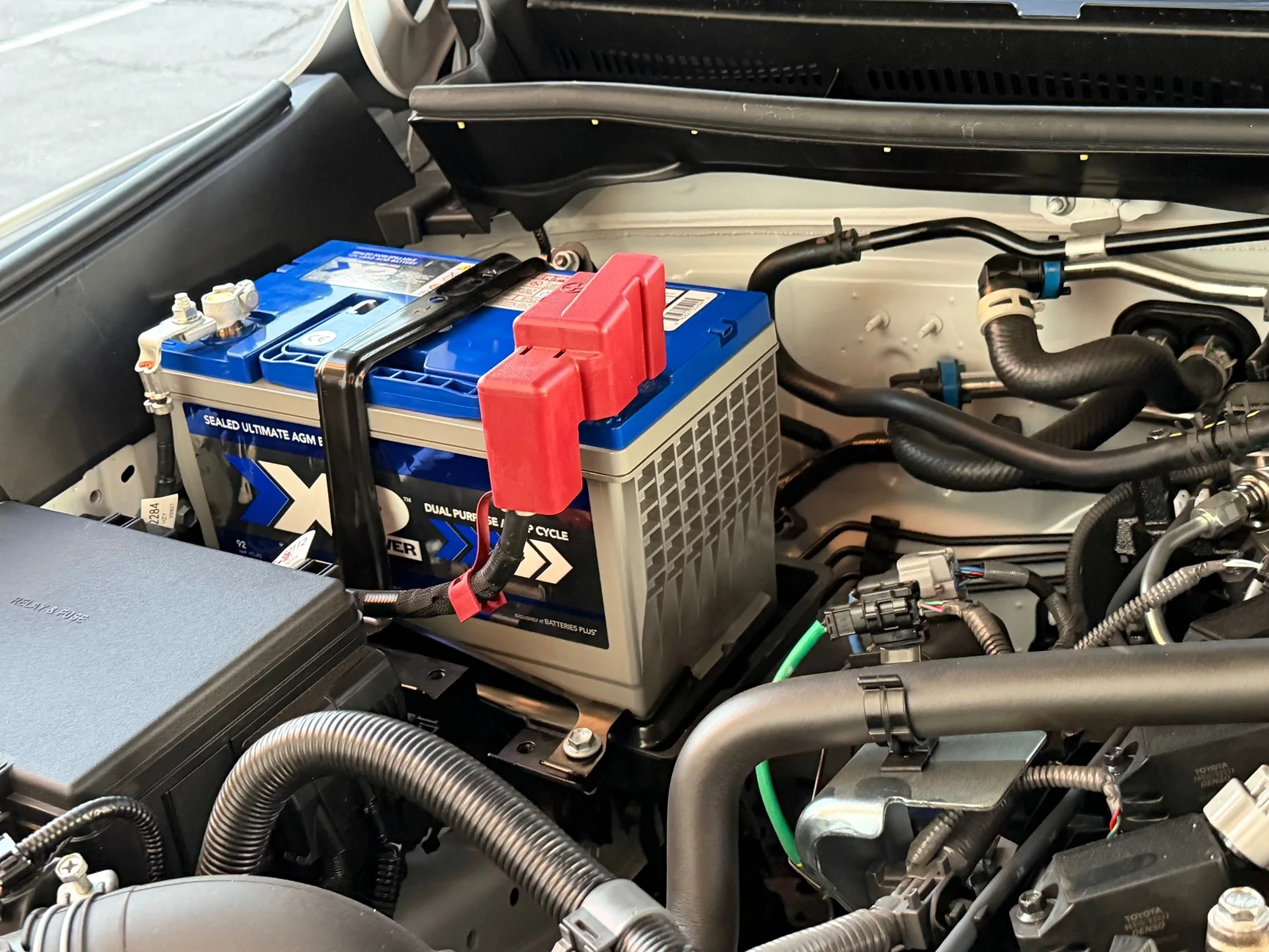

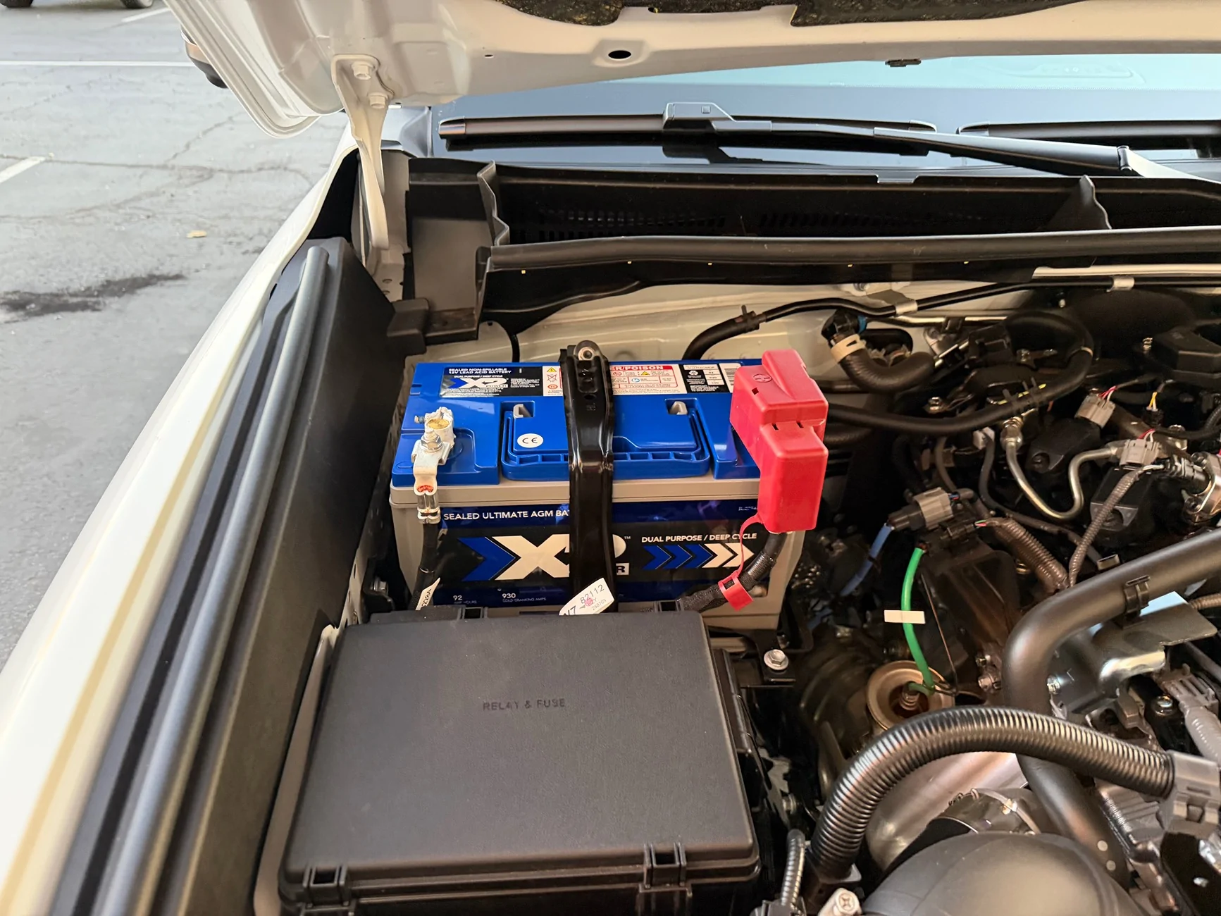

Just installed a group 27 agm battery yesterday it fit with the stock clap downs I just had to add a 3/4 on the strap and 2 - 1/2 inch rubber bushings as spacers on the battery tray. The bolts are long enough to work but I will get longer ones soon just in case.
