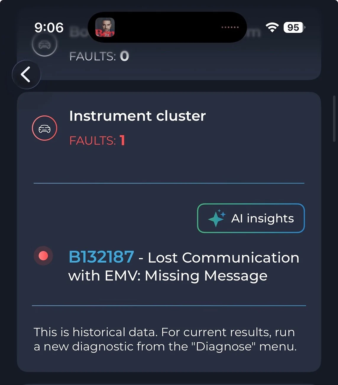

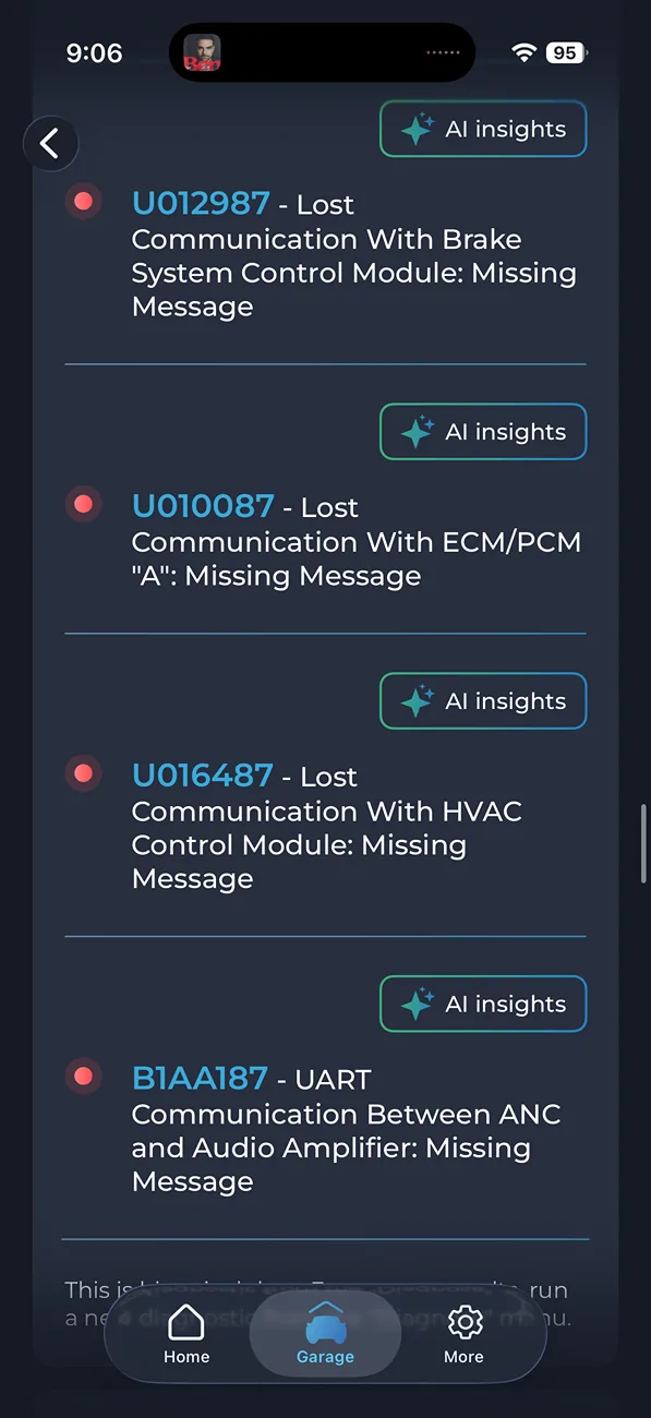

Has anyone noticed the battery on their 6th gen fluctuating a-lot while driving? ive noticed my battery meter dropping quite a bit while driving and gradually getting charged.
i also have seen a few error codes around “lost communication” which based on my reading could be due to battery/power issues

which battery ?
hybrid battery will go up and down all the time
12v battery should remain stable 12v or higher
in regards to those error codes, what tool did you use ? Use
a proper scan device that is preloaded with 2025/2026 Toyota 4runner data so the
codes will be interpreted correctly.
if the 12v is low and causes any real issues there will be messages in
the dashboard alerting you there is a problem. if it is just your scan tool
reporting codes, [and it is not a techstream], and there are no real
issues you can determine outside that scan tool, ignore it.

Carista does not interpret 6th gen 4runner audio system codes correctly, it is very limited in what it can do.
https://carista.com/en-us/apps/supported-cars/toyota/4runner/6th-gen

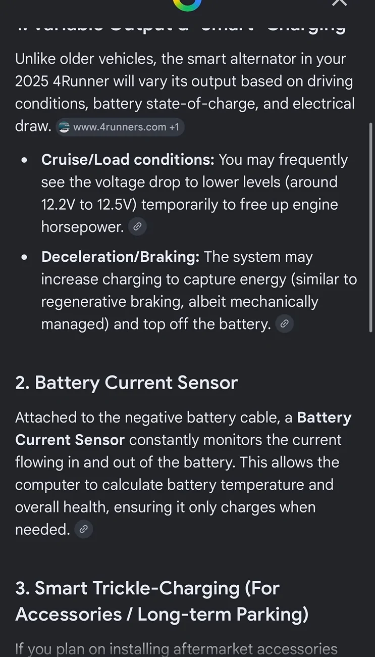

based on what im reading its part of toyotas smart charging system for batteries
just curious if anyone has seen this on their non hybrid vehicle
it also looks to be a feature for vehicles with ass which the limited does unfortunately

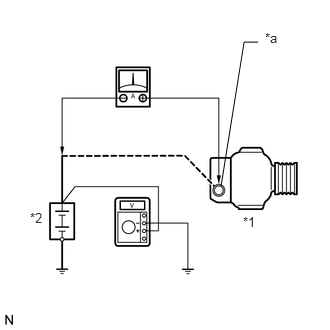

here is how to test
7. INSPECT CHARGING CIRCUIT WITHOUT LOAD
CAUTION:
  • To prevent injury due to contact with an operating V-ribbed belt or cooling fan, keep your hands and clothing away from the V-ribbed belt and cooling fans when working in the engine compartment with the engine running or the ignition switch ON.
  • To prevent burns, do not touch the engine, exhaust manifold or other high temperature components while the engine is hot.
Pre-procedure1
(a) Connect a voltmeter and an ammeter to the charging circuit as follows.
HINT:
If a battery/generator assembly tester is available, connect the tester to the charging circuit in accordance with the manufacturer's instructions.
(1) Disconnect the wire from terminal B of the generator assembly and connect it to the negative (-) lead of the ammeter.
(2) Connect the ammeter positive (+) lead to terminal B of the generator assembly.
(3) Connect the voltmeter positive (+) lead to the positive (+) terminal of the battery.
(4) Ground the voltmeter negative (-) lead.
2025 2026 4runner 6th gen Battery issues? A125200C21
*1​
Generator Assembly
*2​
Battery
*a​
Terminal B
Procedure1
(b) Check the charging circuit.
(1) Maintain the engine speed at 2000 rpm and check the readings on the ammeter and voltmeter.
Standard Current
Specified Condition​
Result​
10 A or higher​
A​
Standard Voltage
Result​
12.7 to 15.3 V​
V​
If the result is not as specified, repair or replace the generator assembly.
Post-procedure1
(c) None.
8. INSPECT CHARGING CIRCUIT WITH LOAD
CAUTION:
Pre-procedure1
(a) With the engine running at 2000 rpm, turn the high beam headlights on and turn the heater blower switch to the "HI" position.
Procedure1
(b) Check the reading on the ammeter.
Standard Current
Result​
30 A or higher​
A​
HINT:
If the battery is fully charged, the reading will sometimes be less than the standard current. In this case, add more electrical load (operate the wipers, rear window defogger, etc.) and check the reading on the ammeter again.
