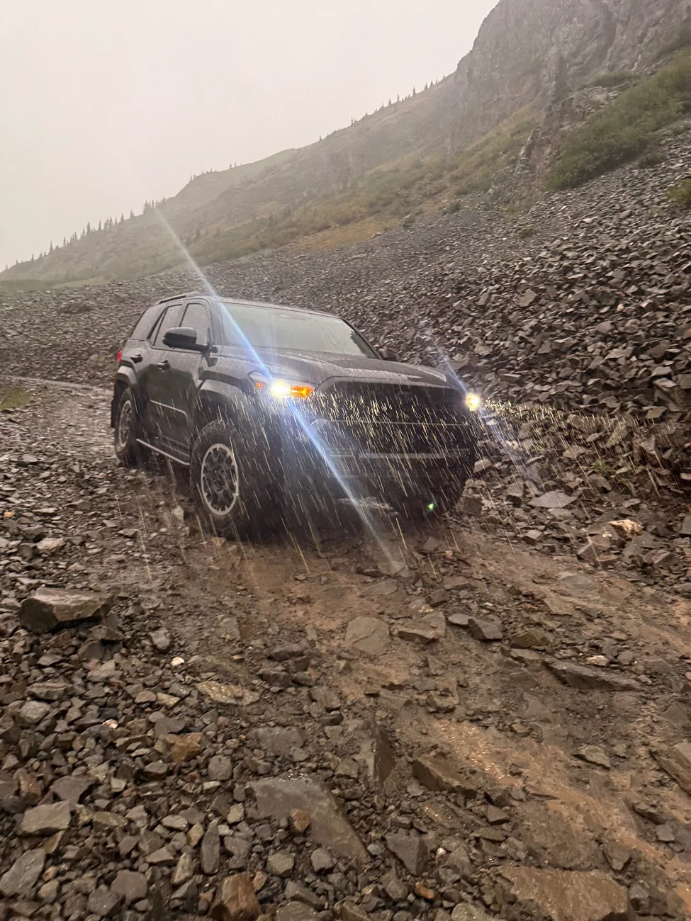

I recently repeated the same 3,000 vertical climb outside of Silverton CO. 2 days apart. I'll provide details for my findings as I used this as an opportunity to experiment with the overheating. Worth noting, I've done this one numerous times in my 5th gen with oversized tires and 4Hi or 2WD and had no issues with temps.
3,000' climb on gravel and loose rock: Attempt #1
  • Transfer Case: 2Hi and 4Hi
  • Transmission Shifter Position: “D”
  • Drive Mode: Normal but as we climbed higher, tried to stay in lower gears manually
  • Vehicle Speed: ~10-15 mph most of the time, varying from 5–20 mph depending on terrain
  • Duration: Transmission temp started to increase past the normal middle within the first 200 vertical feet. Almost instantly. Total climb time was maybe 15 min?
  • Additional Weight: no back seat, mostly empty inside. 1 passenger. 2 mountain bikes on 1up rack.
  • Tire Size: KO3 275/70/18, e rated 25lbs over stock weight per tire
  • Transmission Cooler: Nope
  • Other Details: Visible heat increase on the gauge. Never let it overheat or trigger a warning. Had to stop along the way. Ambient temps 70->50 F
3,000' climb on gravel and loose rock: Attempt #2
  • Transfer Case: 4Lo
  • Drive Mode: Normal.
  • Vehicle Speed: ~10mph most of the time, forced to stay at lower speed even when it wasn't required
  • Additional Weight: no back seat, loaded down with some camping gear this time. 1 passenger. 2 mountain bikes on 1up rack.
  • Other Details: No stopping, no overheating. Only downside was slower speeds due to 4Lo when it wasn't really necessary. Ambient temps 70->50 F. Photo is from the way back down after it rained.
