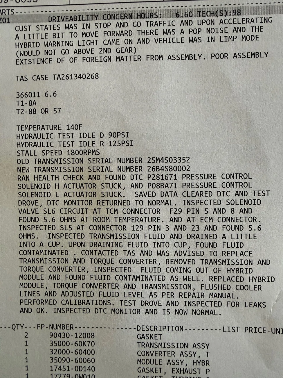

Got my rig back today after 3 weeks. They did provide me with a loaner 4 runner while I waited. Posting a picture of the techs notes for reference. In the end they replaced the transmission, torque converter and hybrid module. All of which had “foreign matter” found in them.

How does it feel compared to old tranny and loaner?

I took it on a drive tonight on the freeway, some backroads highway and stop lights through town. I know I am ultra tuned into how it feels, but honestly I think it feels better than it did prior to failure (and better than the non hybrid loaner I had the last few weeks). There was always a bit of unsmooth shifting, especially from 1st to 2nd and I just thought it was normal and how this car drives. That seems to be all but gone now. Need to give it a few more days, but I am thinking something wasn’t quite right with mine from the get go.
