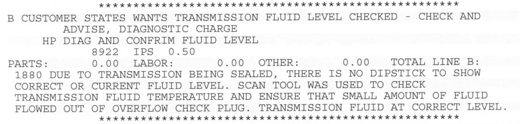

No guarantee of prevention, but I'm thinking of booking mine in for a transmission fluid level check/top off.
RunnerRocks
RedDog
Dec 15, 2025
445
296
Nature
2026 TRD ORP (non-hybrid)
Call me paranoid. Our previous 2020 Ford Ranger was 3/4 quart low from the factory which resulted in some wonky shifting.
I had our level checked while at the dealer last time. Level was good.
