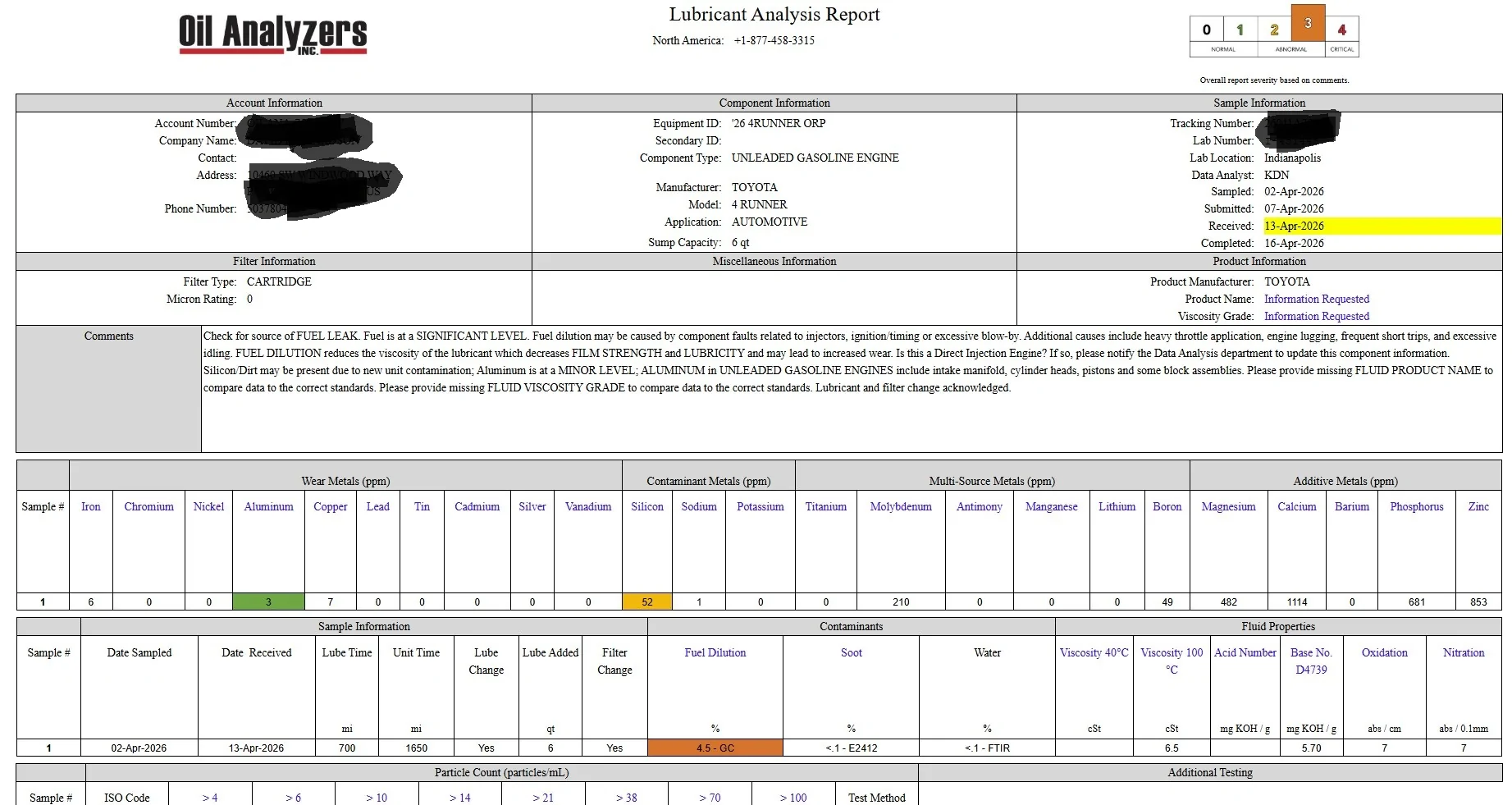

Below is my report from oil analyzers. I expected the gas in the oil to be high due to direct injection, but most of the last 300 miles before testing were freeway miles. The aluminum is not too high, but the Silicon is quite high. Not sure why the silicon is high - maybe gasket sealant? Unfortunately I did not get analysis done on the oil from the first 700 miles.
In the notes they tell me to let them know that it's direct injection. I assume this so they won't call the amount of gas high. I see now way to do this on their equipment list.
Couple of complaints:
- I didn't get any email update about my sample getting received or tested by them
- Their online tools to set up equipment and submit samples is terrible. I do software for a living. This is right out of the early 2000s from a UI perspective

How often is your plan to change oil? Are you going to start lengthening your oil change intervals more towards the 5k mark? does this data change any of that?

I plan to change it again at 5K and then probably every 4K. I'll get more analysis done and will change at 3K if it continues to have high gasoline percentage, but I'm hoping 4K works.
I forgot to mention that my oil was surprisingly dark, especially with only 800 miles on it.

That is the plan. I'd also like to do one after a long drive (100+ miles) and pull some oil to see if most of the gasoline gets evaporated out. With the direct injection and constant re-starting of the hybrid engine, constant gas contamination is a concern.

I have other direct injection vehicles as well as some port injected, several of which are modified and run richer than most factory vehicles will at WOT and I still can’t get over how much worse the fuel smell is in the oil of the 4Runner at just 3000 miles. I can’t imagine the fuel dilution at 5-10k intervals

100% argee. I was thinking my oil was somehow overfilled. It's almost certainly gas in the oil. And I can smell it. This is a little concerning.
I took a sample of my oil with ~1500 miles on it and many short trips. I then took another sample after two long trips of ~120 and ~200 miles with no short trips between them. I'll get both of those analyzed and see if longer trips do anything to help get the gas out of the engine. I suspect those long trips do not.
I also assume it's made worse by the frequent stopping and re-starting of the hybrid engine.
