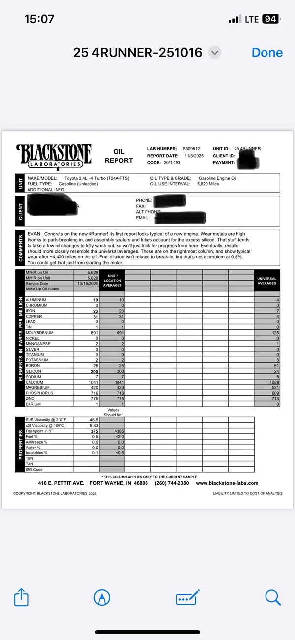

Just did my first change @ 5629 miles. Swapped in a Fumoto F133L oil drain plug for easier future changes. Oil was dark “reddish” amber. Replaced with Mobil 1 Full Synthetic Hybrid. Will post an oil report when available.
