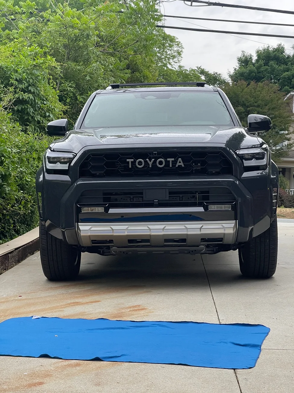

My TRD ORP Hybrid turned one year yesterday so figure it deserves some attention.
Notably, I had my first opportunity to use the tow tech package features - I really liked the help from the Trailer Reverse Assist function. Calibration took very little time and effort and having the feature made it possible to back into my driveway in the dark. I used Tow Haul mode for a while but found that the engine never shut off even when coasting downhill and given the relatively light weight of the trailer (maybe 1500#) I really didn't need the extra RPMs - I had no issue cruising at 70 on I-95 in regular drive mode (and accelerating to change lanes when needed).

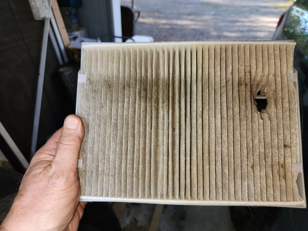

I had recently replaced the cabin air filter because I had "rattling" when the defrost fan was on high and discovered this disconcerting site:
2025 2026 4runner 6th gen What did you do to your 6th Gen 4Runner today?? πŸ‘¨πŸ»β€πŸ”§ 🧰 πŸ›  20260417_181925

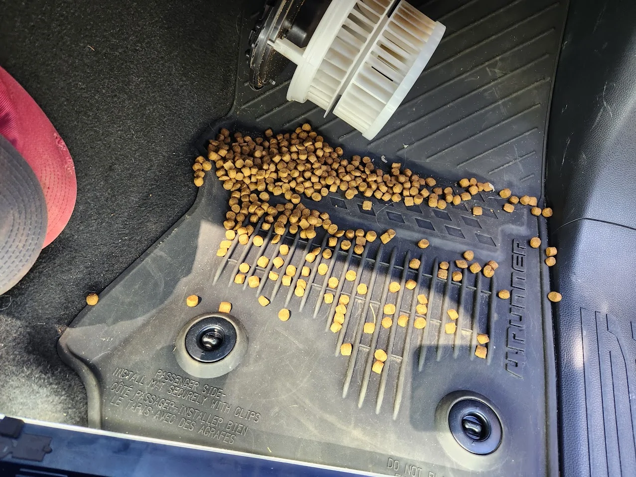

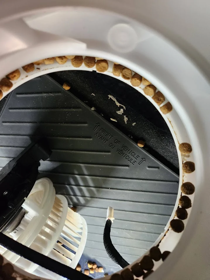

Looked like mice had chewed through the filter (no idea how they got into this spot). I figured the rattling was the pieces of filter in the fan. I was wrong. Turns out that my fan was a food storage location. Note that vehicle is garaged every night so they must be in my garage - where they must have gotten into the dog food.
2025 2026 4runner 6th gen What did you do to your 6th Gen 4Runner today?? πŸ‘¨πŸ»β€πŸ”§ 🧰 πŸ›  20260503_141804
Below is view looking down from inside glove box where cabin air filter goes. Removing the fan was unfortunately necessary to remove the debris. Not hard but need to be a bit of a contortionist and use some stubby tools to get to the 3 8 mm bolts holding the fan assembly up.

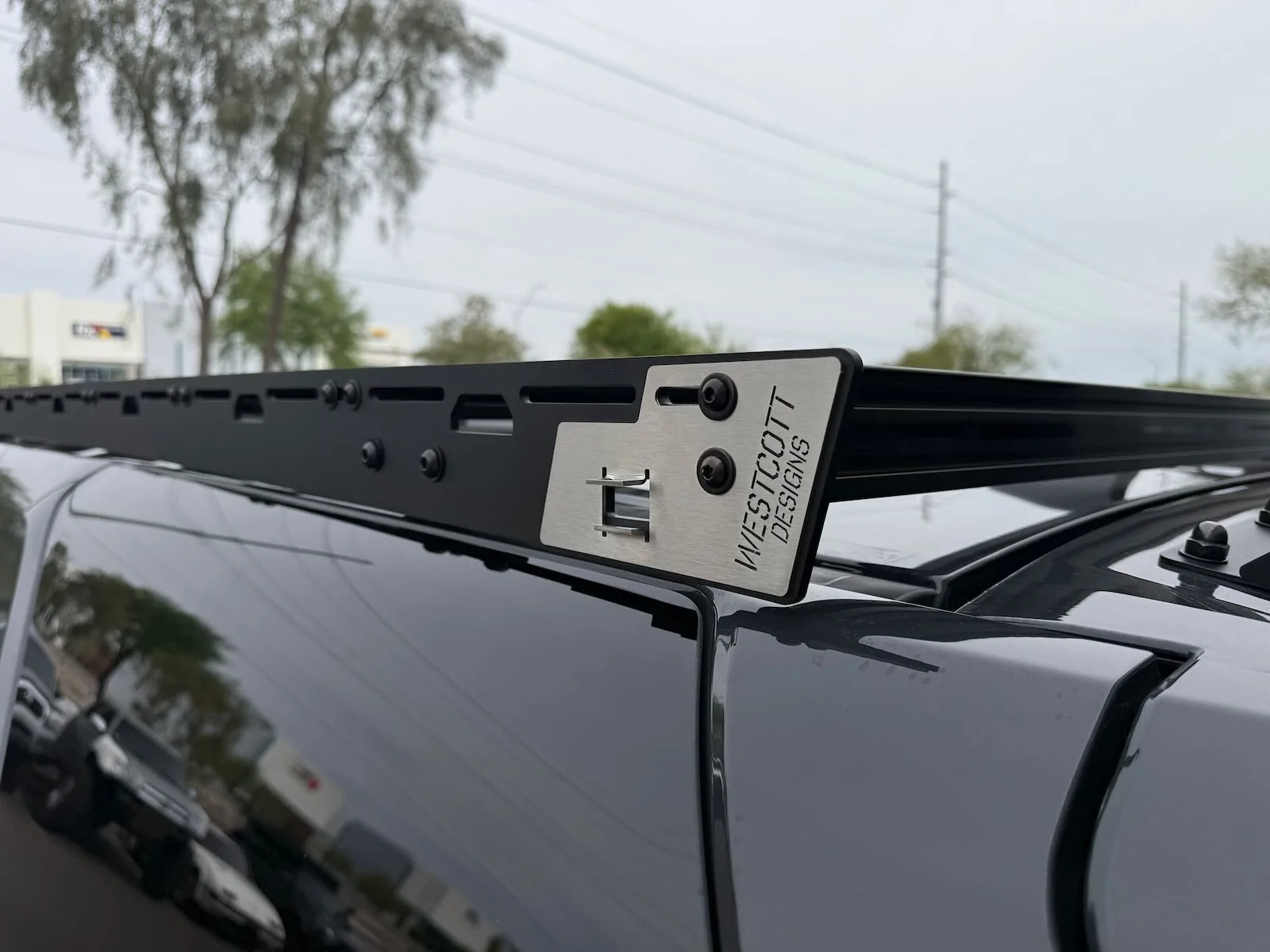

New updates from Westcott:
Full length low profile rack
Rock Sliders
Driver's side hitch swing out for two jerry cans and a spot in the middle for the floor jack (I have to order the mount that has locking capabilities).
