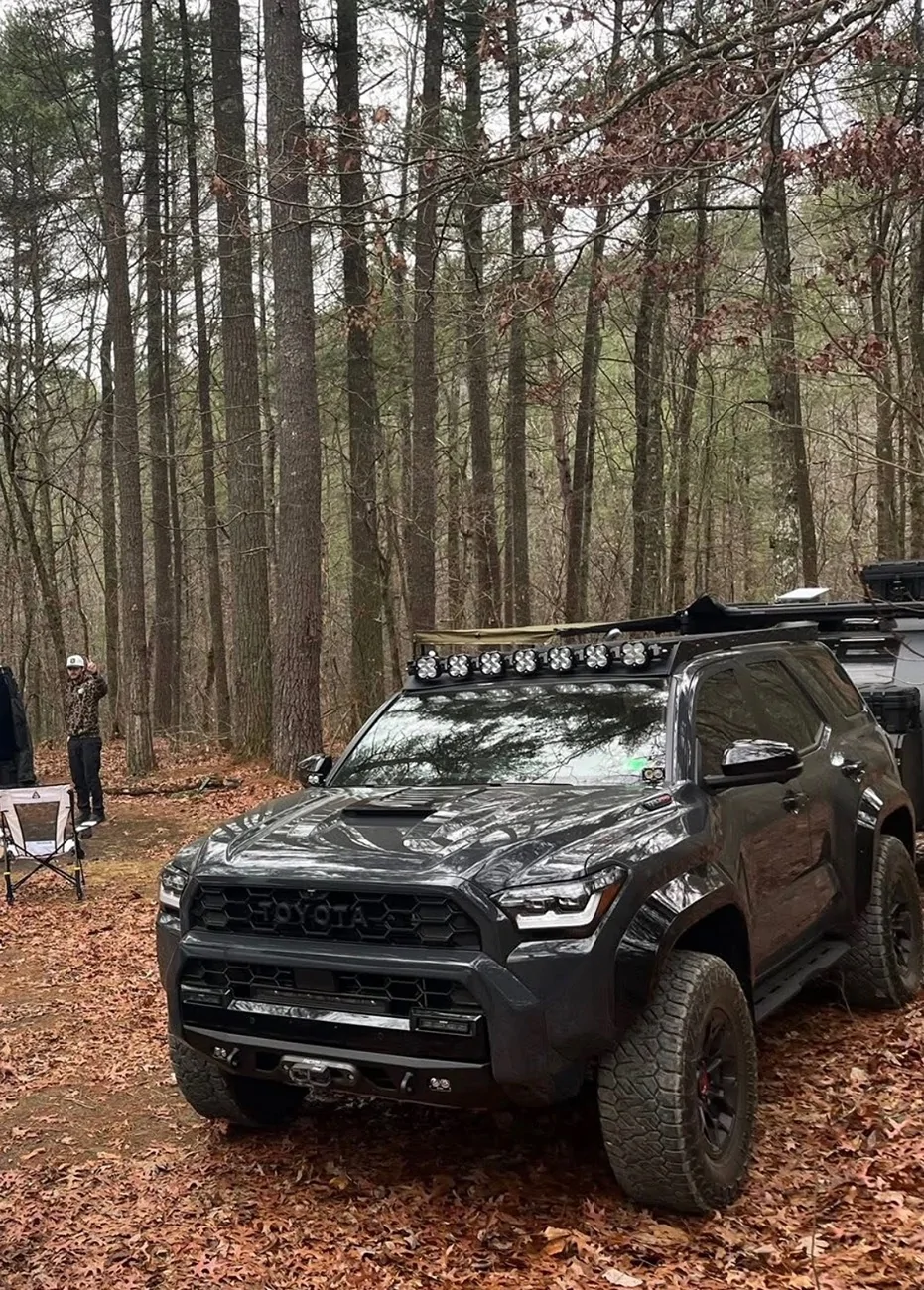

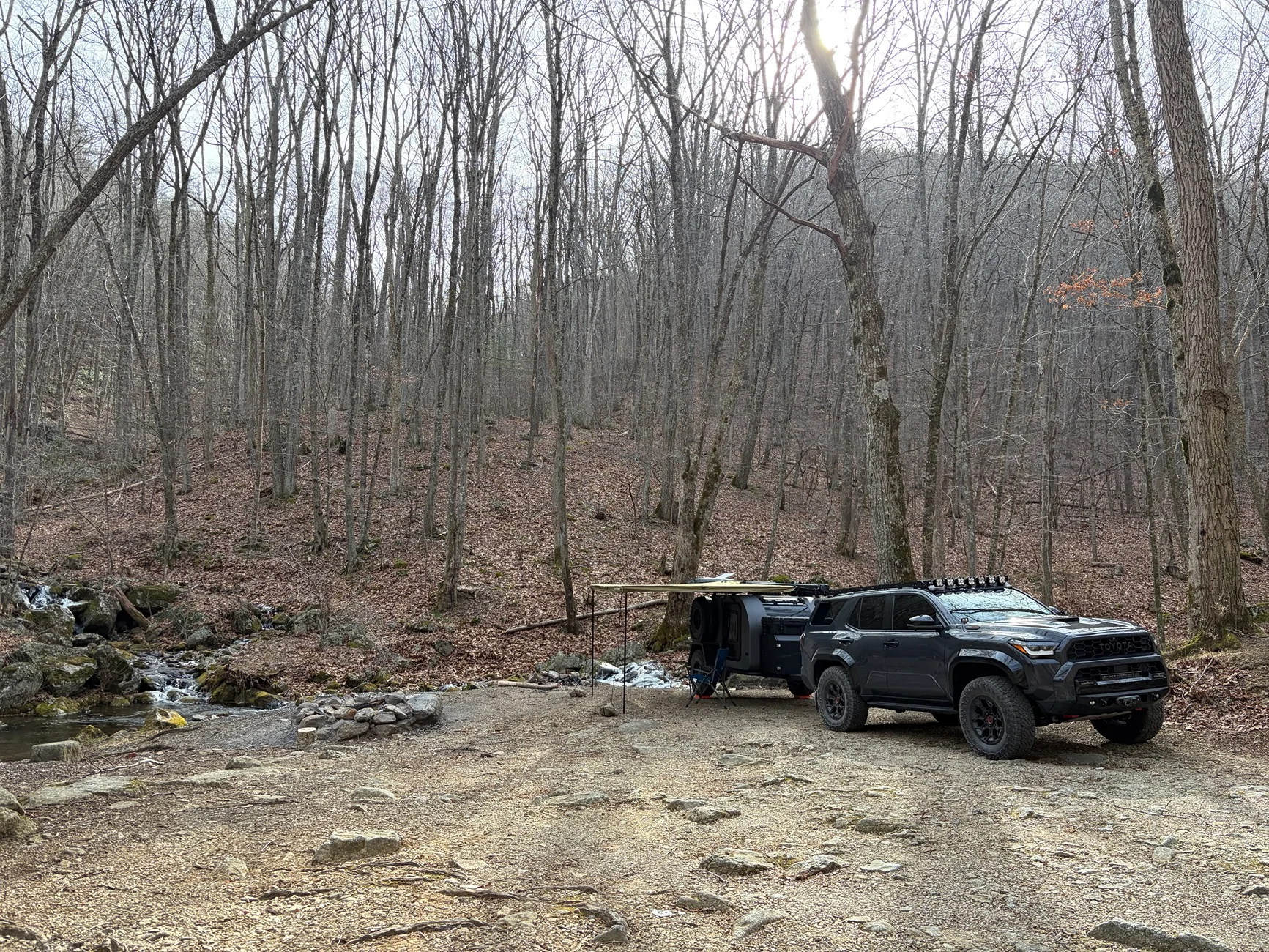

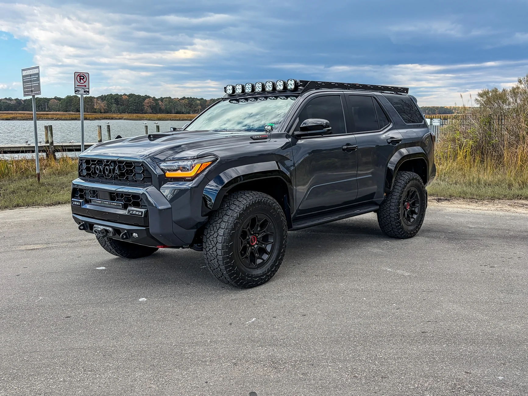

Thanks man! I am still in love with it for sure. Since these pics, I’ve added a CBI stealth front bumper and a Westcott Designs low pro roof rack with Baja Designs LP8s on it as well as S2 Pro ditch lights. I did change the suspension up slightly as well. Dobinsons rear springs and a Westcott Designs front Collar only lift. Last pic is were I currently am right now in it haha

looks amazing. with the addition of the bumper and winch did you notice the front end dip? or said differently did the front end have more rake? I'm looking at the same bumper and want to avoid any front end rake. Also, did you attempt to put the spare back underneath once you went to 295's?

Thanks! The bumper and winch will lower the front end 1/4in so just plan accordingly . As for the spare, no way it would fit so didn’t even try

Looks fantastic! Really curious if you have any significant issues with rub off-road. I have a Trailhunter and I’m trying to decide between 295/70/18 and 285/70/18. I’m going with the Westcott Preload Kit and I know I can fit the 295’s, just concerned about significant rub when I’m articulating over rocks/ditches.. Not worried about minor rubbing, I run into that now on the stock 265/70’s.

If you take the crash brackets off then there will be zero rub through all articulation
