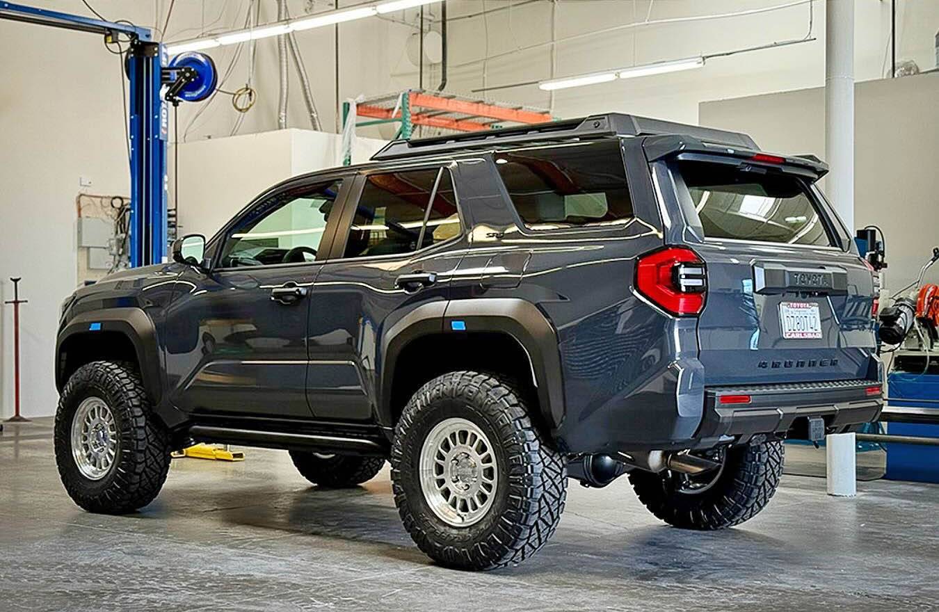

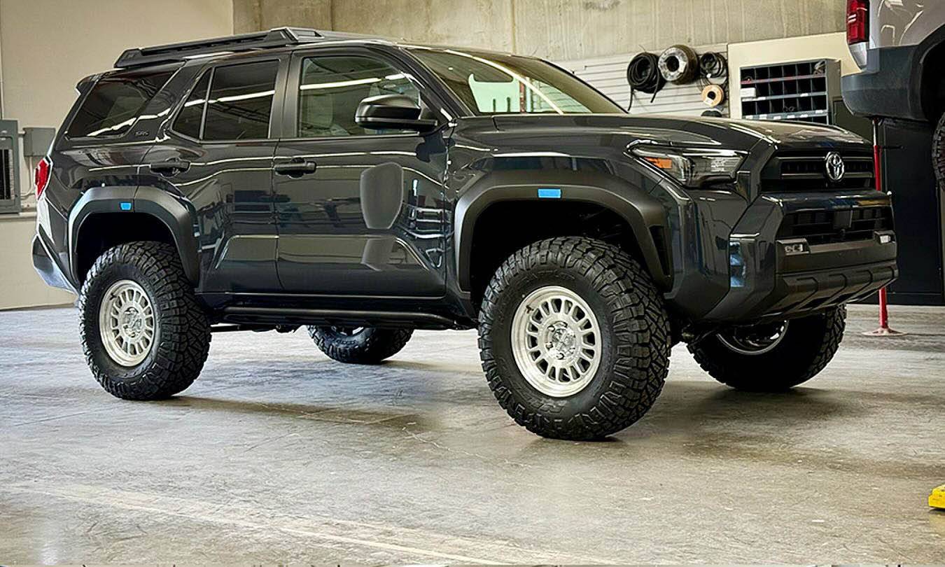

2025 4Runner build with aftermarket parts:
✅ Old Man Emu MT64 3" inch suspension kit
✅ Nitto Ridge Grapplers 35x11.50R17
✅ Method 318 Wheels 17x8 +25 offset
✅ ARB Roof Rack

Beautiful!!!! Love the lift!!!! Where can I order the old men emu from?

Nice, looks good! How are you liking the MT64's?

I understand Method wheels have a hub bore size of 106.25 while 6th gen 4runners is a bit smaller at 95.1mm. Did you use a hub centric ring or extended thread lug nuts/extended shank style lug nuts?

Looks sweet. Do you get any rubbing on the fenders?

Which kit did you get and from where? Even the arb site doesn't show any kit to fit. Curious how it rides also. Looks awesome. I'm going with the westcott kit in my TRD OR but eventually would like to upgrade to something like OME.
