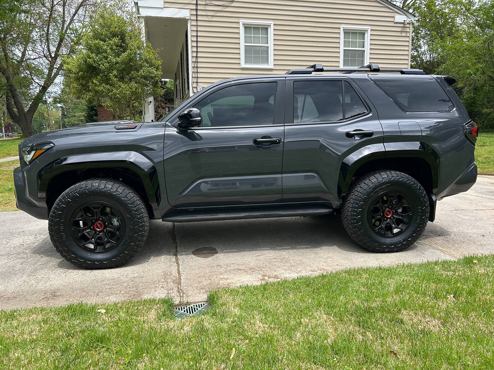

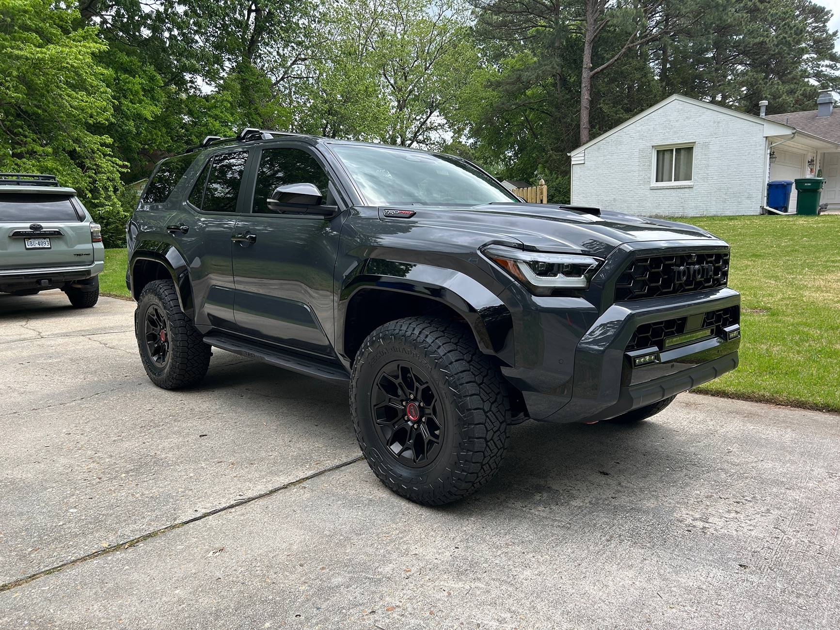

Photos are deceiving. There is a ton of clearance. The 1in lift really wasn’t nessesary.

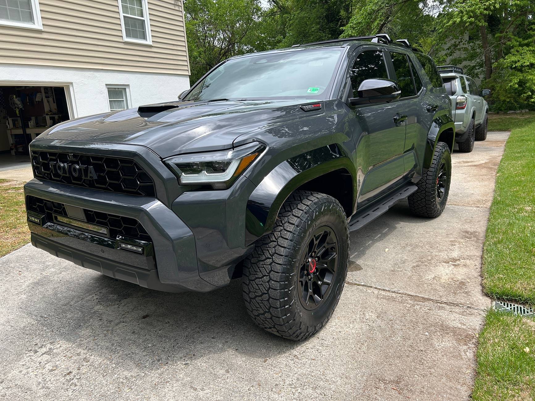

Cory have you noticed any hood shake as I had been hearing the Tacoma TRD Pro had just curious.

Oh yeah, there’s shake going on but my 5th Gen Pro’s hood shakes too.
I think it more noticeable because there’s so many more angles in the 6th gen hood

The 35's look good, fills up with wheel well nicely.
Any offroad to check for rubbing yet?

Was going today but I big storm system is rolling through :(

2025 4Runner TRD Pro in Underground with Cockpit Red Interior
-295/70R18 Nitto Recon Grapplers
-Peak Suspension 1in top shim and 1in rear spacer
-Ceramic Coating
-Screen Protech film for Infotainment
Starting suspension measurements for the Pro was:
Front - 21 3/4
Rear - 22 5/8
After small lift:
Front - 22 3/4
Rear - 23 1/2
I am in love with this truck. I still have my 21 TRD Pro but this one is next level.

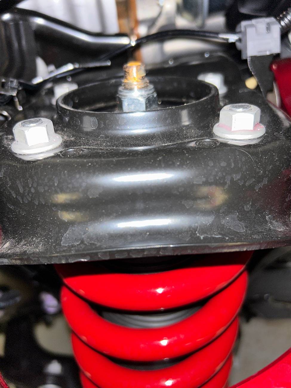

Can you take a photo of the strut bolts so I can see how many threads are there once the top spacer plate is added? I’m looking at the same setup on my SR5.

This is on a TRD Pro which has shorter bolts than the rest. A 1.25in top shim will work for yours.
