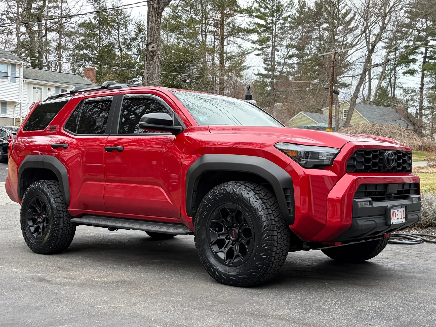

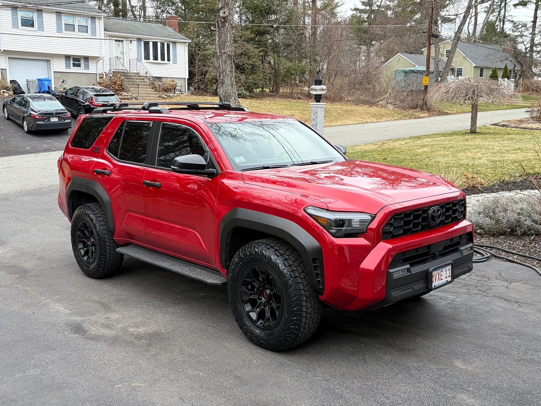

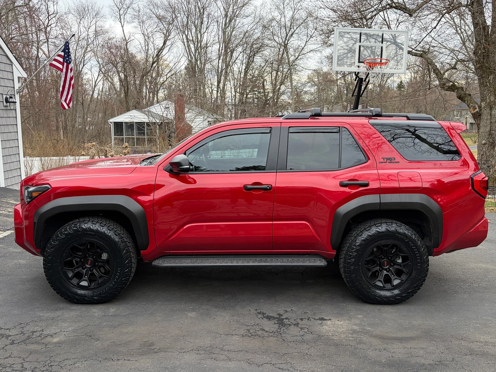

OP thanks for all the work on this post. I went with a similar setup. Same wheels and tires. 1.25 Peak lift going in next week and a .5 rear lift to maintain a little rake.

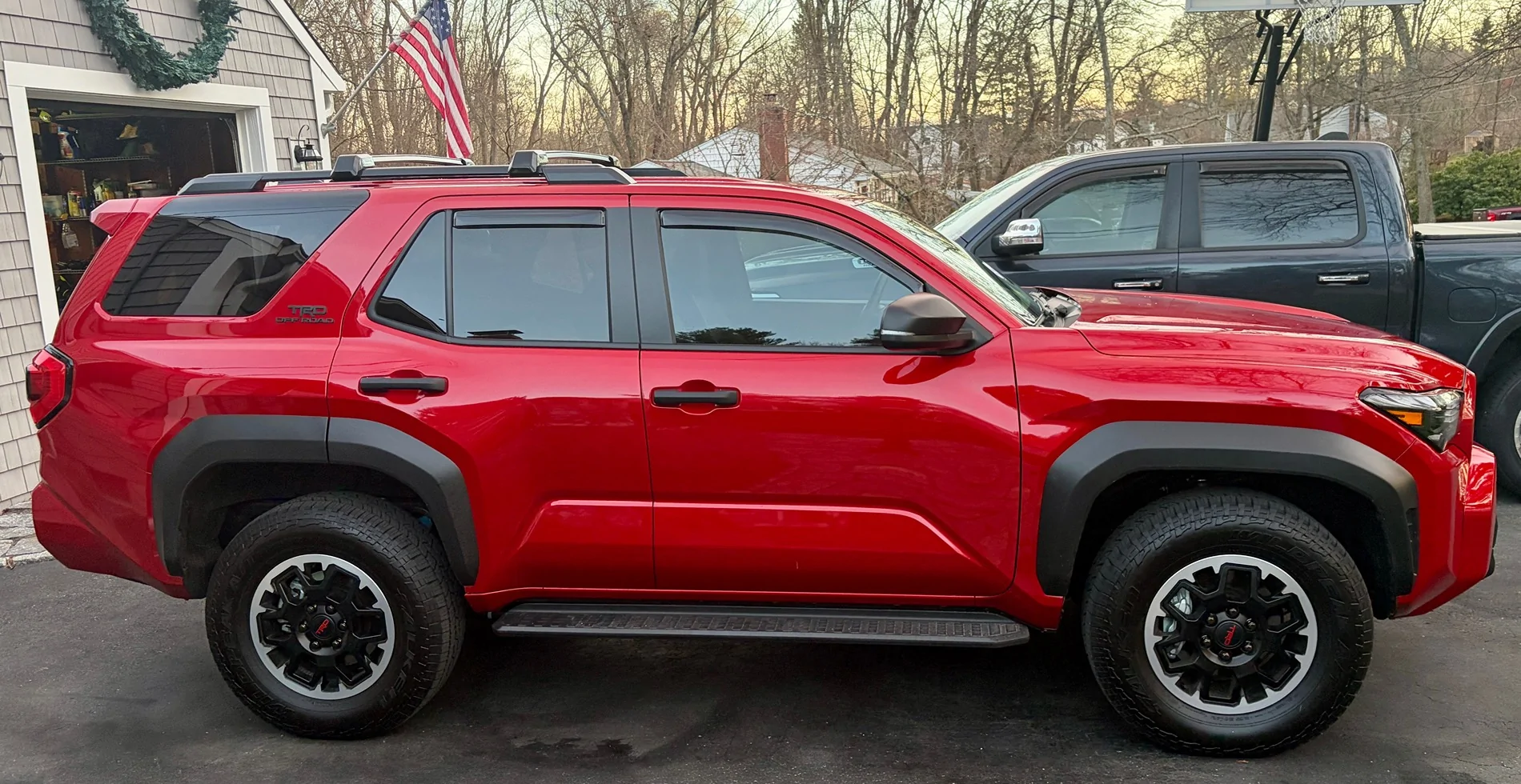

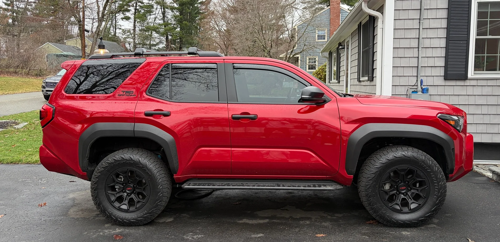

how are you liking the peak spacer? Was it a true 1.25” lift?
Peak spacer is great. Install wasn’t too bad. Fits perfectly over factory studs with just enough thread to torque the nuts down. Rides great, no problems whatsoever. A couple before and after pics.

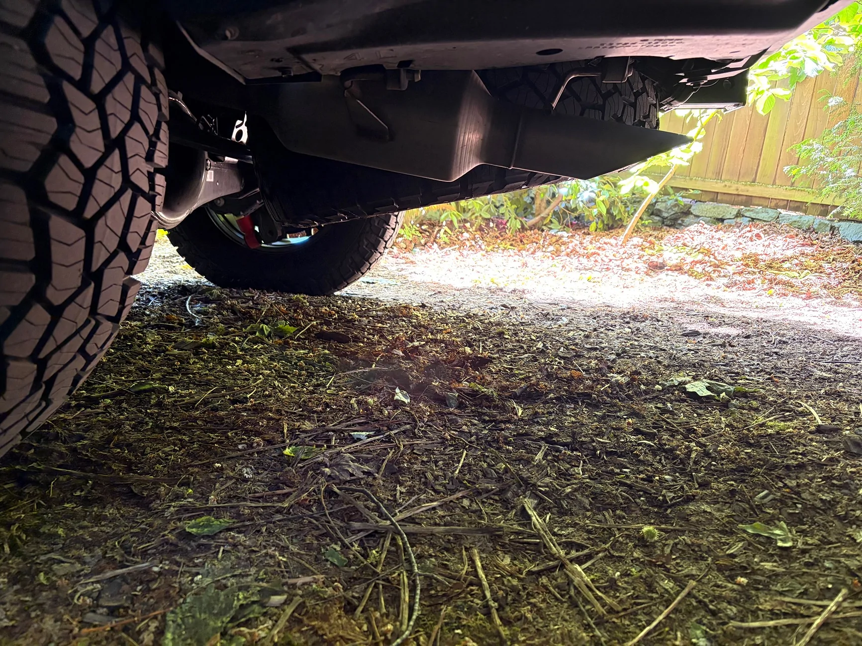

Were you able to get the spare tire up there? Just got these tires based on this post but shop said they can’t get it up there.
I just had the 18” TRD black wheels with the +45 offset, and 275/70R18 Pirelli XTM tires installed. The tire was a really tight fit in the spare location. It does fit ( barely) but hangs down a bit more than I like. I am planning on doing a bit more poking around down there to see if I can get a better fit.

Pic
