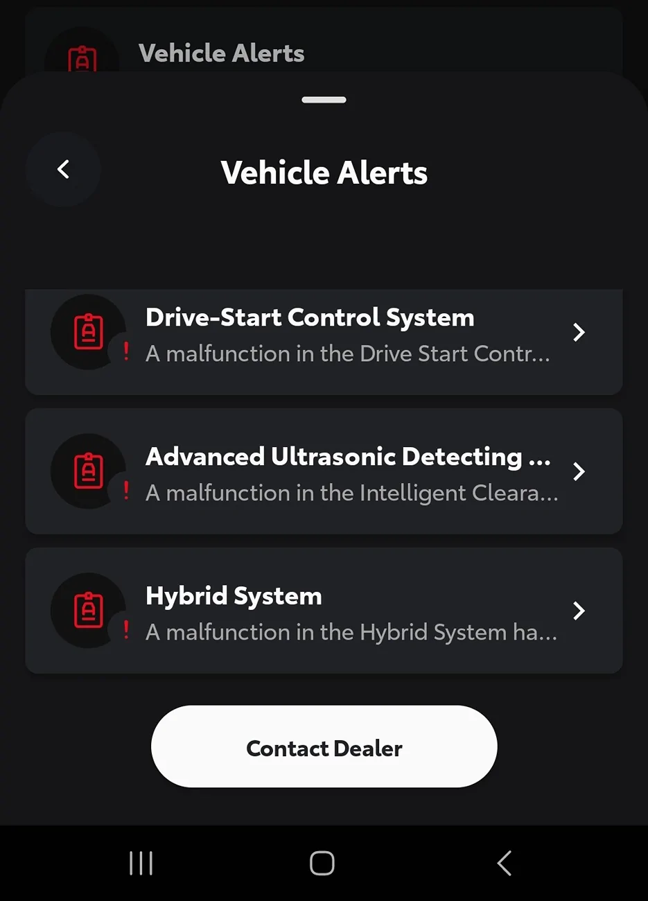

Not even 400 Miles and Getting all Types of Warnings⚠️
Grizzly
Dec 23, 2025
36
Utah
2026 TRD Pro 4 Runner
So, today I was in line at in n out and as I let off the peddle to scoot forward, my 4 Runner just started throwing all these warnings at me on the dash. I ended up driving it back. The car runs fine. I don't even have 400 Miles on the Vehicle. These hybrids man, I hope I don't have a ton of issues in the future. I thought toyota was supposed to be reliable.
If anyone has had similar issues, please let me know. Going to contact my dealership tomorrow (if their open on MLK Day) and get this puppy fixed.
Pictures Below:
2025 2026 4runner 6th gen Not even 400 Miles and Getting all Types of Warnings⚠️ Screenshot_20260118_165258_Toyota

I've had minor issues with new rides that trigger check engine lights or other things to flash on the dash that were one off minor glitches so I hope this is the case for you and all is well.

My non hybrid had a couple hours of warnings for the front camera/sonar then went away and never came back. Similar stack of warnings.

I had the similar problem at around 400 miles. They had to keep it overnight to contact Toyota, and it turned out the transmission was low on fluid out of the factory. No problems since.
I mention this because the dealer was initially baffled and there is no low transmission warning light. Worth a check

I took my non hybrid on road trip when it had less than 1000 mi. I was very careful to vary speeds and not accelerate too fast. About 4 hours into a 7 hour drive I started getting all sorts of engine and transmission warnings. Stopped the truck turned it off and turned on warnings were gone. 1/2 hr later they started again. Got an appt at a dealership where I was going. Great mechanic took me into his work bay. He cleared the codes and said it was safe to drive. Said if they came up again to take it to my home dealership. They never came up again. I have about 3k on it now and it drives like a champ.

I had similar issue at 700 miles. It was air fuel sensor bad. They ordered it and replaced it. After thst I had no use so far. Right now at 5700 miles.

I've checked the connections. Everything seems to be fine. The warnings keep coming up. I don't understand why. I have a service appointment for tomorrow. I will keep you guys posted as to what goes on...

Did you do any electrical mods to it that connect to the battery, or fuse panel?

I haven't touched anything, nor have I modded anything. The car has been in the body shop for the last week because some Dipshit hit my 4Runner with a cart at the store or while it was parked somewhere. Had to get it repainted....

Update! I got the car back the same day I took it to Toyota. When I had the body work done, they did not calibrate the front grill properl,y which ended up throwing all those alerts!
Everything is running great! Keep you guys posted along the way!
