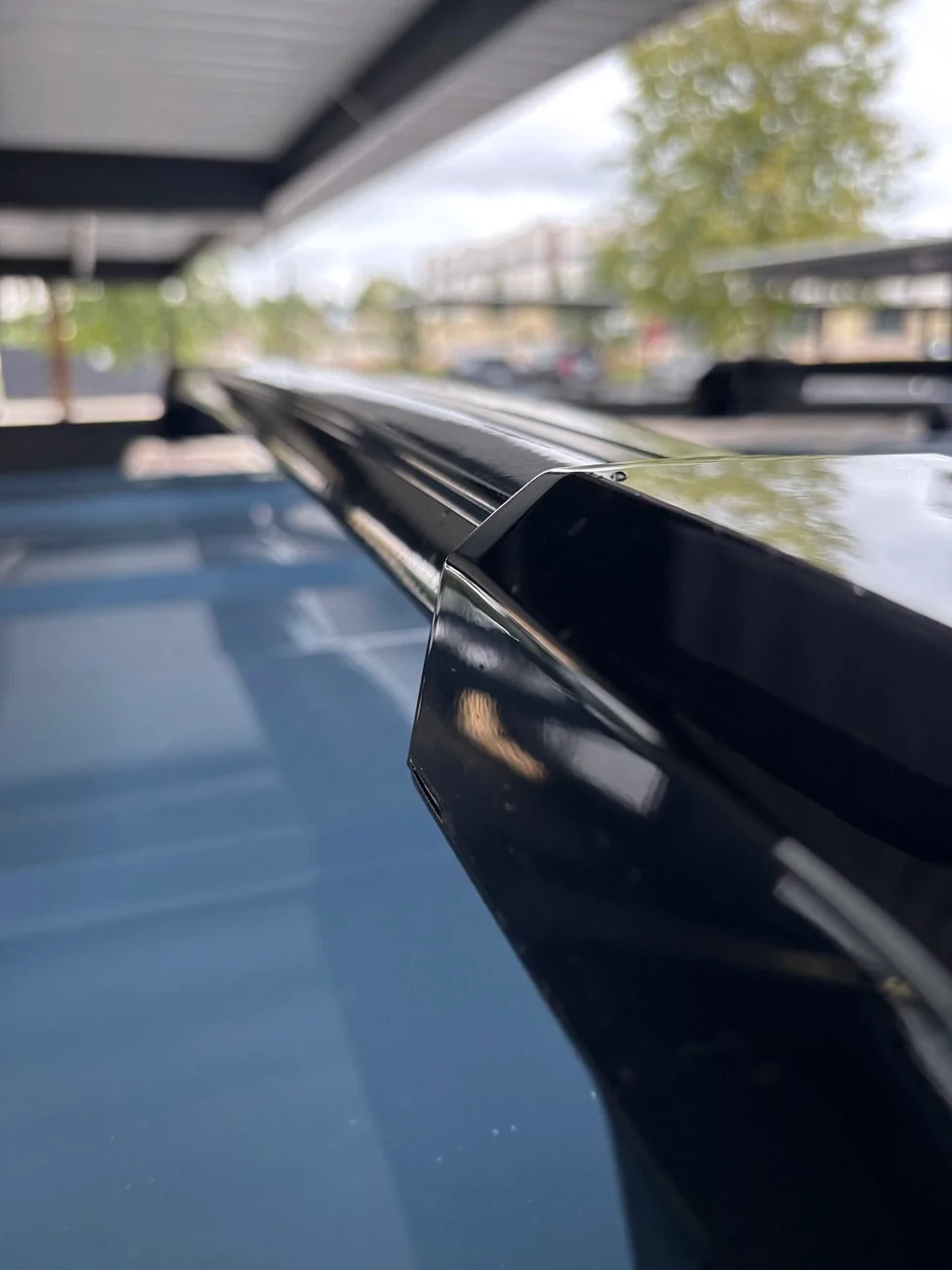

The crossbars have one side that is smooth and round. The other is more angled and has a “lip” or spoiler at the top. Wind noise went down for me when I faced this spoiler or lip side towards the front of the car. I took mine on a quick drive to test it out. I did think that this way was quieter, although not as quiet as it was before having anything on there, but I figured that should be expected.

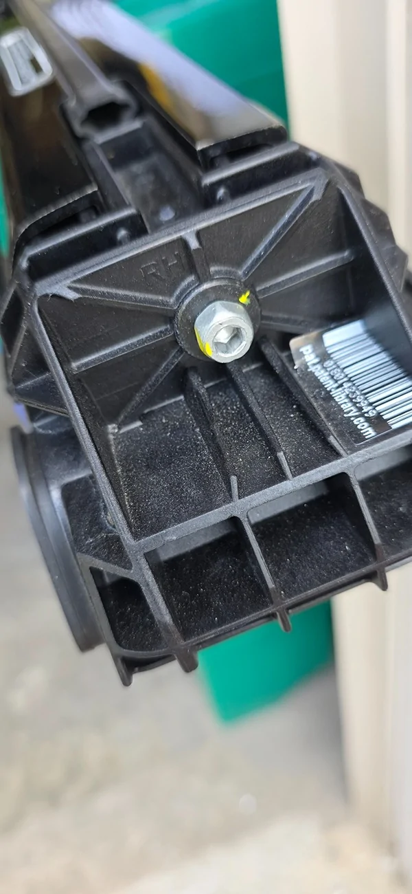

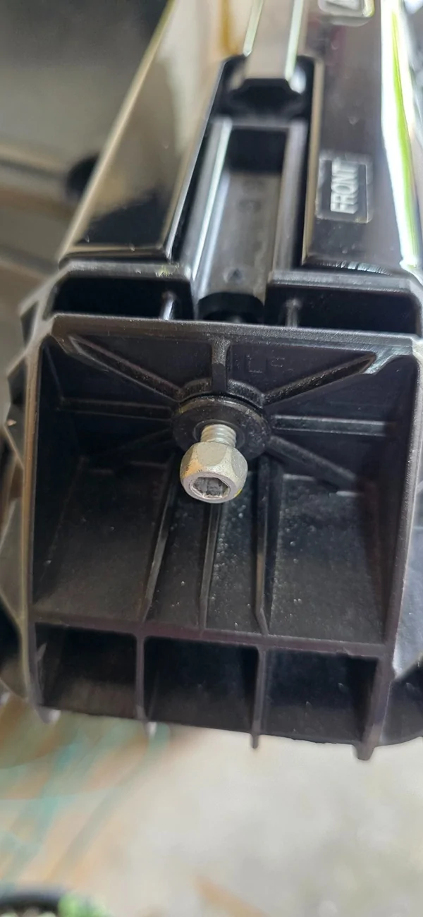

Just to resurrect an old thread and maybe this helps someone but the cross bars are also labeled left and right underneath the covers.
Damn. I read this thread back when it first appeared but assumed I MUST have done it right - I had the instructions and everything. But I never actually checked until today.... rear installed correctly; front backwards. WTF Mike. Confirmed with Coldwiz check. Took about 3 minutes to correct. So other than feeling like an idiot, felt like I accomplished something quickly. (And might remove and only install when I need them now that I realize how quick it can be done.)

Glad that helped @MikeD ! I leave mine off most of the time but was putting them on yesterday and started doubting how I had been installing them lol. The covers are also labeled too so you don't get those mixed up either. Not sure if it matters..
