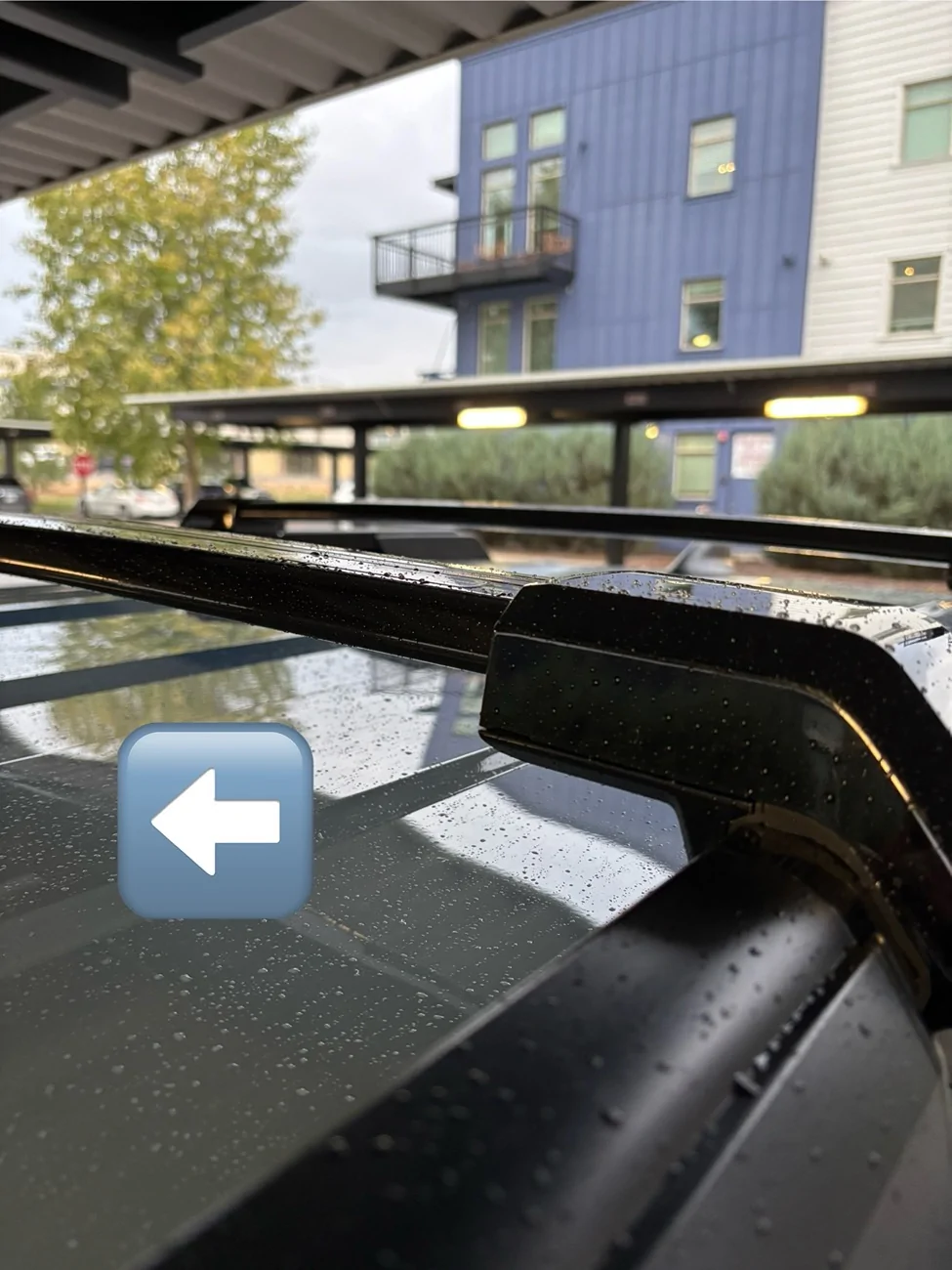

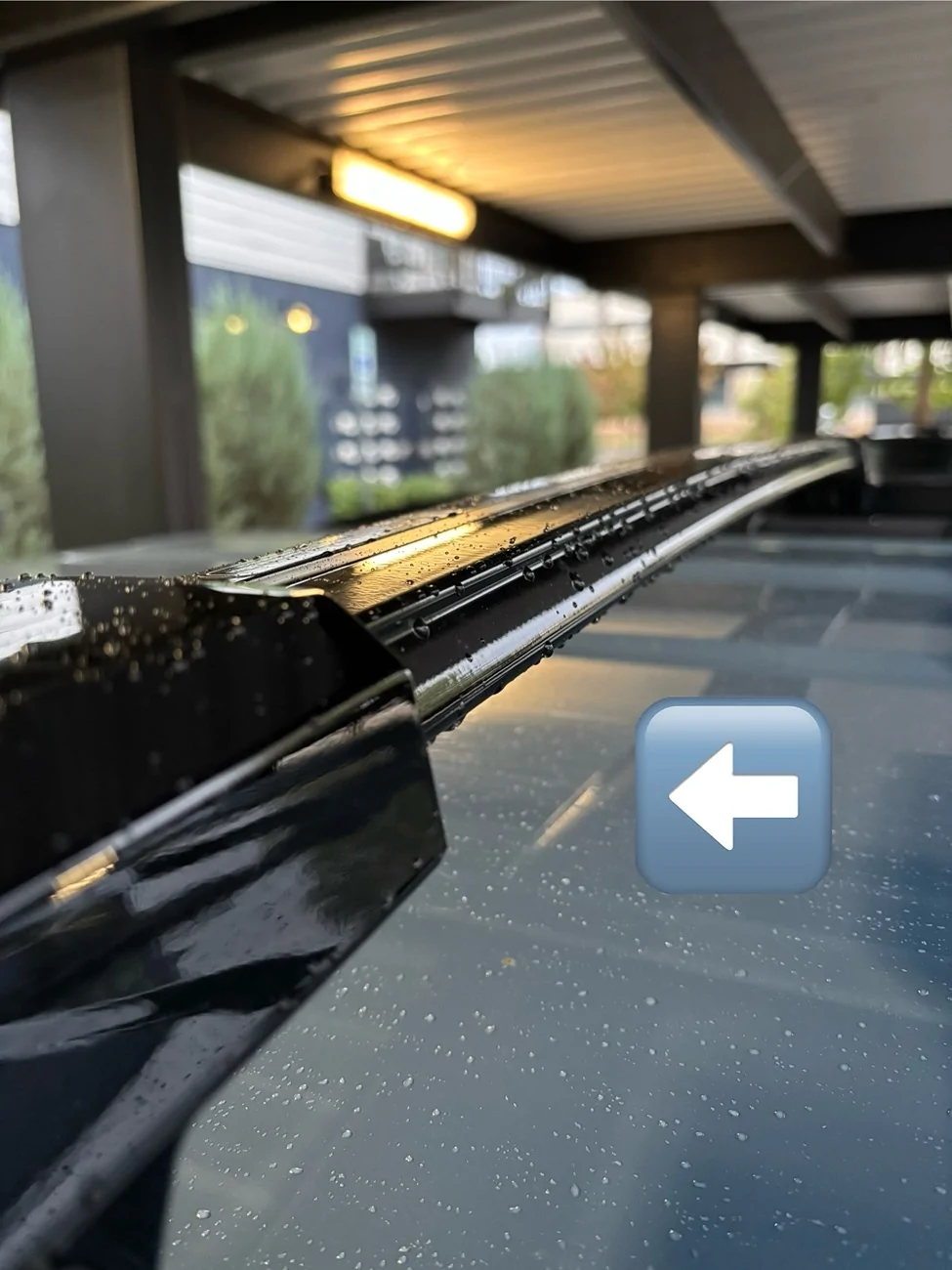

I just ordered some cross bars from Toyota and had them shipped to my house. Installed them this weekend and immediately noticed how loud they are. I mean they are really loud. Anything over 55mph and they become noticeable and I don’t even have a moonroof. My previous vehicle was a Subaru crosstrek and it had crossbars and a moonroof and I never noticed the noise if nothing was tied to them.
[UPDATE: I was wrong! Put the lip of the crossbars facing front for minimal wind noise!]
I installed them the way I thought made the most sense. I placed the most rounded face of the crossbars pointing towards the front of the vehicle. The back section has a lip which I would assume resembles a spoiler of sorts.
This is the correct way to install them right? The instructions were not super clear, besides placing the one labeled FRONT in the front position.
Does anyone else think these things are super loud?

I think you have them installed correctly. I have had them on since day one (dealership installed). I definitely notice the wind noise at higher speeds. Been debating whether it's worth keeping them (just for the looks)...or to take them off bc they're so noisy.

Good to know. Man that sucks though. These are not good at all.

Mine came from the dealer with the lip to the FRONT and I don’t notice any obvious wind noise, even with a sunroof.

Interesting. Seems unintuitive to have them that way but I’ll likely try them this way too and see if I notice a difference!

I just rotated the crossbars to have the lip facing the front. I'll report back once I drive on the highway and let y'all know if there was any improvement.

Wow. That made a HUGE difference. Lip pointing to the front is definitely the correct way for wind noise. While there is still some noise around 70ish it's nowhere near as bad. If wind noise is a problem, I'd highly recommend checking the orientation of the lip. Thanks to @Tarekith for the suggestion.
