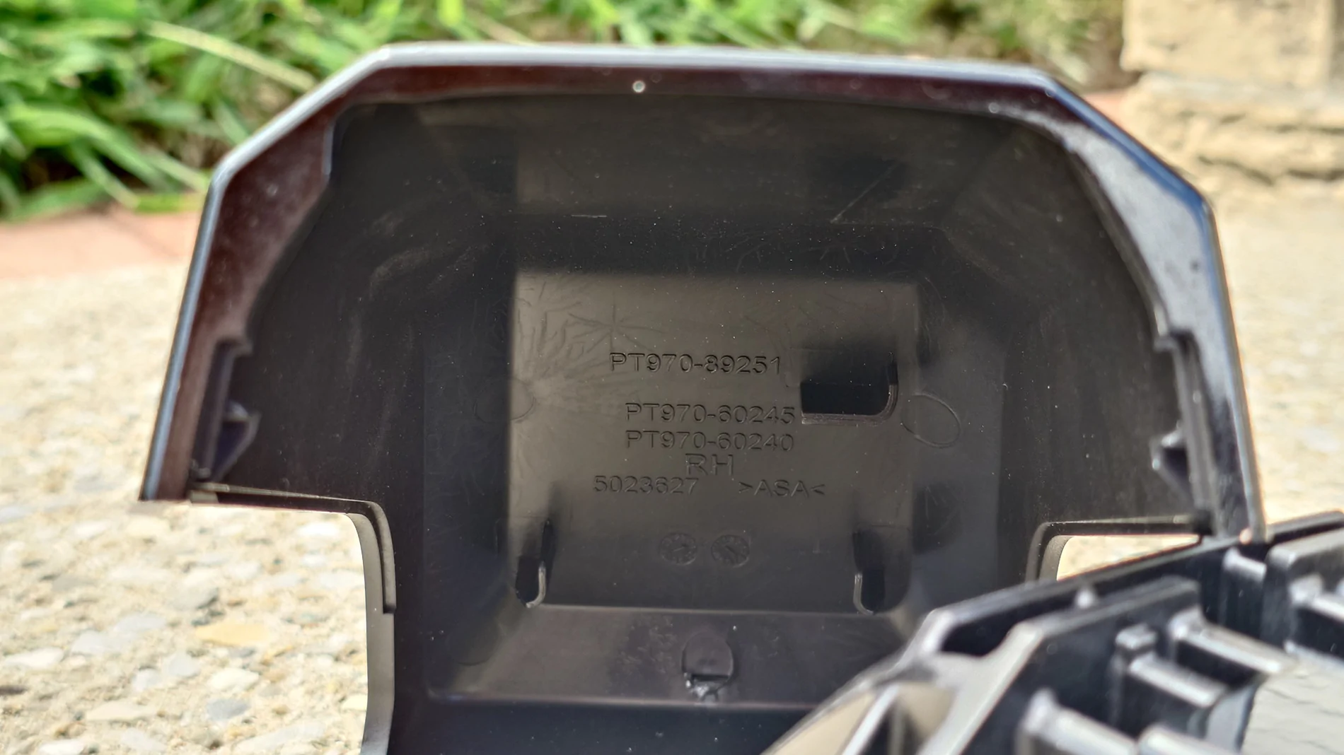

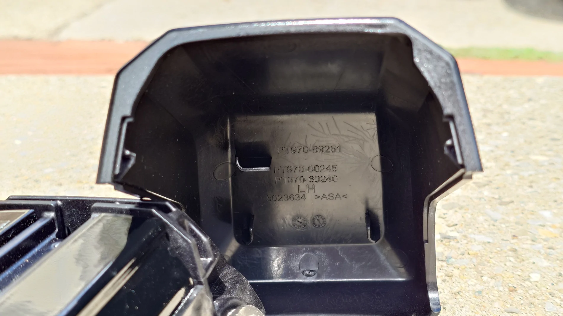

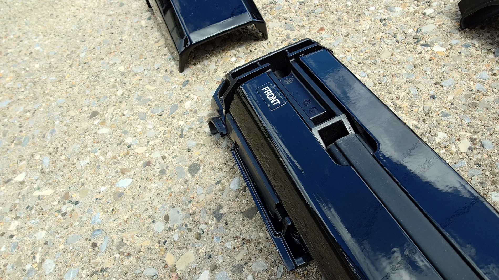

Now I have to go look again... did I say this all backwards???
it does look like the word front is on the side with the lip!
.... ok no I said it right the first time. The front is definitely the sharp side without the extra lip on top.
It just looks like a lip in some pics because of the way stuff in the background reflects on the glossy paint.
The end cap covers are directional too, they have a cutout shape that is different on one side to fit the lip. The end cap covers are labelled RH and LH inside and confusingly LH is the passenger side, so it's relative to facing the truck rather than riding in it.

So I did come across that sticker when I took the covers off to adjust the spacing. They're installed with the "Front" sticker facing the front, but it still doesn't make sense to me that the side with the less aerodynamic "lip" would somehow be the front.
The front sticker is not on the side with the lip.
It is upside down if you are facing forward like if you were riding in the vehicle which is confusing. But the LH / RH labels for the end caps are also "backwards" the same way. You have to be facing the front of the truck rather than riding in it for LH to be on the left (passenger side), and if you are facing the truck like that, the the word front is right-side up and is facing you and facing the front of the truck. So that's consistent.
Regardless of which way up the writing is, the sticker itself is clearly on one side, and so you just make that side the front, and that is the smooth side not the lip side.

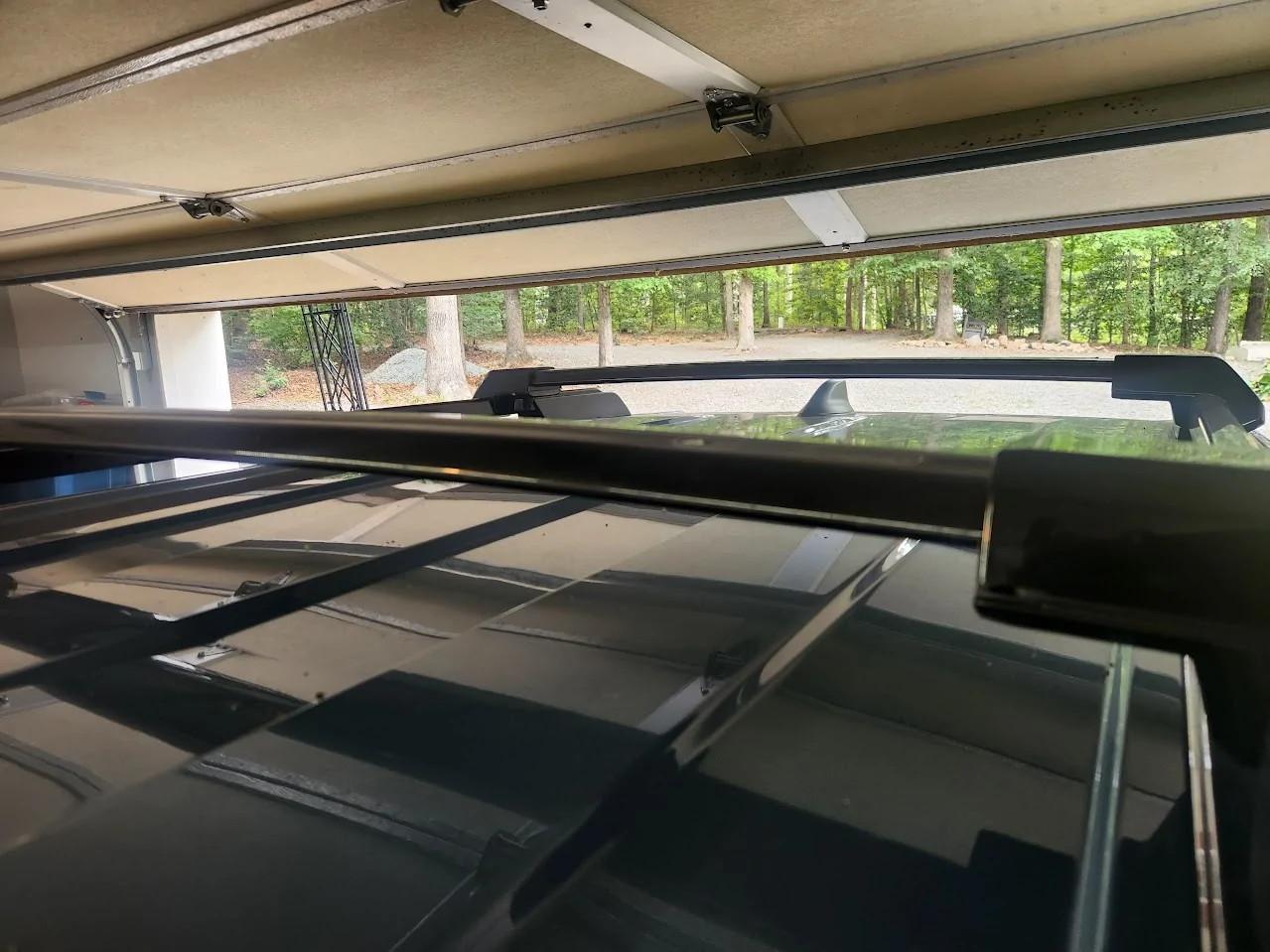

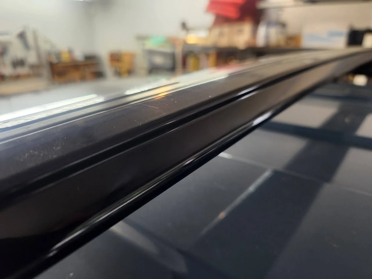

The beveled/smooth/rounded sides on the ones I installed face front on the front rail and rear on the back rail - with the notch/lip sides facing each other. I recall being a bit confused when I installed them but it all made sense in the end. Wish I had the instructions to share but apparently I only had the hard copy that came with them and that is not available to me right now. (I don't think the allen wrench that came with the bars is very critical - its a standard size wrench (5 mm?) with a funky torque indicator that I was not clear how to use. I made things tight but not too tight. Note that I lost one of the 4 cross-bar end covers so make sure that they are snapped on tight. Replacements only sold in as all 4 together. $35 lesson.
