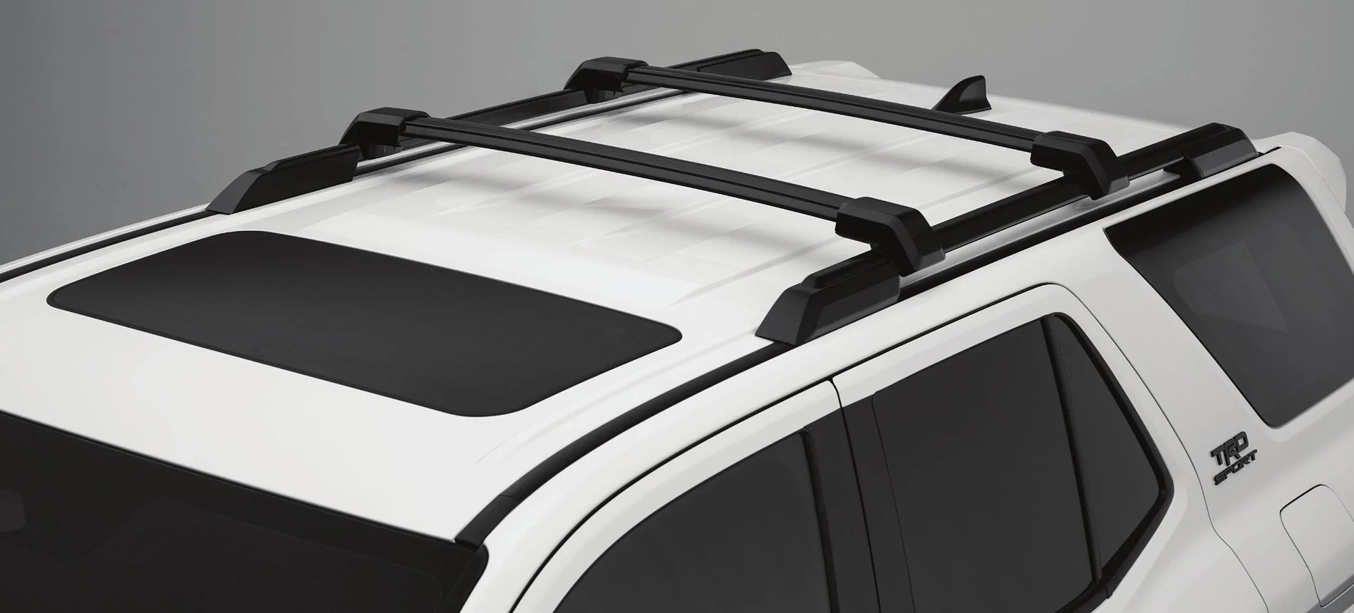

There is a pretty clear looking picture in this brochure pdf
https://www.toyota.com/content/dam/...essories/MY25_4Runner_Accessory_Ebrochure.pdf
It sure looks like the lip is in the front on both bars, and thatr IS the way mine came pre-installed from the dealer. I thought it was backwards but now this pdf adds weight to the lip-forward theory.
This is kind of ridiculous!
They make the part directional instead of symmetrical, and then give only ambiguous and contradicory hints as to which direction is which.
Just make the damned things symmetrical so it doesn't matter, or put a damned arrow somewhere. They have a word "FRONT", but it's written in a place and a direction that makes it essentially useless (as far as I can tell now, the way Iinterpret it might be exactly backwards from what they intended). Similarly, they have parts marked LH and RH but do not say which side is the right or left side! There is no "right" or "left" side of a vehicle since you could be looking at any side of the vehicle. That is why ships have "port" and "starbord", and cars have "driver" & "passenger" instead.

We're all a bunch of 4Runner enthusiasts and still can't figure out which way they go, so no one is going to be looking at our cross bars and saying, "That dumbass has his cross bars on backwards." My vote would be for both lips facing forward.
Holy crap - you are correct about the brochure photos. Sure looks like notches to the front...
OTOH - I don't really hear any significant noise that seems to be coming from the bars - even with the moonroof open.
But now I have to find those instructions and check WTH I was thinking when I installed.
Concur on ridiculous. :>)

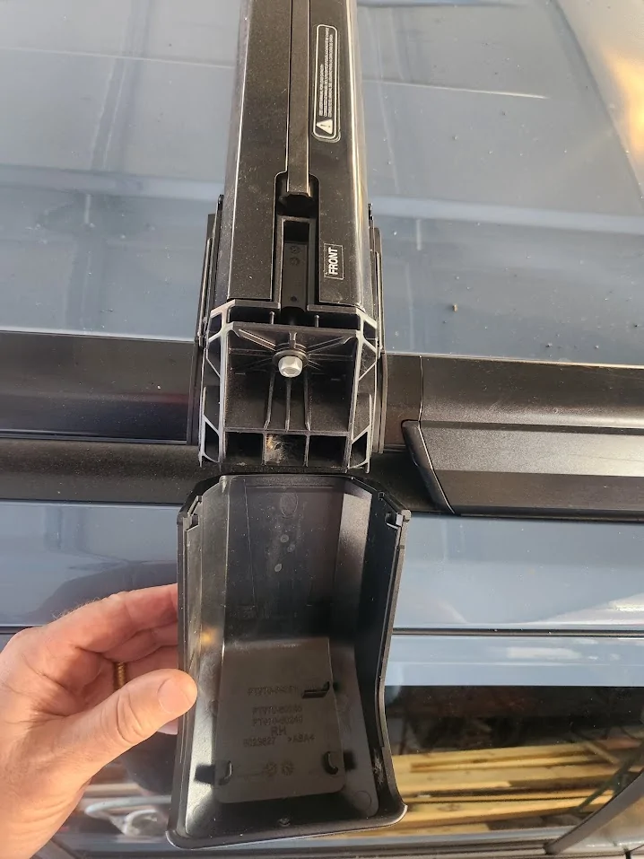

FWIW: I popped off the passenger side front cover to find this "front" label that I clearly thought meant that (beveled/lipless) edge went to the front. And the cover has the RH inside - which made sense to me as being the passenger side.
So I continue to think that what I did makes sense ... but the rear covers did not want to easily pop off so I'm giving up for now and going to assume it doesn't really matter. :>)
(POSSIBLE evidence against my installation is that the load warning stickers face the opposite way on the two bars - front bar the warning would be rad from the front (facing the rear of the vehicle). Opposite for the load warning stickers on the back rail. Honestly I'm not sure this is conclusive of anything..)

Kinda late to this party, but can confirm that lip should face front and smooth side facing rear. When I realized that smooth sides were facing rear from dealer, I thought they put it backwards, so moved it around and....dang, obvious wind noise! Put it back with lips facing front and no noise.
