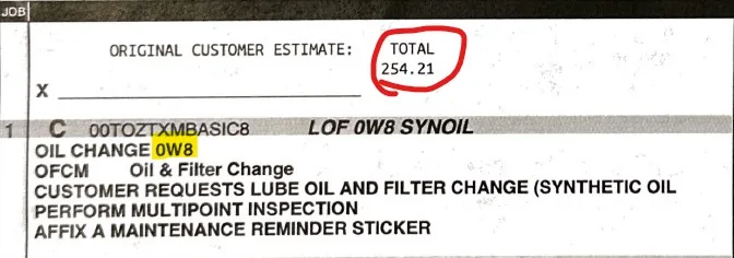

Haven’t hit my break in oil change yet, but I noticed buying a 6qt pack of 0w-20 from my dealership in GA is $35 vs $70 for the 0w-8 (and that is discounted as an online pickup order, retail price is $96). So just in the oil alone you’d probably save a chunk if they used the correct one (not $150 worth but some). I’d take it back on that alone because the 0w-8 is going to have a lot lower high temp viscosity and if you’re doing any long trips or mountain roads in socal/other western states I would be worried about the temp.
I believe that 0W8 is for a Prius and hybrids. Small
Motors.
You’re right the 0w-8 is typically for Toyota’s super-fuel-efficient engines but wanted to add: we have the hybrid engine and it also specs 0w-20 so should be the same oil hybrid or not when it comes to the 4Runner.

Took my TRD ORP for break-in oil change at my cost at Toyota Walnut Creek in California. Was shell shocked at the cost $254.21. Apparently they now use a 0W8 oil at $21/quart for 6 quarts and $103 for labor plus filter cost. This seems crazy expensive. What are others paying for oil change and filter?

I went to my local dealer at 1,200 and paid $95 for oil, filter and labor. You got ripped off for sure. I would not only tell the Service Manager but also the General Manager, the Owner and Toyota.

I was able to renegotiate below $100 and they put in the correct 0-20w oil. However, very concerned about the integrity of the dealership of where I purchased the 4Runner.

You are (unfortunately) being hit by California tax and gouging.
One month ago, I got everything I needed from a Toyota dealer:
Oil Filter - Part Number: 90915-YZZN1
0W20 Oil - 6 quarts - Part Number: 00279-0WQTE-6S
5 x Oil Drain Plug Gaskets - Part Number: 90430-12031
Including tax - less than $50
