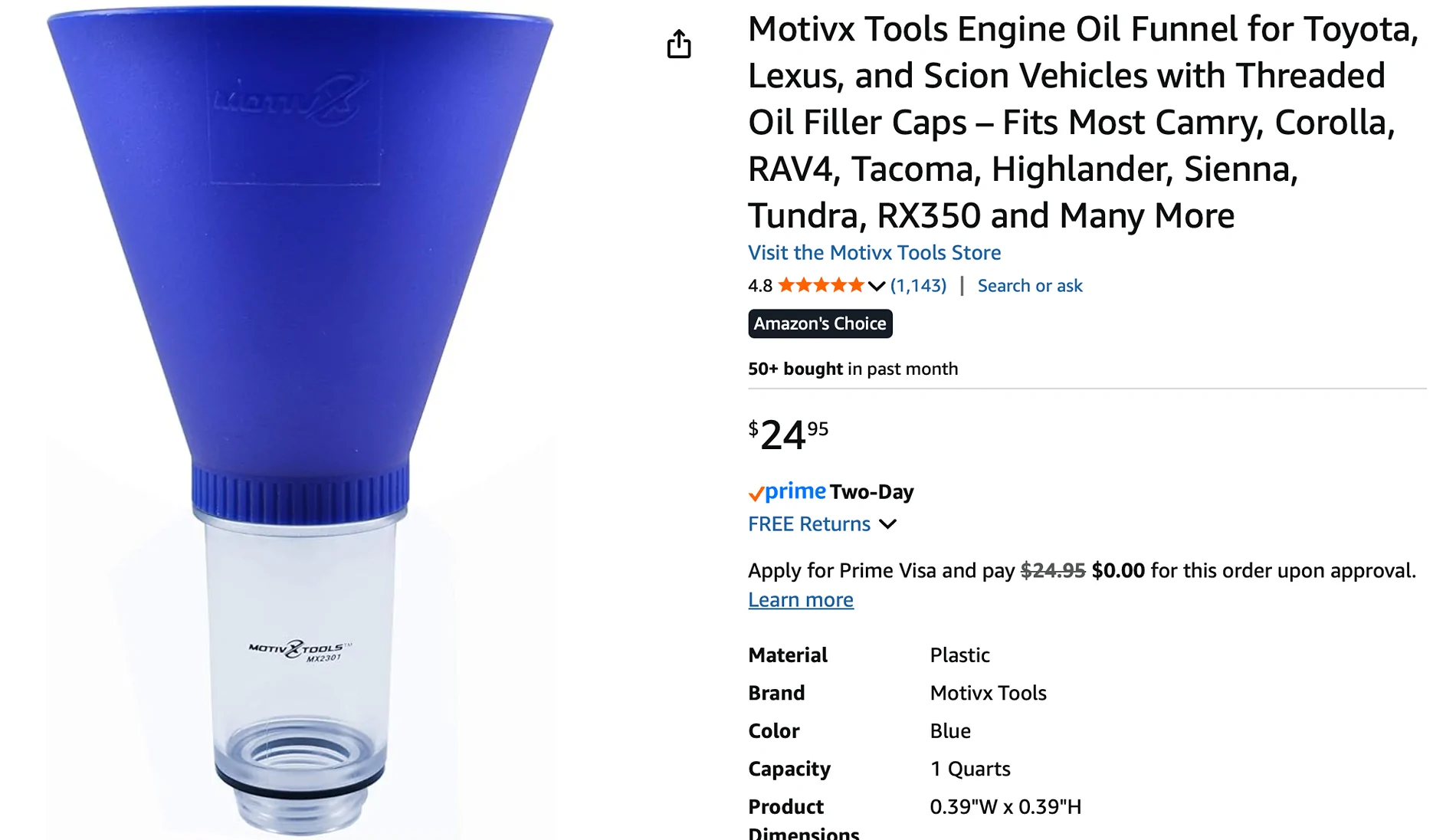

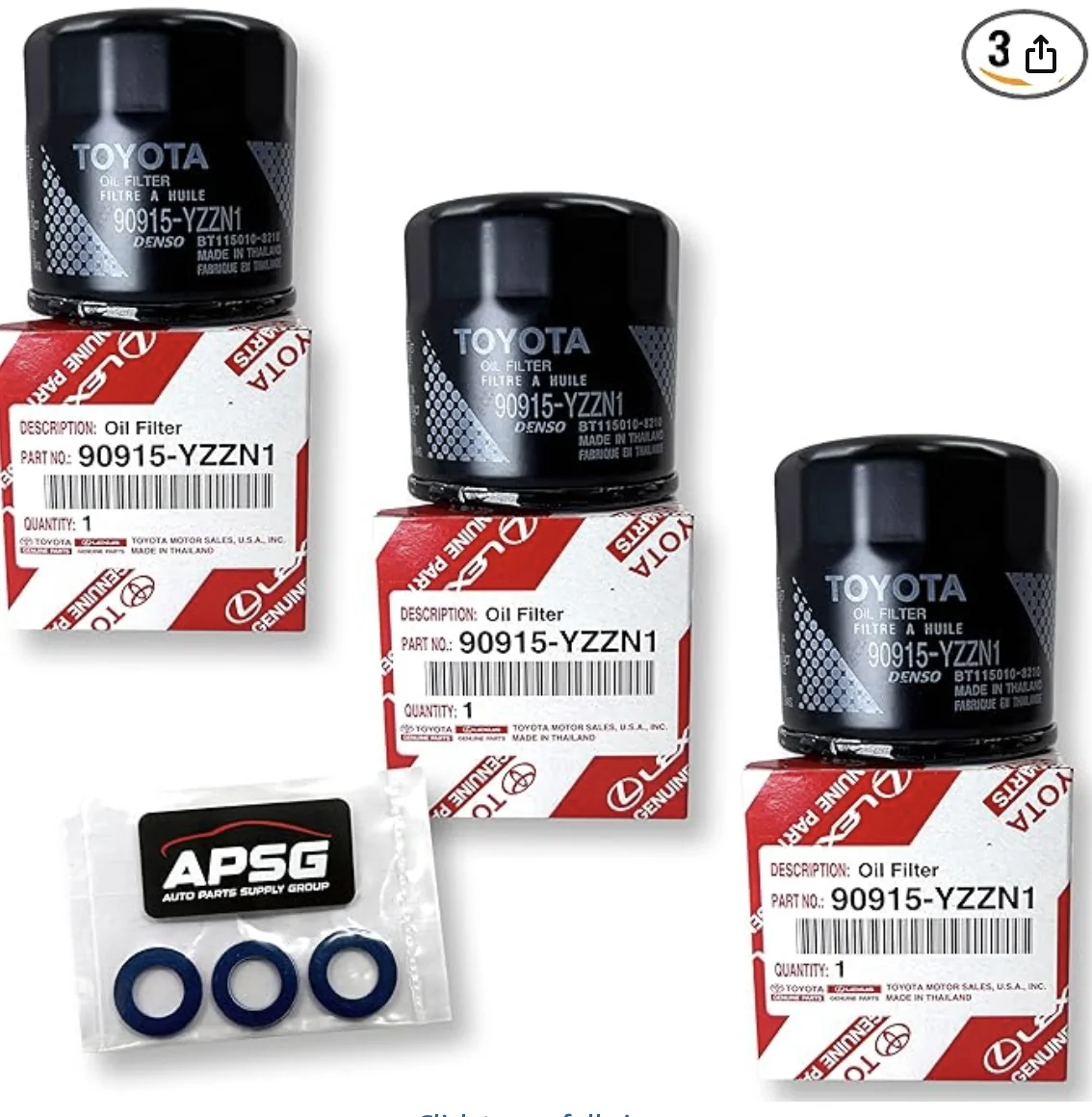

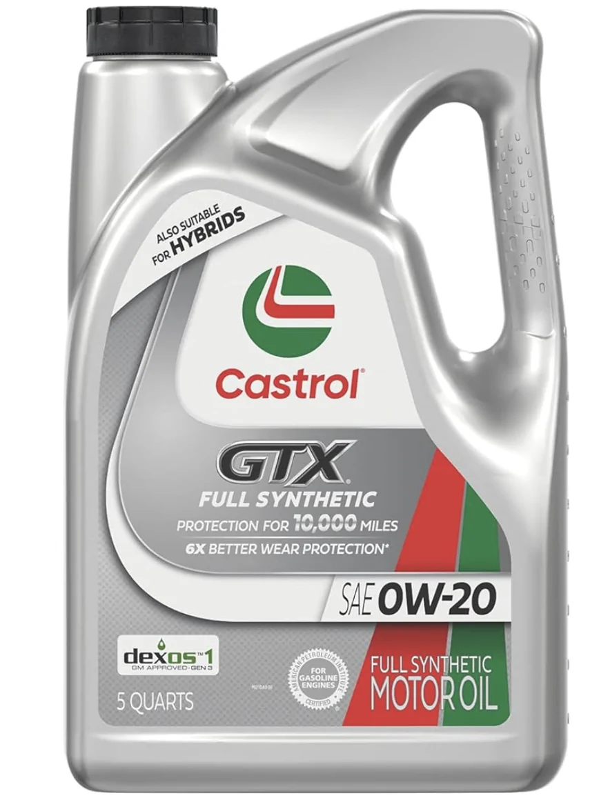

I'm old too and I've got bad knees and hip, but I managed to change to oil yesterday at 3333 miles. I just took it slow, steady and careful (on my body). I went on a 2525 miles road trip last week and was not able to get the oil changed at 735 miles before we left. I am 6'2" 260lbs and had plenty of room to get underneath to get the skid plates off (12mm socket). I did take the front goatee front grill air foil thing off (10mm socket) the day before which makes it easy to get to everything from the front. Toyota puts their oil filter on too tight at the factory. My oil filter socket tool kept slipping, so I had to use a wrench to get the factory filter off. They don't need to be that tight. Used Toyota oil filter (90915-YZZN1) w/ new crush washer and Castrol GTX Full Synthetic 0W-20, both from Amazon. I got a funnel that fits Toyota fill caps which made filling easier. Toyota made it nice with that little spout they put in under the oil filter. I tried to put exactly 5.9 quarts with an extra quart bottle added to the 5 quart jug. The skid plates are easy to take off and put back on.
