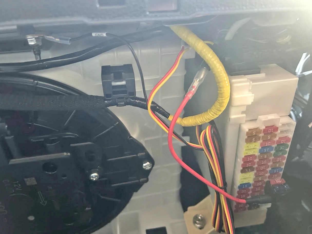

Im sorry I dont remember or have pics to look back on. But you can use any bolt which goes to the chassis as long as its not bolting down something plastic as plastic will not conduct.
but you were able to find a bolt in that passenger side compartment? ive breifly looked but couldnt seem to find any bolts in there that werent just for plastic. Just wanted to make sure before i start taking apart other peices to search for more
Yes. There are no wire harness ground points close to there but there are a couple spots I believe that the dash frame or metal bracket is attached to body in that area.
are you still looking for a ground bolt on the passenger foot well? I can show the bolt i used there
EDIT - thank you i actually found one this morning though by taking off the trim to the right of the glove box

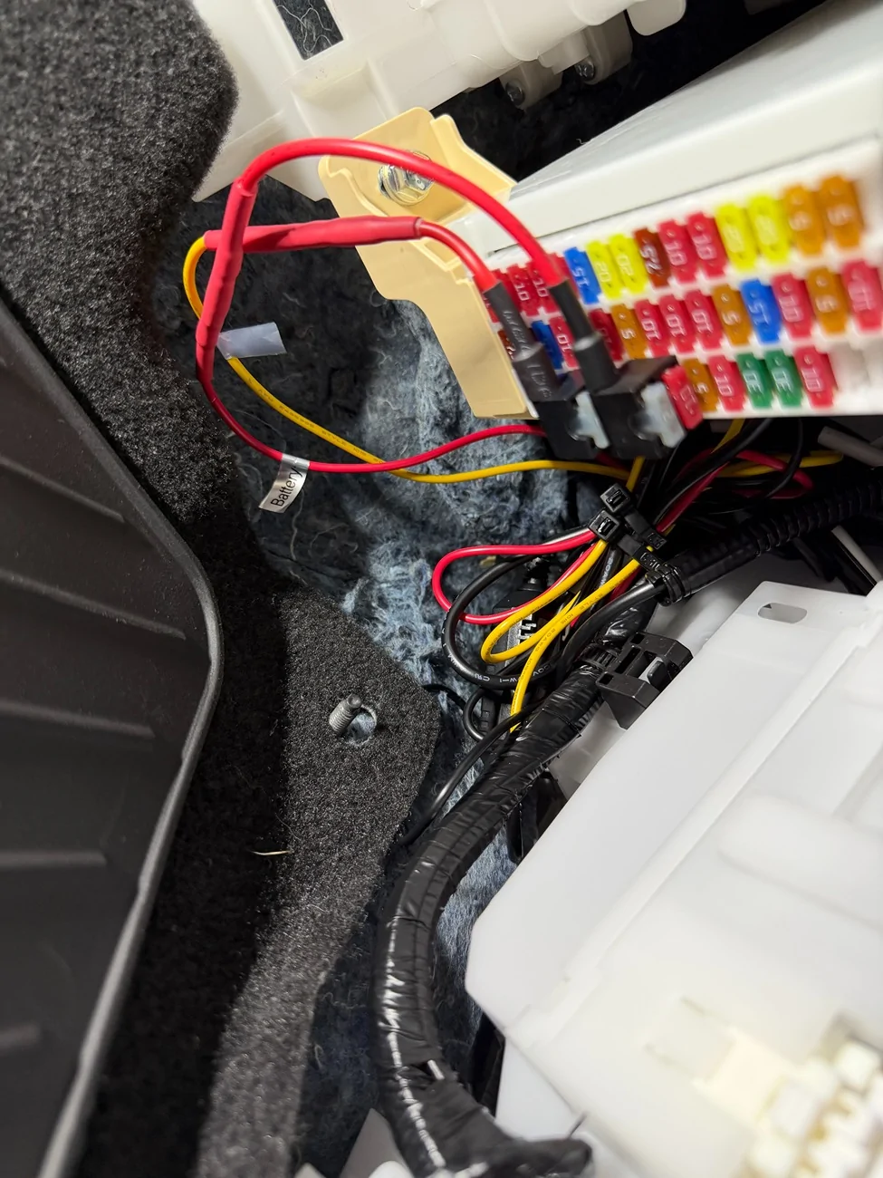

Hi sorry I didnt get back in time to respond. This is where i grounded my dash cam under the passenger foot area
Where does the red wire go? The one that is attached to the yellow.
One is connected to your fuse box, the other I can see where it goes.
Is that going into the engine bay and onto your battery?
The dash cam i have is the Wolfbox Tripro.
So it comes with 3 wires: ACC power , Always on, and ground.
I only want ACC power so i connected that to the fuse box and the ground to a stud that connects to power. The wire for always on is not connected and tucked away.
