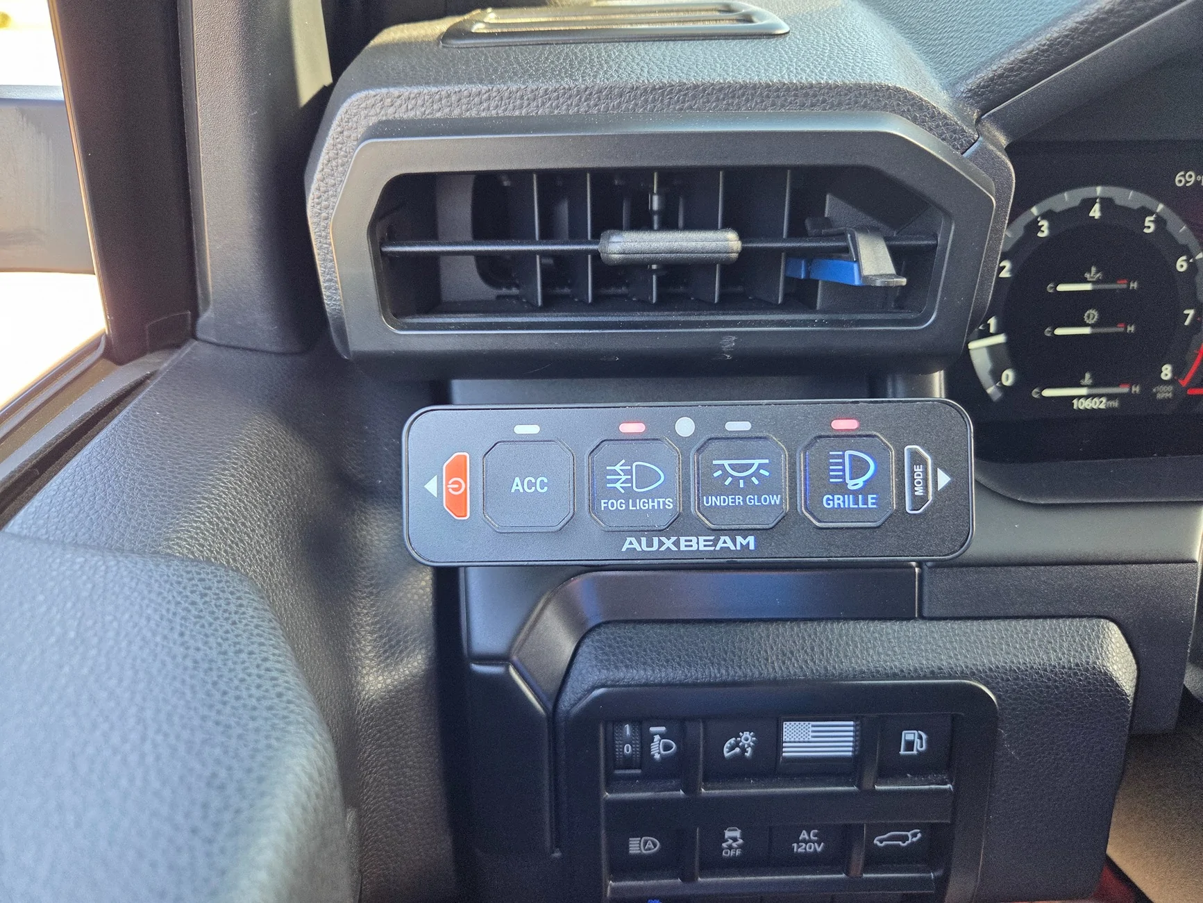

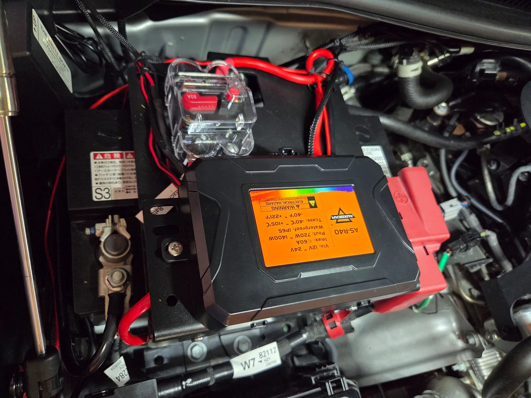

Plus it never hurts to add a little silicone where the wire exits. Thanks for adding the link I couldn't find it. I eliminated my add a fuses by adding an Auxbeam AS-R40 RGB switch panel. Cleaned up all wiring. Mounted it on a Yota Xpedition over battery mounting bracket. Nice and clean.
