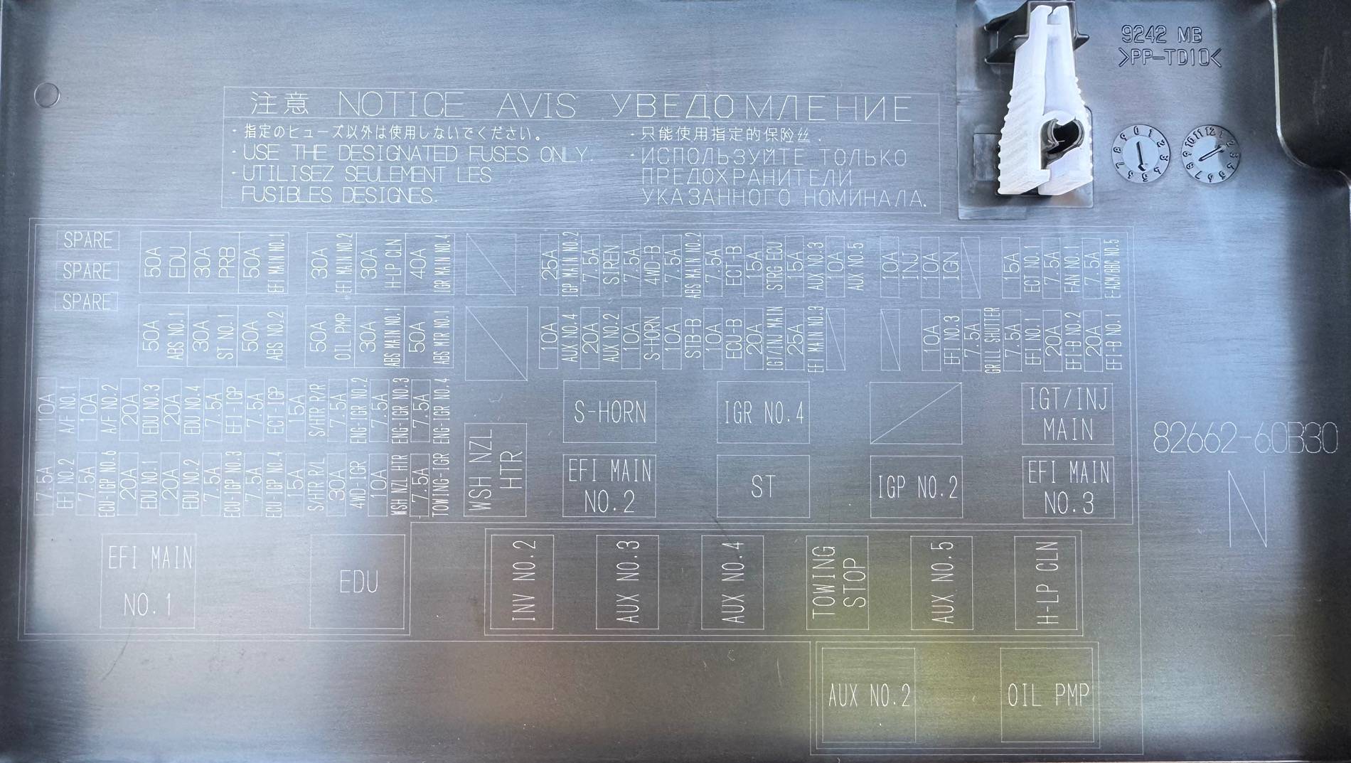

Was hoping someone could take a photo of their fuse box, driver side.
My fuse box cover is blank with no diagram. The passenger side fuse box cover has a diagram on it.
I made the mistake of not taking photo before messing with a few fuses while trying to install my raptor lights and forgot where one or two go.
A photo of the fuse box would be greatly appreciated!

Thank you! I wonder why my fuse cover didn’t have the diagram on it.
Anyways, I corrected my hiccup and successfully got the raptor lights wired.

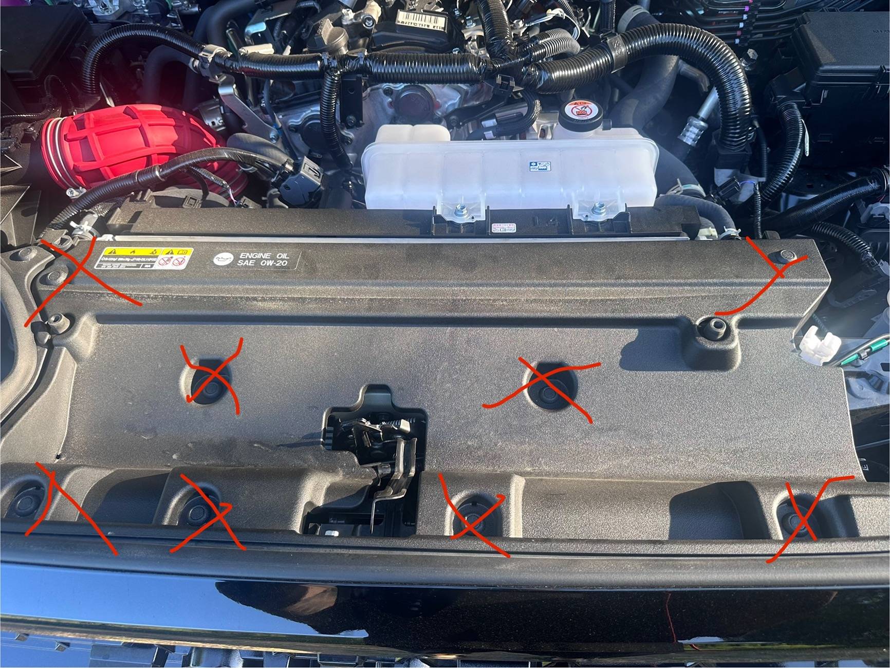

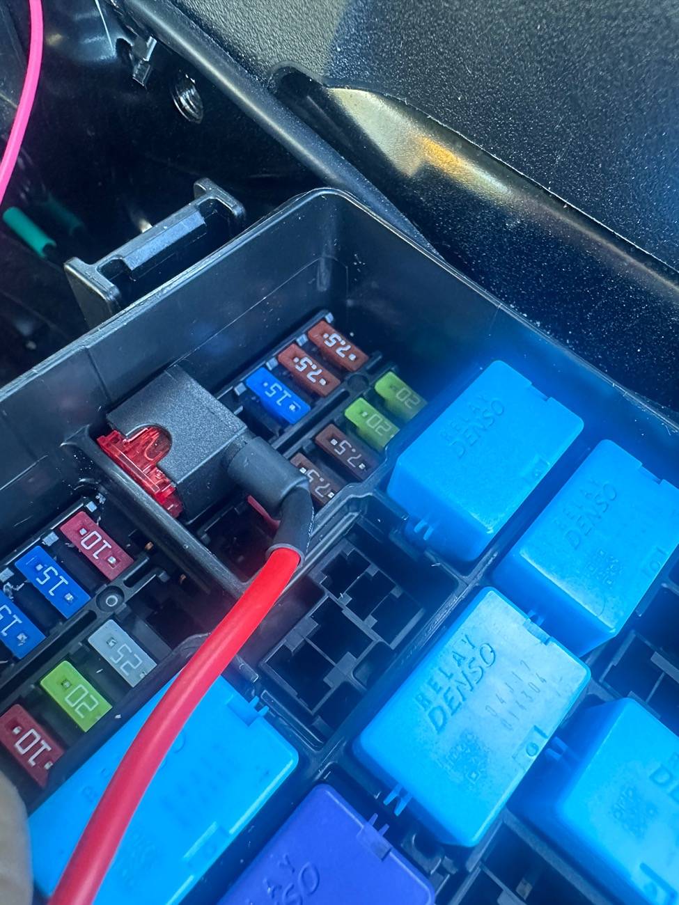

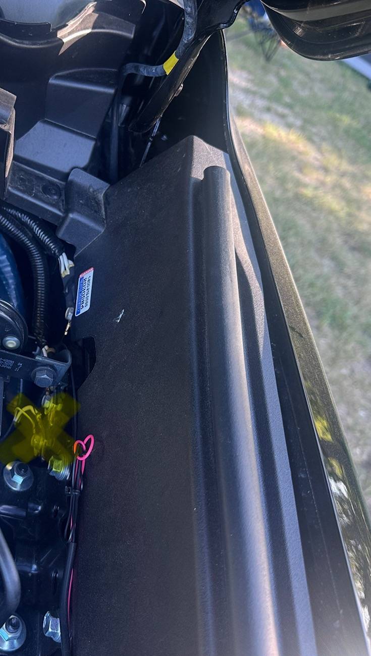

I’m sure there are better ways to doing this but I’m learning along the way.
Take off the plastic guard (not sure the actual name) by pushing where I have marked.
Mount the lights - I personally think 4 looks better than the three ive seen on others, but to each their own.
Find a route back to the fuse box and zip tie the wires along the way.
Find a spot to ground the ground wire
I connected the fuse with the IGA so the turn on with the car.
