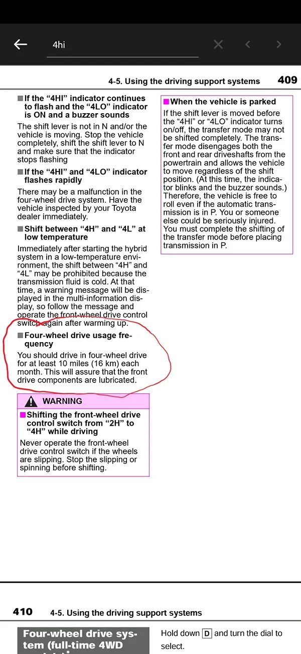

Good addition to what Nodak pulled from the manual is Toyota recommends driving in 4HI for at least 10 miles each month to keep the gearbox lubed and functioning properly.
Is that in the manual?
i was under the impression that putting in 4hi for a few hundred yards once a month is enough to exercise the servo motors that activate the mechanical stuff. They are likely to cease up with non-use.
when you say “gearbox”, do you mean transfer case?
would like to see this referenced in the manual.
Thanks
Thanks
Yes, transfer case.
