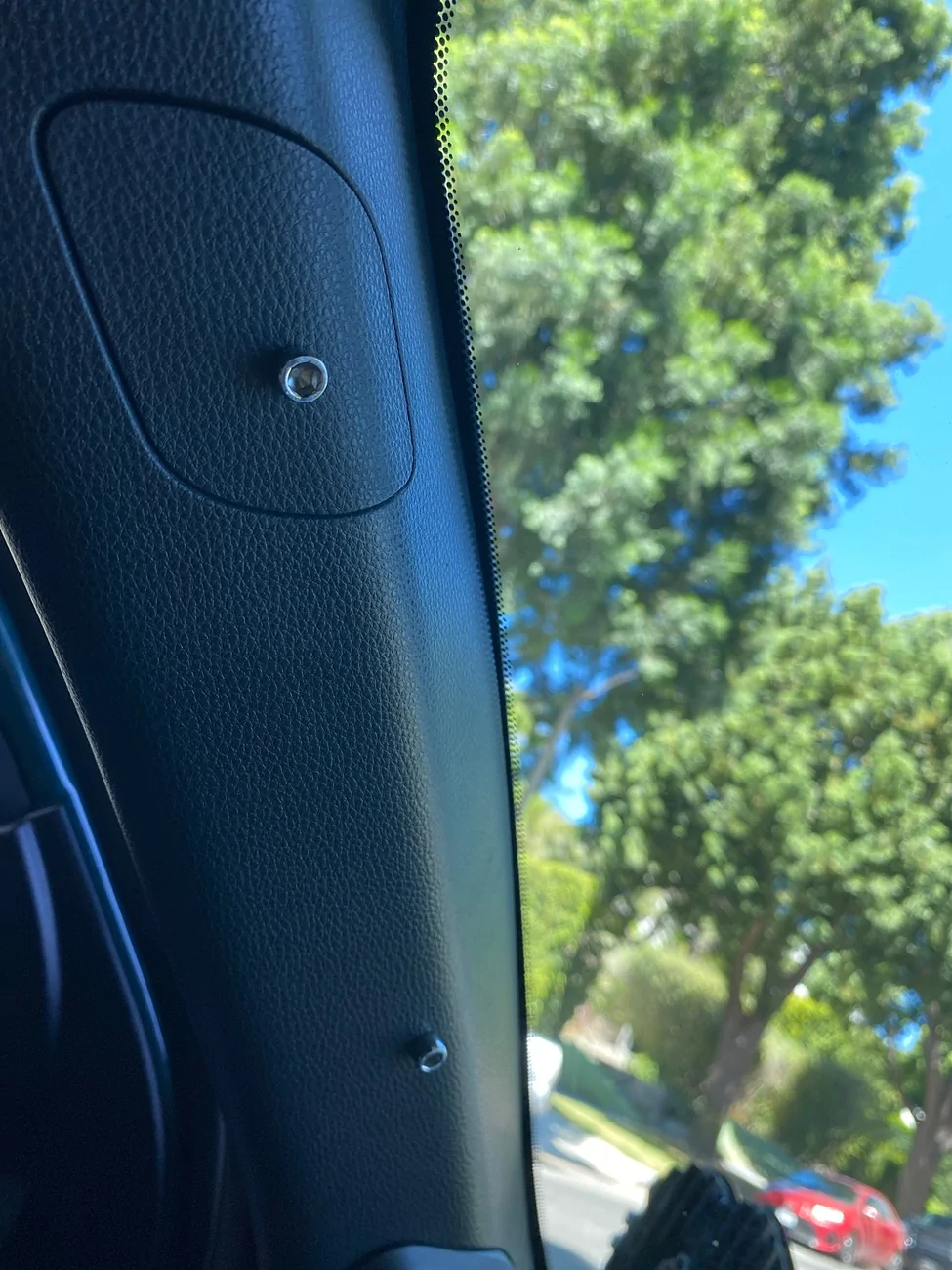

There is mounting point for it. The top hole is already threat with M6 bolt. The second hole (bottom) you will need to purchase an M6 U clip bolt nut for it. I figured out and re-engineered that A pillar yesterday. I am waiting for my handle bar comes in and install it. You will need 2 small spacers and longer M6 bolt in order to make it perfect.
Two small spacers will help the long bolt to stay in place solid. These spacers will go under and behind the plastic trim.
You will need to drill two holes on that plastic trim (of course one you took it off from the car lol).
I am an perfectionist and I was able to figure out how to make it looks functional, solid and as close to OEM looks as possible without getting raped by Lexland product for 168 bucks plus tax with a copy and paste designed that still doesn't do anything.
Any as for airbag interference. No my method will not interference with the air bag. If you open your A pillar you will see the direct arrow of where the airbag deploys if it deploys. The direction is along the driver's side window not in front and across the windshield.
The distance between the two holes from one center to the other center is approximately 7.25 inches.
I will post pics after my handle comes in and install. It is solid. I tested it out already. In fact with my method you are now have unlimited options of what kind of grab handle bar you want to have as long as spacing between them from center of each hole is 7.25 inches plus few mm.

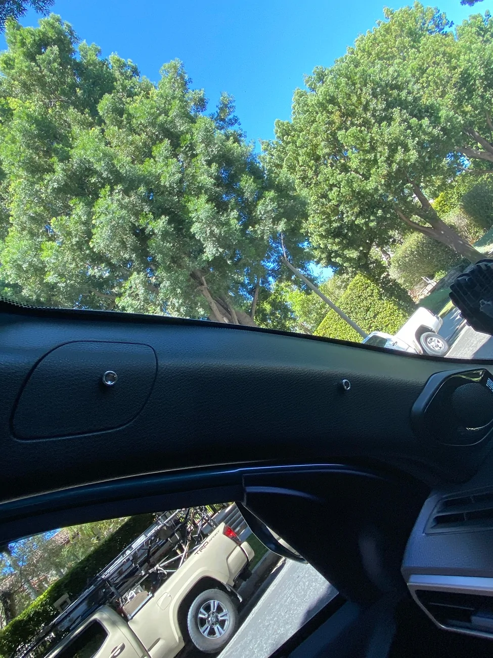

After a long research and planning out I was able to install a grab handle bar on that A pillar driver side. Yes install directly into the A pillar metal frame pre existing holes, not the plastic A pillar trim. It won't interfere with your airbag at all. If you open the plastic pillar trim you will see the direction of the airbag WILL deploy just in case and it deploys along the driver side glass window. Not in front of the windshield.
I will post some pics once I am done with it. I am waiting for my handle at the moment. I already did the hard part. Located and prep a solid mounting point directly into the A pillar metal frame.

Here it is. Two solid anchor points to the A pillar frame, not the a pillar plastic trim. Now the possibility is endless. It doesn’t interfere with airbag deploys what so ever. Of course the process to make this is a solid anchor points will required drilling of the plastic trim and spacers under the plastic trim.
