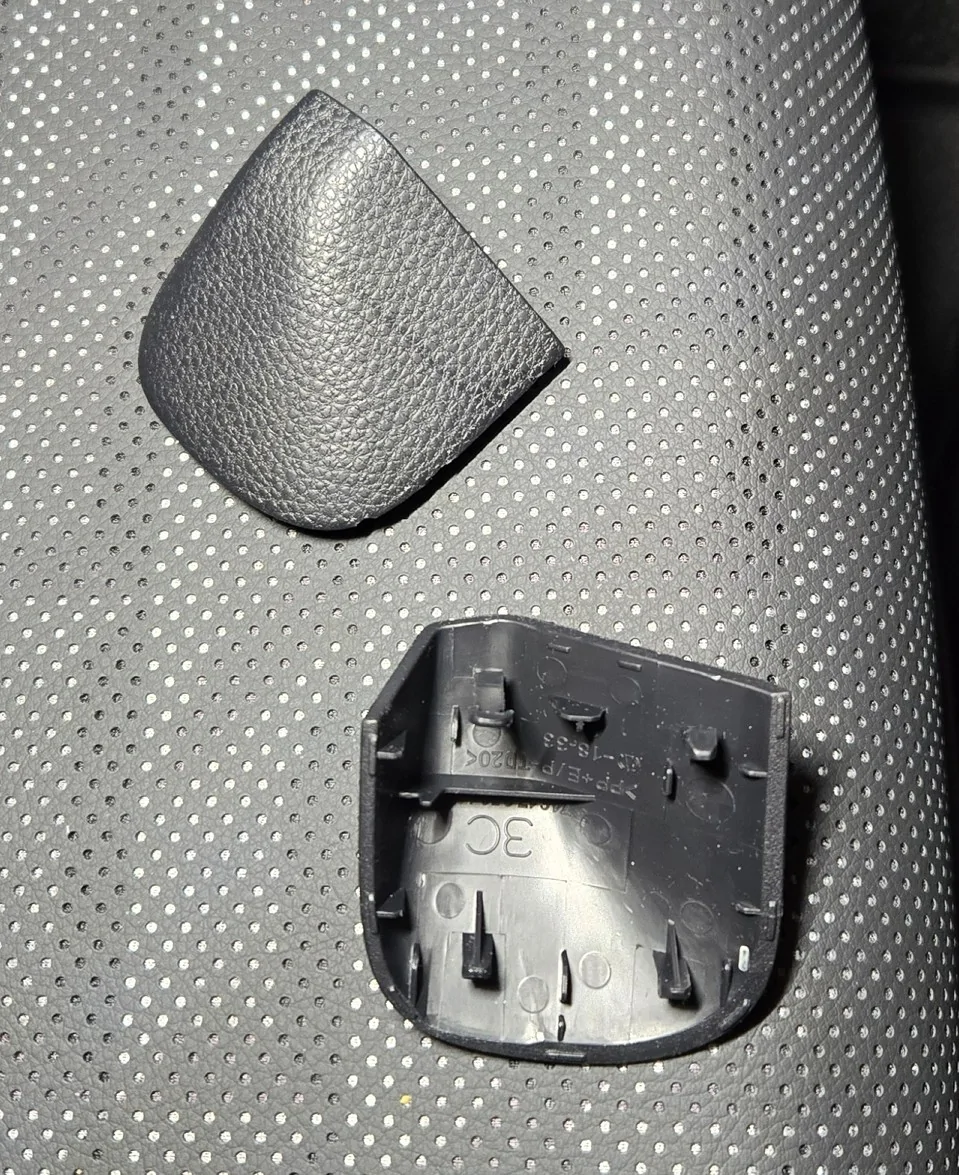

Installed a while ago using original fasteners. My wife steps up onto our ORP OEM running board with her right foot while lifting with both hands around the handle, then swings in onto the seat. She loves it. Especially since we just added a 2"/1" lift.
I have not yet modified the plastic cover caps (3rd pic). Not sure if they can be purchased separately if I want to put it back to original someday.
2025 2026 4runner 6th gen Passenger Grab Handle mod Passenger Grab Handle 1
2025 2026 4runner 6th gen Passenger Grab Handle mod Passenger Grab Handle 2
2025 2026 4runner 6th gen Passenger Grab Handle mod Passenger Grab Handle 3

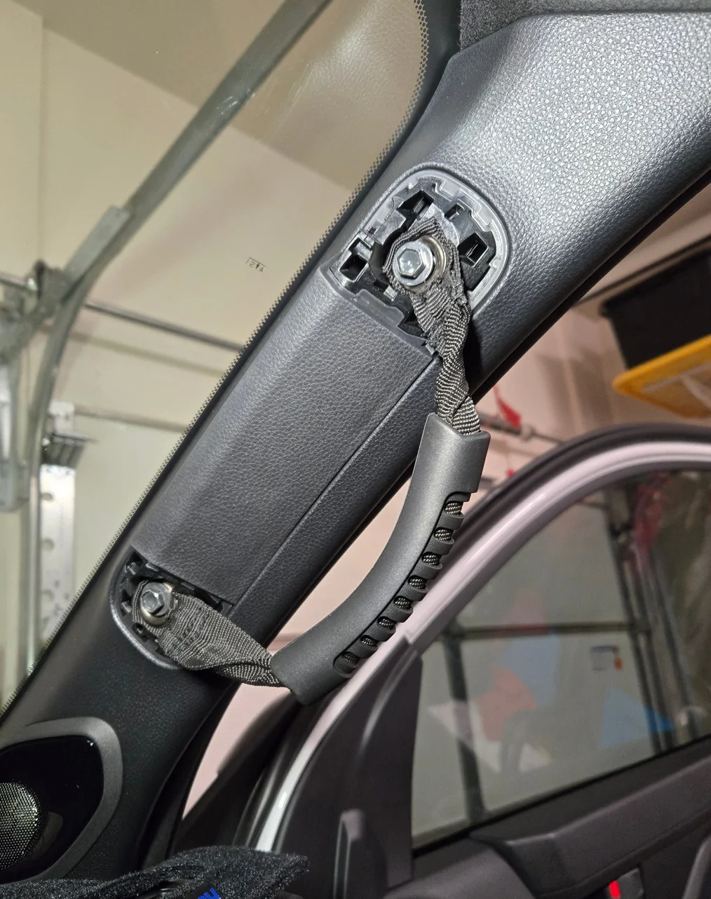

I'm not sure about you guys but every passenger that gets in my truck has no idea there is a grab handle hidden in the A pillar and for good reason, it's completely invisible when getting in, a horrible design that leave my shorter passengers looking confused on how to get in or clawing around aimlessly. I got this idea from our taco brothers and applied the idea our trucks. Perhaps not the cleanest fitment but it is functional until a bespoke 3d printed piece comes out.
So I got this paracord handle and mounted it under the oem handle reusing the same bolts and location, tools required will be a plastic pry tool and a 10 mil socket. Install time is 5 minutes, It comes in black, blue or red.
link to the part - https://amzn.to/3ZgZIsB
link to the taco thread - https://www.tacoma4g.com/forum/threads/passenger-interior-grab-handle-solution.10216/
I just did this very same mod, and...
wow
it is very robust...I put the ends underneath the entire assembly as OP did...and yes it doesn't fit
completely flush but it actually still looks factory and the handle is tight and
pulling on the handle doesn't make any of the plastics bend or wobble nor does it
try to pop off the two trim end pieces
