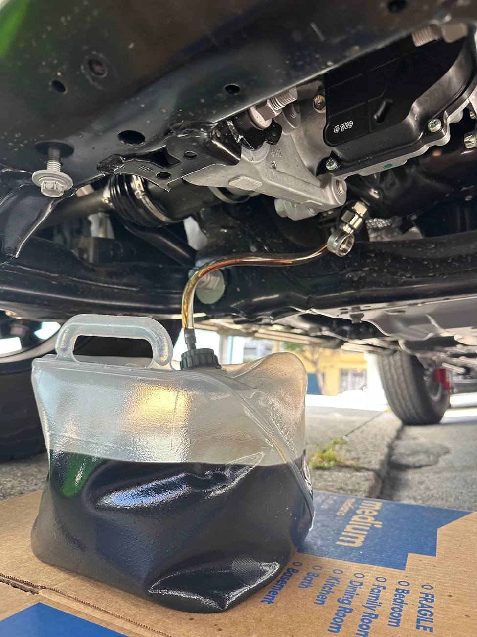

Very happy with the ValvoMax drain plug! The easiest and cleanest oil change I’ve ever done hands-down. You can even push and pull on the plastic oil bag to create a vacuum and pull residual oil out of the pan. No more waiting a lifetime for the last drip (no drain plug).

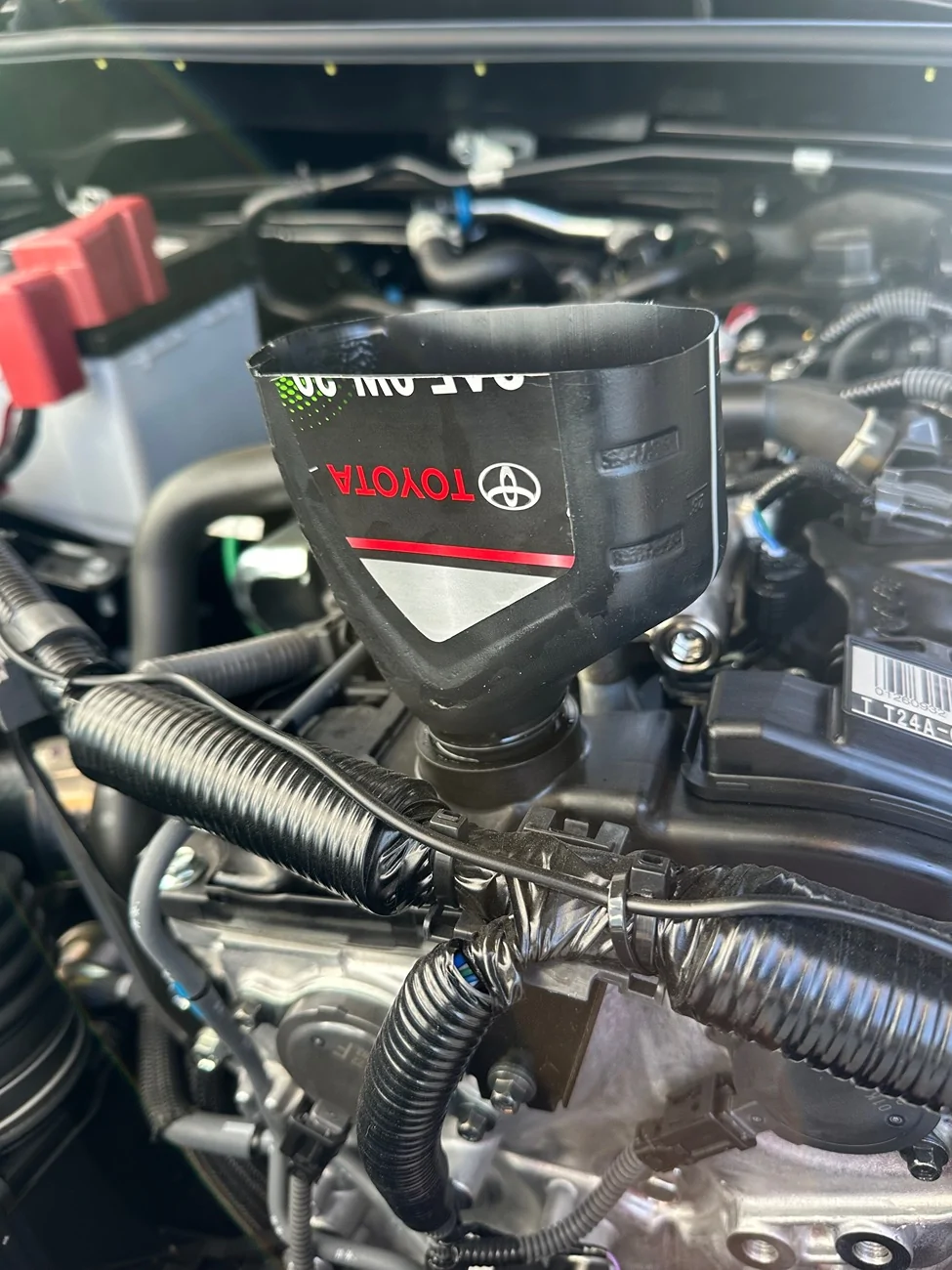

Also, the cut oil container screws into place nice and snug for a solid no BS funnel.
I went with this one bc the thread length is supposedly just right so it doesn't block oil from coming out, and the stainless steel cap that screws on feels more secure than a lever.

Was the oil color very dark (at my first 626 miles it looked like tar) . What did the 2K look like? I'll change again at 1500. Did not do filter at 626 but will change at 1500. 0W-20 till I see what the Oil Geek does.

The color was like black coffee. The photo, at least on my monitor, is accurate. I recall someone saying turbos heat up the oil darker than non turbo engines... but I am glad I changed the oil at 2k mi. It doesn't cost that much and I sleep better at night haha. I have been doing a harder break in by driving it mid throttle often going 4k and sometimes 5k RPMs, and down shifting (engine breaking) down to 2-2.5K.
