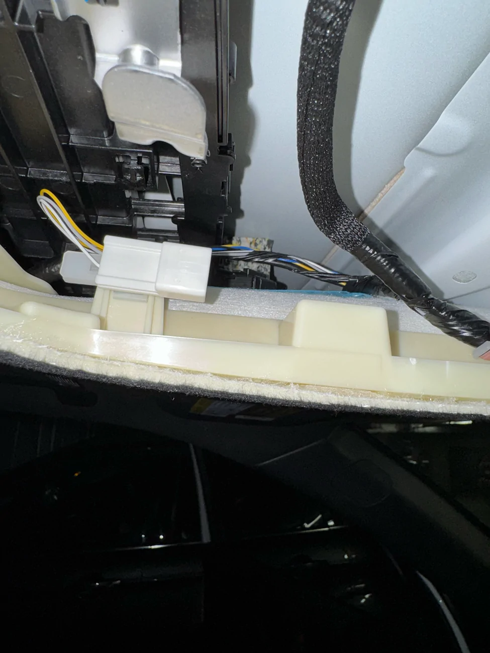

Why did you use the white plug under the overhead console and not the Y-cable for the driver assist camera?
Van Solo
Van Solo
Van
May 20, 2025
573
382
Calgary / Canada
To get parking mode and do not want to plug into safety for safety

As I understand it, using this cable, allows you to bypass the supplied Y cable and provides limited power when the car is off should there be a impact while parked it will record briefly (FitcamX calls this "Parking Mode").
When using the Y cable, there is no power once the car is turned off, so it will not record anything at that point.

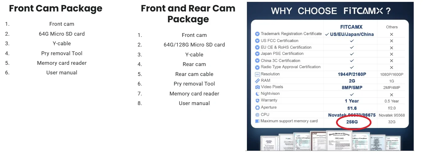

Which camera is this? I only see option for 64GB front camera (But you can upgrade up to 256mb SD card of your own) I do see one with 128GB but it is for the Front/Rear cam combo kit.

@Michaelkael post on page 2, his page capture showed the front camera with the bigger storage.
I thought I also saw it a few days ago.
I could be wrong. If what you are saying is true, maybe I will just get it now and upgrade the storage later.

Hmm not sure, on this link there are only 3 options. A front 4k camera with 64g, a front 2k/rear 1080p w/64gb, and a Front 4k/Rear 1080p with 128gb. All 3 are showing in stock.
https://fitcamx.com/collections/toy...yota-4runner-2025-2026?variant=44753210212524
2025 2026 4runner 6th gen FITCAMX dash cam install - step by step how-to DIY (on 2025+ 4runner 6th gen) fitcam
I ordered a 256gb SanDisk MAX ENDURANCE microSD™ Card which is made for applications like a dash cam.

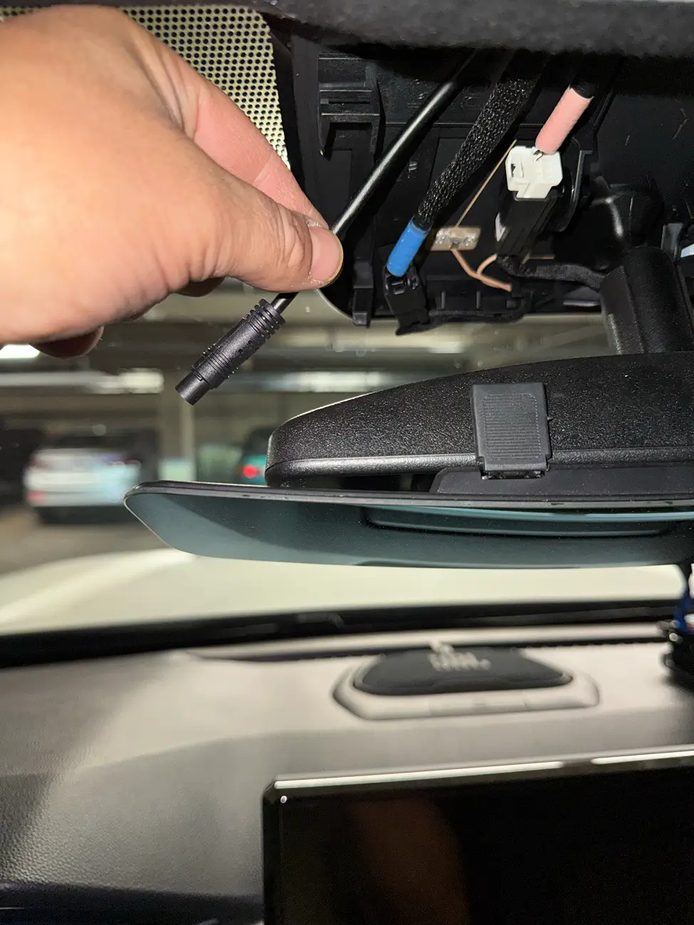

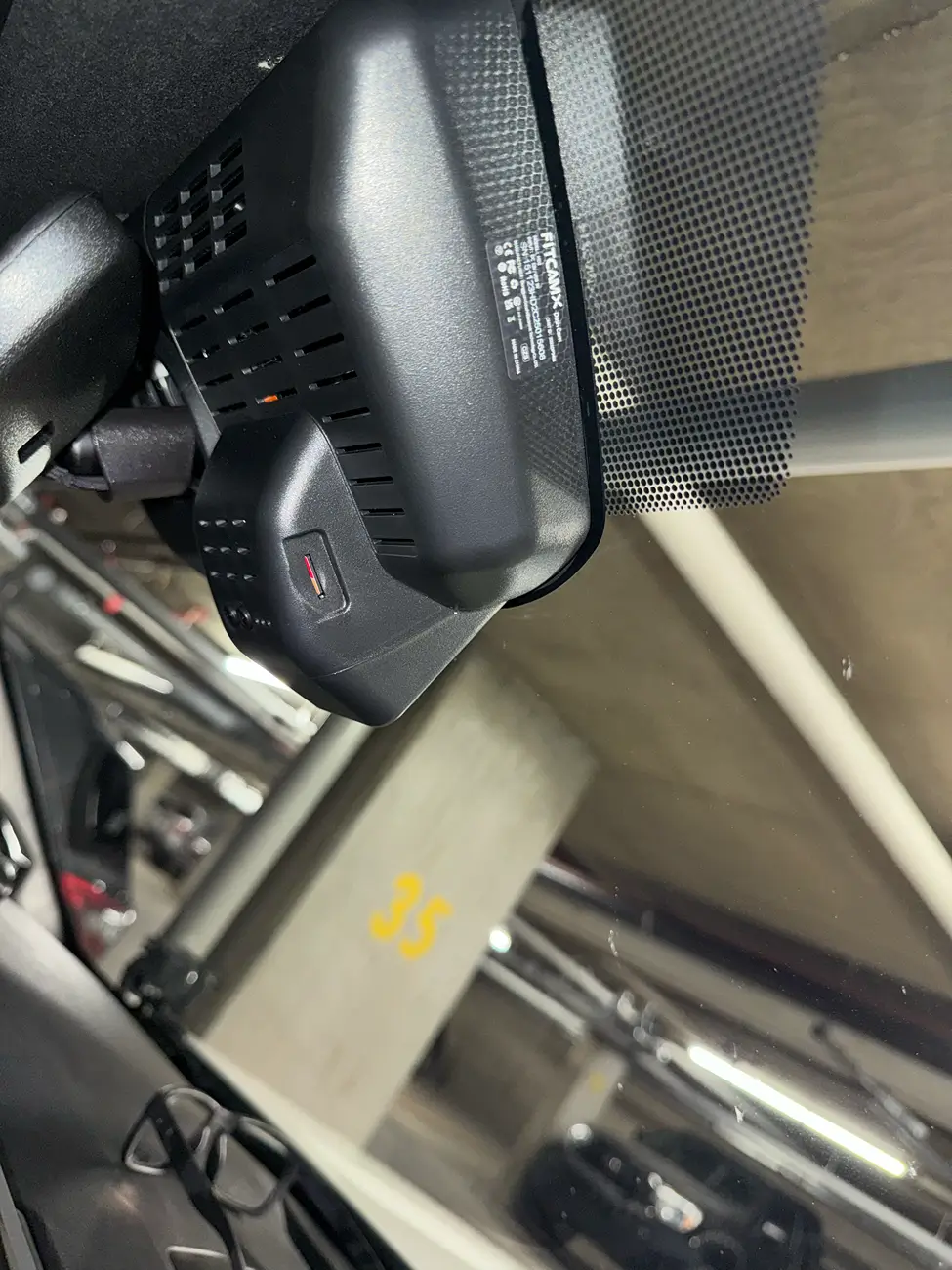

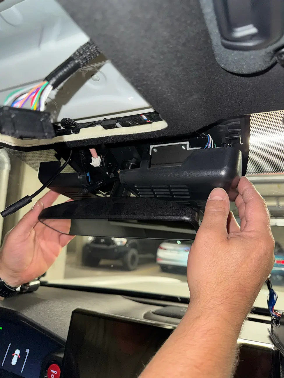

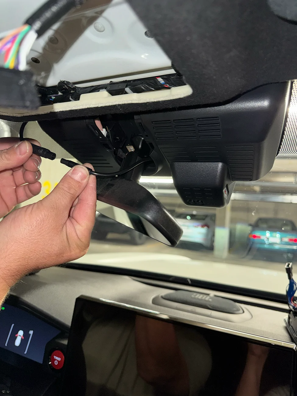

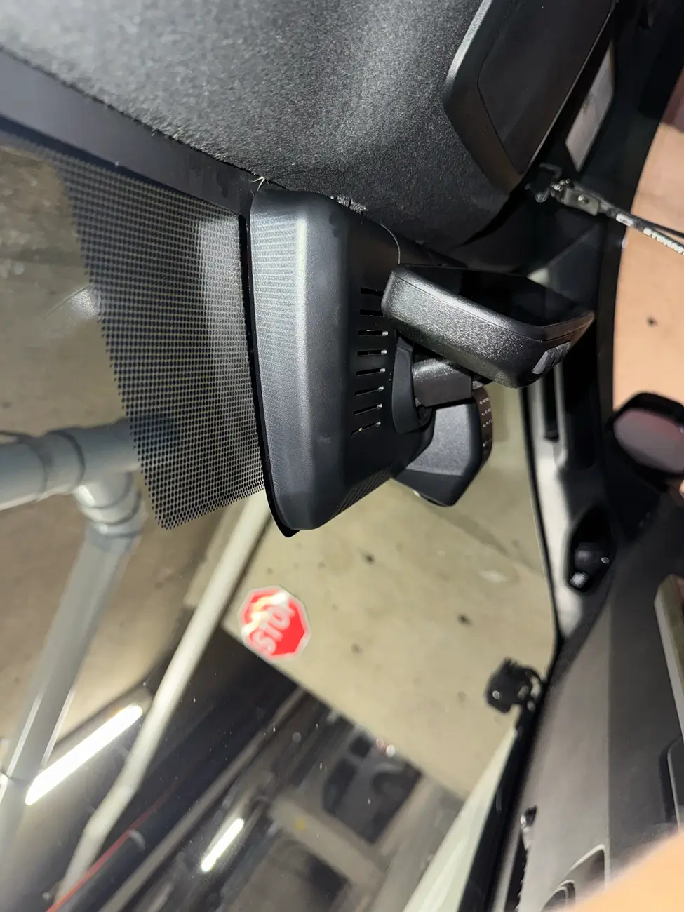

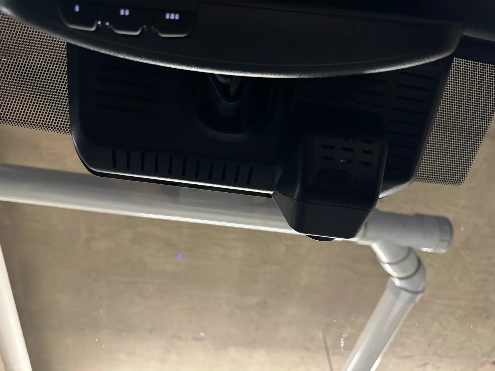

It's here at its installed....................FITCAMX 2025 4Runner
Install time 10minutes and neatly cabled
I chose the CLP filter and the oem dash cam plug in from FITCAMX

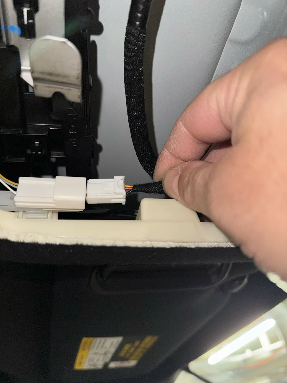

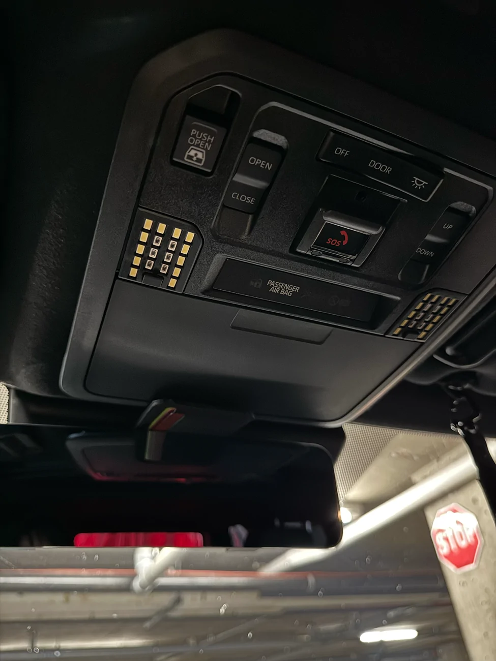

Step 1. Remove Overhead Console. (One Swift Pull Down the front near windshield)
Locate the White OEM Dash Cam Plug.
Plug in the optional FITCAMX power cable.
Route the power through the headliner toward the mirror.

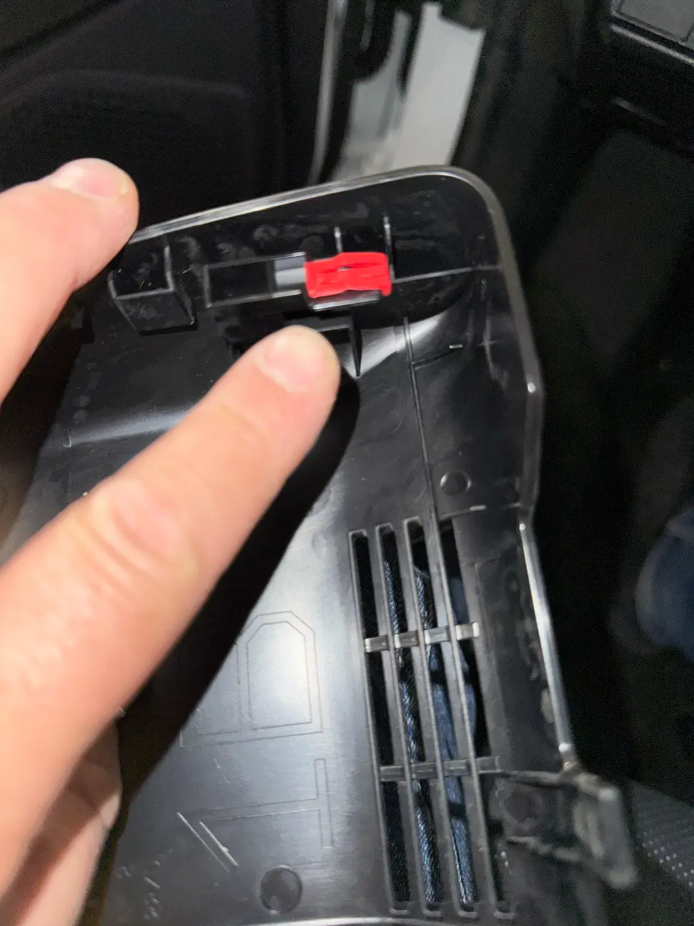

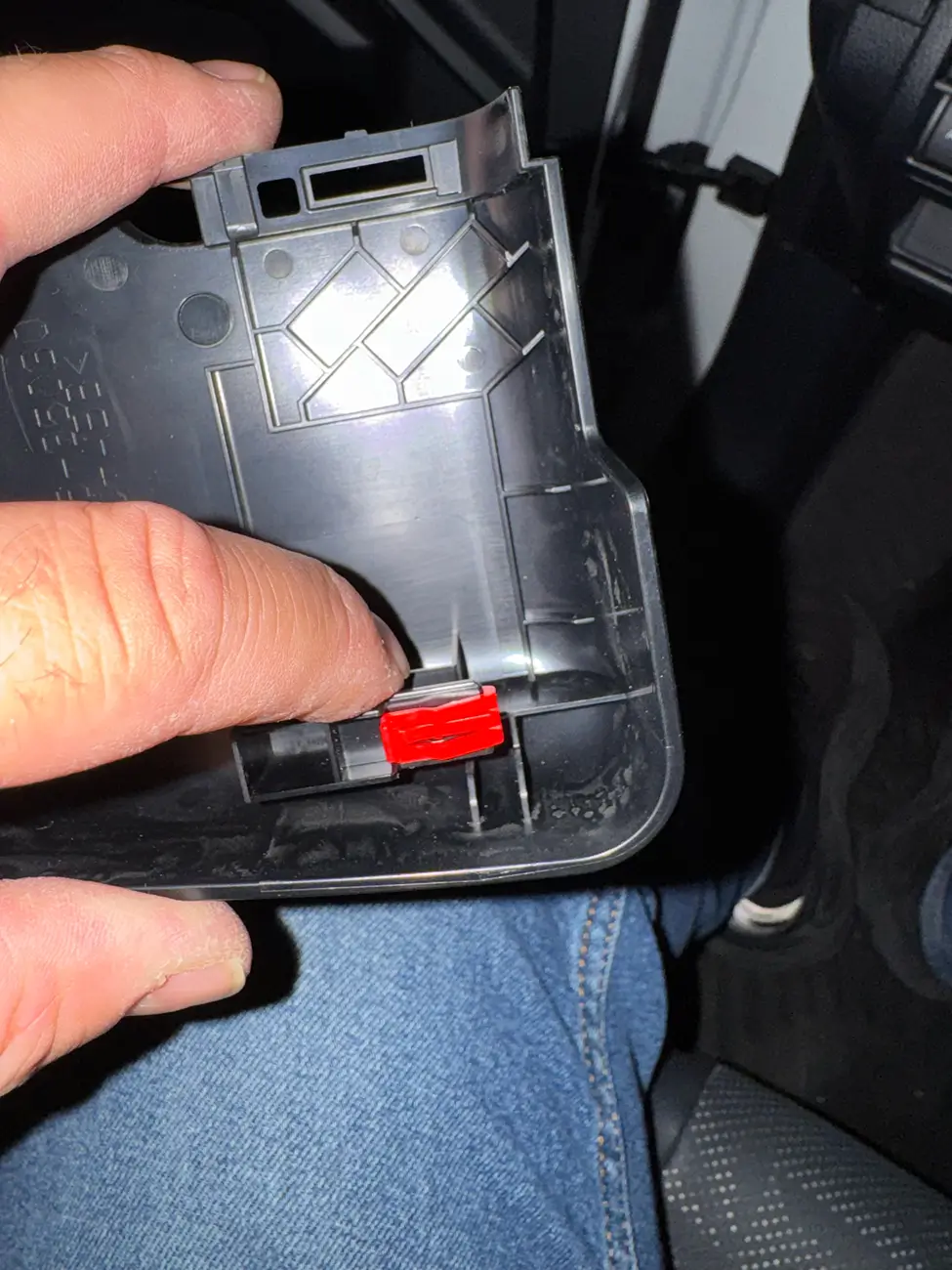

Step 3. Remove OEM Mirror Housing and remove the two red clips and relocate the to the FITCAMX housing.

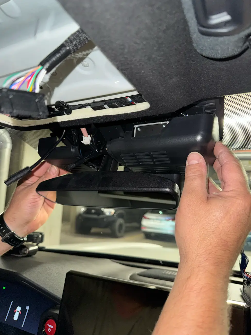

Step 4. Slide the FITCAMX housing into place and listen for the Click!
Step 5. Connect the power cables togethers.
And get out there and start recording your Off Road Adventures...... FITCAMX
