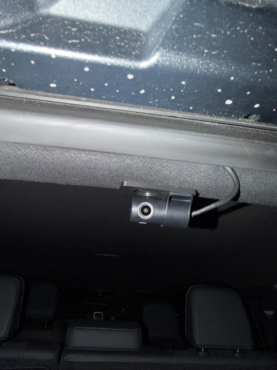

Just wondering where everyone put the rear camera at. I ended up putting the camera on the rubber part of the window

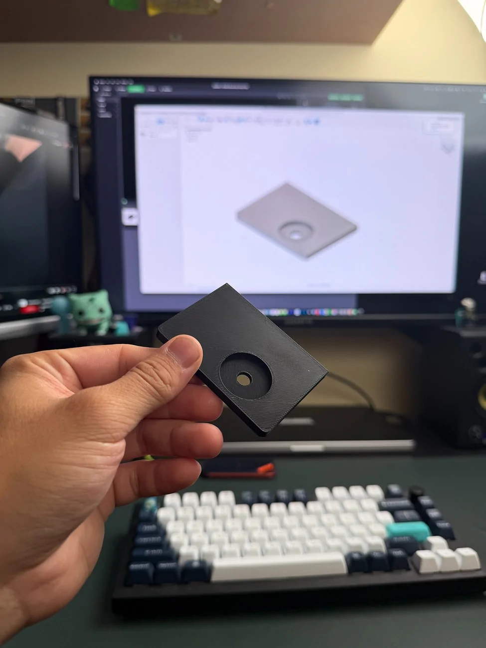

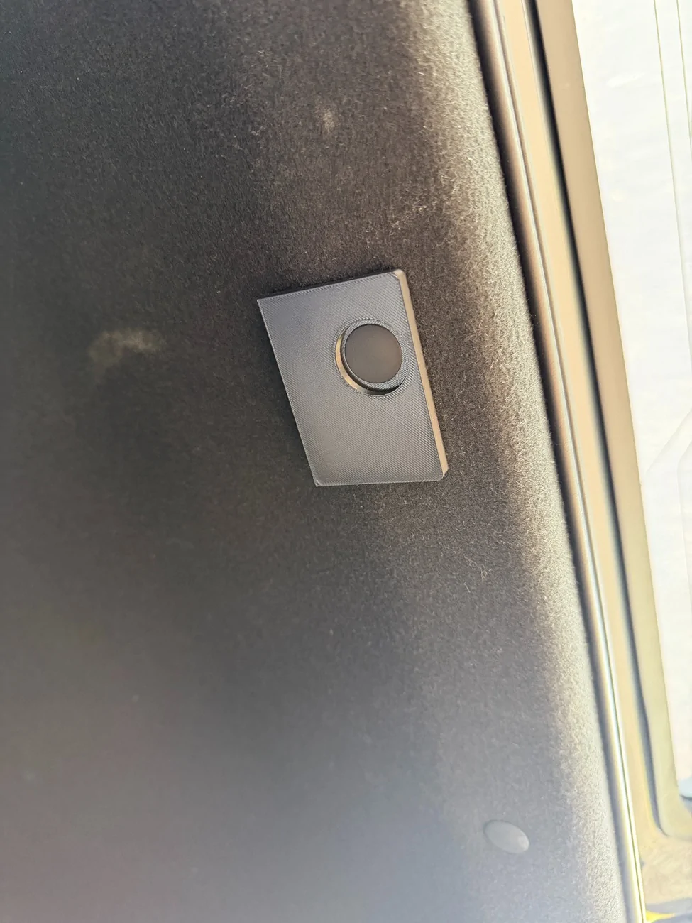

This is my second installation of the Fitcamx for the 4Runner. I had previously been helping with testing their prototypes. This time I asked to receive the additional rear camera. Routing the cable is simple honestly. They give you more than enough, however there isn't a lot of spots to actually mount the camera in the back. And I didn't want to obstruct the window or run the cable through the trunk.
Decided to design a 3D printed plate that can be mounted to the roof liner pin above the trunk. With some velcro on the other side, the plate itself does not move at all once secured back through with the pin. I also designed the plate to align itself with the camera to have it centered perfectly. I have a full view of the back as the camera is extremely wide.
Love this, would you mind sending the file or the measurements you came up with?
