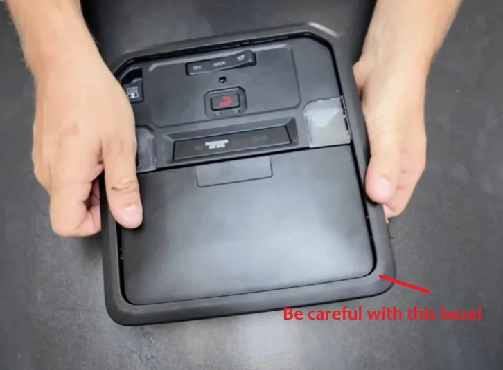

Didn't take any pictures but if you watch this video for the Meso Customs light install its the same thing. In this video, they make it look really easy, and it wont be that easy... It just pops out but it takes a lot of force that first time you do it, and you have to be careful that when your pulling down on it, your pulling down on the whole assembly and not just the bezel that's around the outside as you will snap the clips on the bezel if you pull it. There is not a lot of room and it will be pinching your fingers so its just a PITA, its not hard just learn from my mistakes and take more care with the bezel. At the time, I didn't realize it was just the bezel coming down so I kept pulling.
Thanks. I just installed the OEM dashcam because I got one from eBay for really cheap new without box.
Removing the map light console was the toughest part. At first, I was afraid I’d break something and spent a lot of time being too gentle. Later, I found out that besides the bezel, there’s really nothing fragile — the console is held by four solid clips that don’t break easily. Once I knew that, I went back, pushed my fingers all the way in and pulled it down with confidence, and it popped right out in two seconds. Nothing broke!
