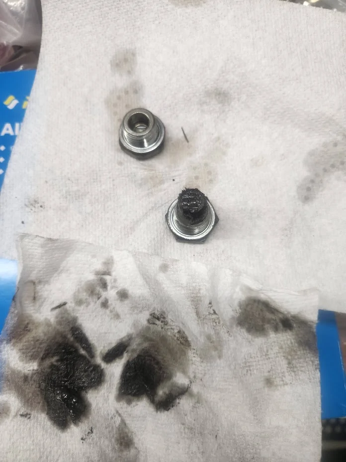

I did my rear Diff oil change last week @ 30K and to be honest the oil still looked "pretty" good. Of course it had metal sparkles and sludge on the plug but it still had quite a nice gold tone to it.
Note I have a TH that holds an extra quart in there and did minimal towing and hard off-roading a few times.

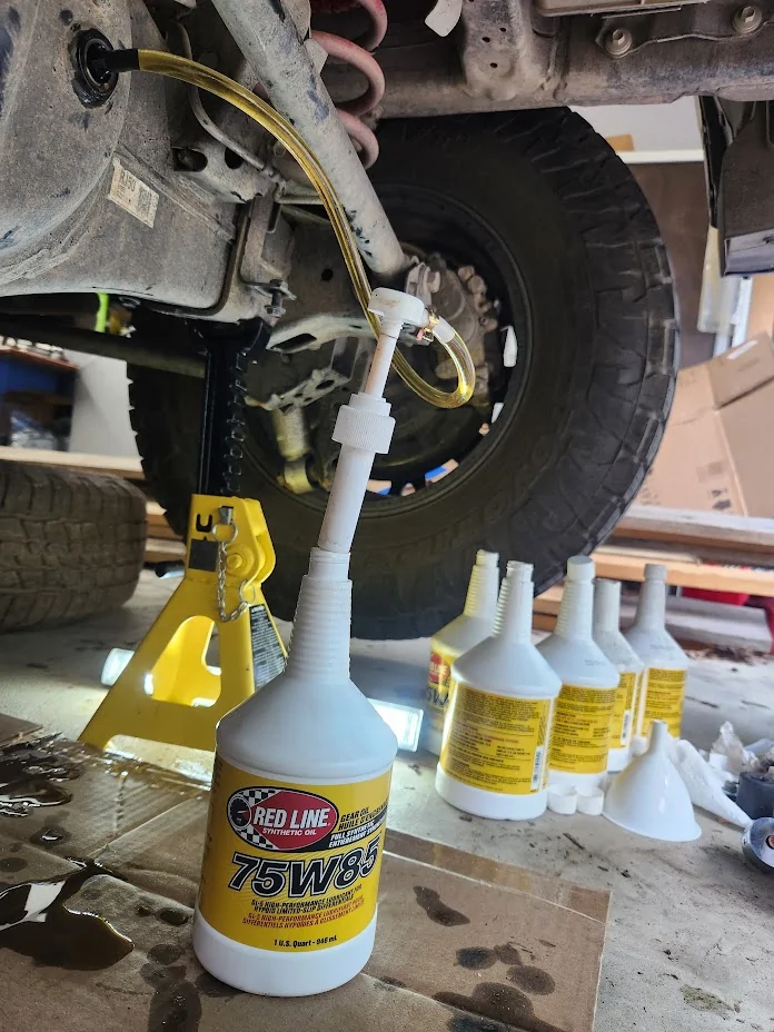

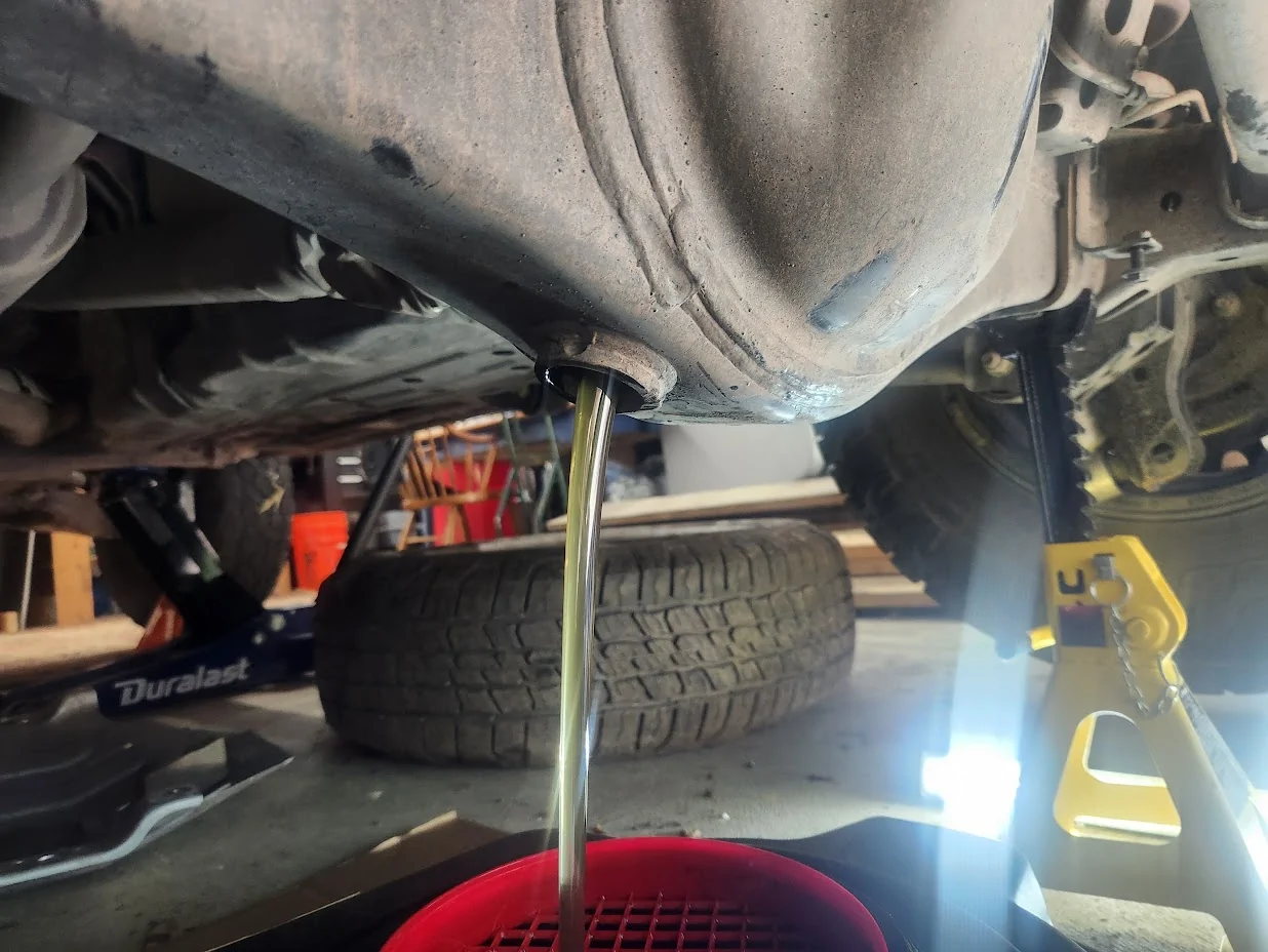

Did the front and rear differential fluid change last weekend at 18,032 miles. Just a small bit of towing in that milage but a healthy amount of off-roading (~12 outings - mostly blue trails and one black).
The rear was surprisingly clean (see photo of it draining out). Decent amount of "iron filings" on the magnet but no metal chunks like the Car Care Nut had on his Tundra.
I needed a 7th bottle to fill the rear diff. It took ~6.3 quarts. Some of that extra was spillage as I figured out how to use the pump I got which was too big for the Redline bottle opening.
Front probably didn't require a change since I had the TRD Lift Kit installed less than 1500 miles ago and it is supposed to include a drain of the front diff as part of installing the new front axels but I had the truck on jack stands/skid plates off; and when I checked the front diff fill spot the fluid was a different color (greyish brown?) than what came out of the rear (and the Redline 75W85 that I put in) so I went ahead and drained/filled it.
Surprisingly CLEAN rear diff fluid
2025 2026 4runner 6th gen Differential Fluid Change DIY Guide (Front & Rear Diff) - for 2025+ 4Runner 6th gen 20260808_130807
Rear diff fill and drain plugs.
2025 2026 4runner 6th gen Differential Fluid Change DIY Guide (Front & Rear Diff) - for 2025+ 4Runner 6th gen 20260808_130924
Awkward, ill fitting pump
