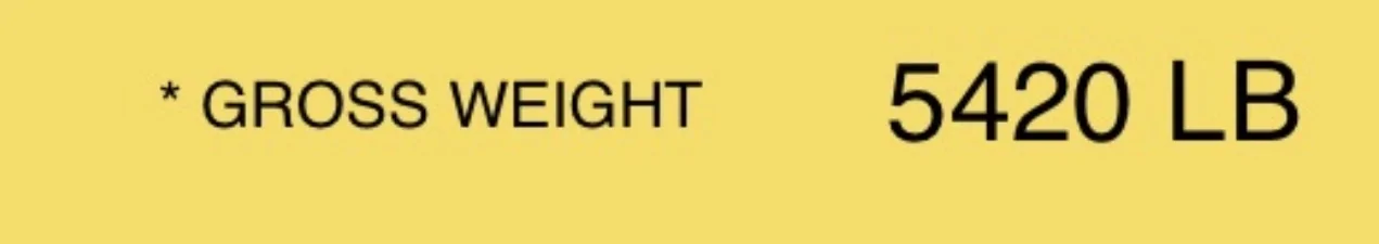

They add a yellow "adjustment" sticker for the per-vehicle port/dealer installed options.
This also isn’t making sense. My limited has a sticker for 27 lbs or something like that, and the only PIO is rubber floor mats!

For what it’s worth, I picked up my 2026 SR5 4x4 last week, and similarly have the 895lbs payload in the door jam sticker, and Gvwr 6075lbs. I went and weighed it: 7/8th tank of gas, dealer installed cross bars, all weather mats, plus a toddler car seat, and a moving blanket in the trunk: weight was 4760lbs. So a payload of 1315lbs after the above additions - pretty consistent with the Toyota reported curb weight, making the door jam sticker way off.
Are you serious? wow, that's interesting. My 2025 SR5 4Runner with PT4WD illustrates 1160/1165 lbs on the door jam..i'm going to take a second look...i might be seeing things..lol
It was a shock when I picked it up - I had got it tow a camper and realised if the door jam was accurate I wouldn’t be able to bring my wife or kid!
Does yours have the 3rd row of seats? From what I have read models with the 3rd row seem to have a higher value in the door jam (but still lower than it should be)
