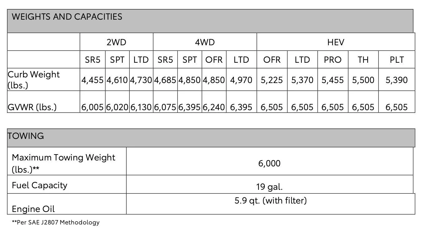

In case you haven't seen these specs in the full specs thread (searchable text PDF version), listing here for easy reference.
6th Gen 4Runner Towing Capacity Specs
Maximum Towing Capacity Weight: 6,000 lbs​
(per SAE J2807 Methodology)​
Fuel Capacity: 19 gallons​
Engine Oil Capacity: 5.9 qt. (with filter)​
6th Gen 4Runner Vehicle Weight by Trim Levels
  • Curb Weight (lbs):
    • Gas Engine (i-Force)
      • 2WD SR5: 4,455 lbs
      • 2WD TRD Sport: 4,610 lbs
      • 2WD Limited: 4,730 lbs
      • 4WD SR5: 4,685 lbs
      • 4WD TRD Sport: 4,850 lbs
      • 4WD TRD Off-Road: 4,850 lbs
      • 4WD Limited: 4,970 lbs
    • Hybrid Engine (i-Force Max)
      • Hybrid TRD Off-Road: 5,225 lbs
      • Hybrid Limited: 5,370 lbs
      • Hybrid Platinum: 5,390 lbs
      • Hybrid TRD Pro: 5,455 lbs
      • Hybrid Trailhunter: 5,500 lbs
  • Gross Vehicle Weight Rating (GVWR) (lbs):
      • 2WD SR5: 6,005 lbs
      • 2WD TRD Sport: 6,020 lbs
      • 2WD Limited: 6,130 lbs
      • 4WD SR5: 6,075 lbs
      • 4WD TRD Sport: 6,395 lbs
      • 4WD Off-Road: 6,240 lbs
      • 4WD Limited: 6,395 lbs
      • Hybrid TRD Off-Road: 6,505 lbs
      • Hybrid Limited: 6,505 lbs
      • Hybrid Platinum: 6,505 lbs
      • Hybrid TRD Pro: 6,505 lbs
      • Hybrid Trailhunter: 6,505 lbs

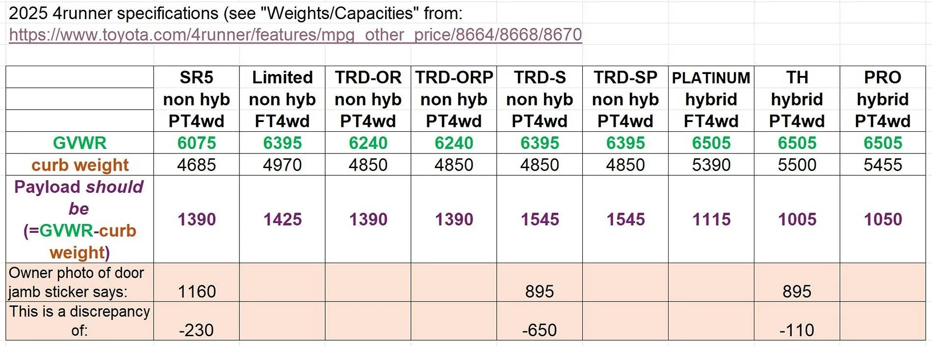

Hi. Can someone please explain what Toyota is doing to increase the GVWR from the 2wd SR5 @ 6005lbs to the TH hybrid at 6505lbs? Different wheels and tires / suspension ... but any difference to the frame or brakes? Or is toyota de-rating the GVWR for the lower trims and assigning a higher rating to the higher trims just with no real difference? My thought is, maybe the SR5 4x4 is actually capable of a higher GVWR and thus payload but Toyota is derating them for some reason. THanks!
Hacksaw
Mar 3, 2025
248
186
az
2025 4runner TRD-ORP
The industry standard definition of payload is:
Payload = GVWR - curb weight
That should be the factory payload on the driver's door jamb sticker, but it's not.
They add a yellow "adjustment" sticker for the per-vehicle port/dealer installed options.
Owners then have to further reduce the payload based on things they add, e.g. roof rack weight, new tires/wheels that are x lbs heavier than factory, etc.
GVWR is a rating given by the manufacturer based on the frame and other considerations for a given model. GVWR cannot be weighed on a scale. It's a determination/calculation, to set a worst-case safe maximum.
So, why are the payloads listed on driver's door jamb stickers too low by hundreds of lbs? If toyota wanted to add "safety margin" they should have baked that into the GVWR. Did they mis-state the GVWR and don't want to admit it? Misprinted door jamb stickers?

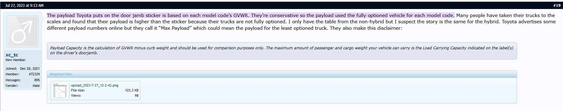

I saw on Tundra forum where they stated this, which is lazy but understandable:
2025 2026 4runner 6th gen Curb Weight, GVWR, Towing Capacity for 6th Gen 4runner (2025+) 1748646137211-w1

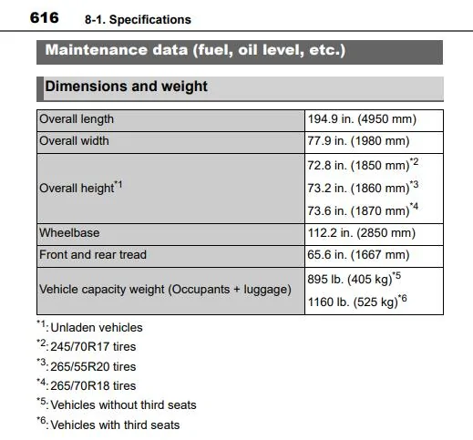

But then I opened up the most recent online manual and it all becomes clear that Toyota is just lazy as shit:
2025 2026 4runner 6th gen Curb Weight, GVWR, Towing Capacity for 6th Gen 4runner (2025+) 1748645951102-i
All I can say is, wow. Toyota really does not understand how payload works. Why don't we all just play it safe, call it 500lb for every 4Runner, and call it a day? /s
Better to just go to the scales and weigh things, take those numbers and build in a conservative buffer of 100-200lb, and go from there.

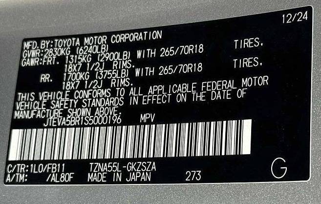

Yeah just got my sr5 4w and it says payload 895 wtf. Is this a a label issue? Its a base sr5. It has yellow sticker of additional 27 lbs..assuming roof rack.

strangely the manual says that all 2-row models are 895 and all 3-row models are something like 1160. Makes no sense to me!
