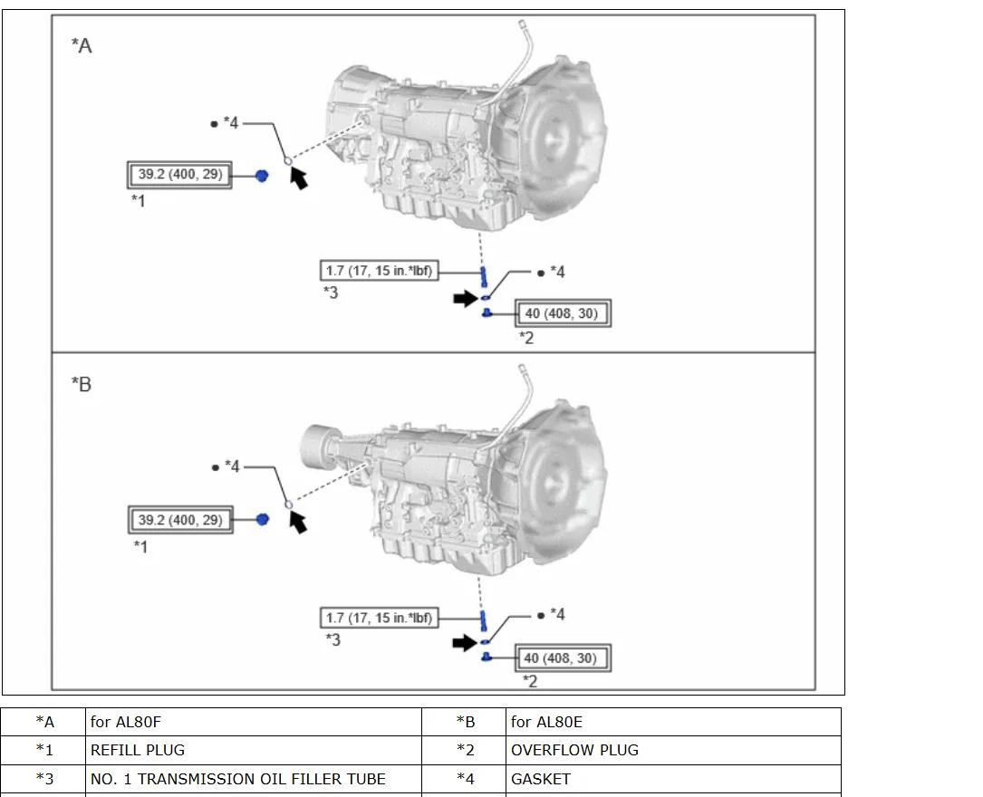

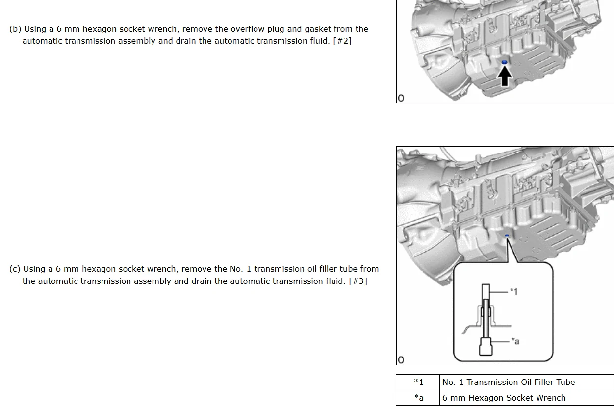

it's easy if you follow specific procedures in TIS
essentially you add fluid until it comes out the drain/overflow hole

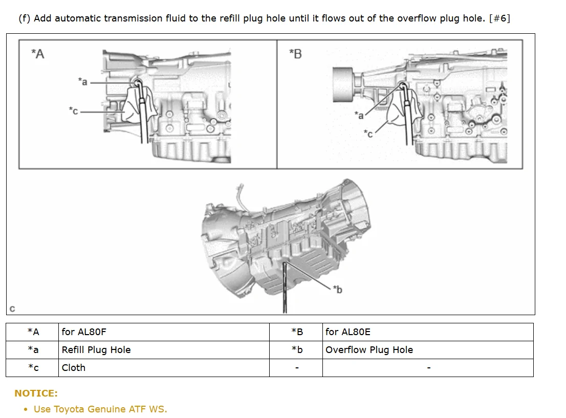

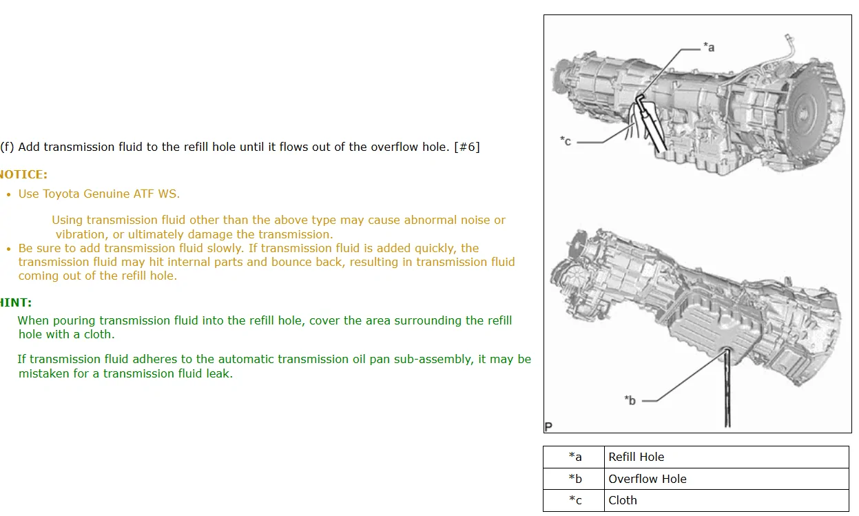

hybrid is same procedure as non-hybrid
add fluid until it drips out the overflow hole
2025 2026 4runner 6th gen Can’t find the transmission drain plug 1782146267744-02
there are a lot more things to consider besides what is on these drawings

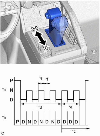

How to get into fluid temperature detection mode ? a shifter dance
a) Turn the ignition switch off. [#2]
(b) Depress and hold the brake pedal.
(c) Start the engine.
NOTICE:
To reduce load, make sure that all electrical systems, such as the air conditioning and audio system are off.
(d) Slowly move the shift lever from P to S, from S to 1st, and then back to P.
HINT:
  • Keep the shift position in each position for approximately 3 seconds.
  • Slowly move the shift lever to circulate the automatic transmission fluid through each part of the automatic transmission assembly.
(e) From the shift position in D, move the shift lever between N and D within 1.5 seconds for 12 seconds or more continuously to switch to automatic transmission fluid temperature detection mode.
NOTICE:
Do not pause for more than 1.5 seconds.
HINT:
The automatic transmission fluid temperature detection mode will be activated by moving the shift lever between N and D within 1.5 seconds for 12 seconds or more continuously.
2025 2026 4runner 6th gen Can’t find the transmission drain plug C533990C01
*a​
Shift Position
*b​
Indication of Shift Position
*c​
Automatic Transmission Fluid Temperature Detection Mode
*d​
12 sec. or more
*e​
2 sec.
*f​
Less than 1.5 sec.
(f) Check that the D shift indicator comes on for 2 seconds and then turns off.
