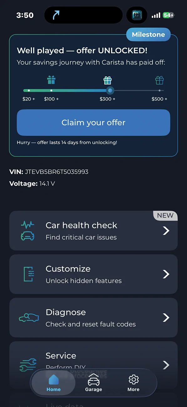

I am headed to Sam's Club right now to buy this Duracell AGM battery. I know why it died last night but I don't think that OEM battery is very powerful. I just went by the dealer and he said they would charge me $175 to clear the codes since the battery went dead on my watch. So much for being honest with these people. He did say that if I pull the OEM battery right now and replace it, by having the cables unhooked, it should clear the codes.

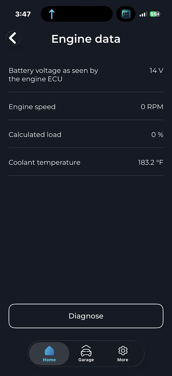

New battery installed. Had the leads off for at least 30 minutes. Codes did not reset. Had to use my Bluetooth OBD2 tool and Carista to clear the codes.
I'm glad this lead to me replacing the battery! I'll be happier with an AGM.
