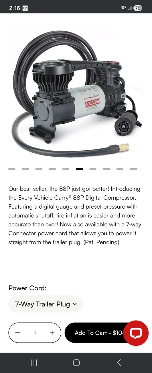

I toyed with that same idea of mounting in the engine, then I just decided to plug into my trailer port using this. This way I don't have to fiddle with opening my engine Hood .
Oh ! I'm not an advocate of any particular brand.

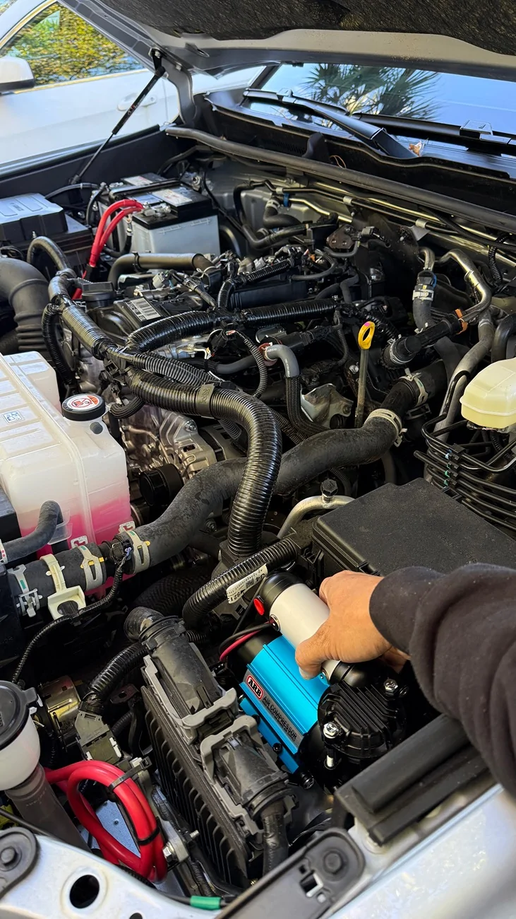

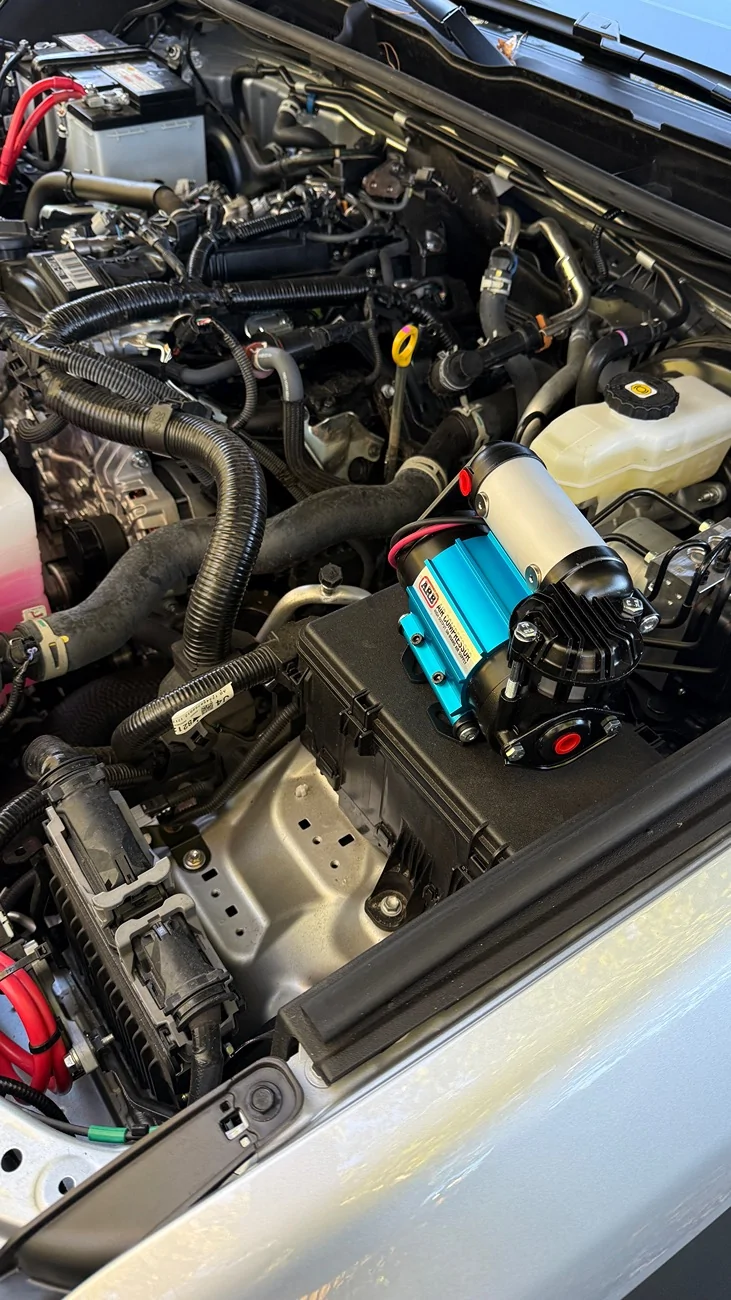

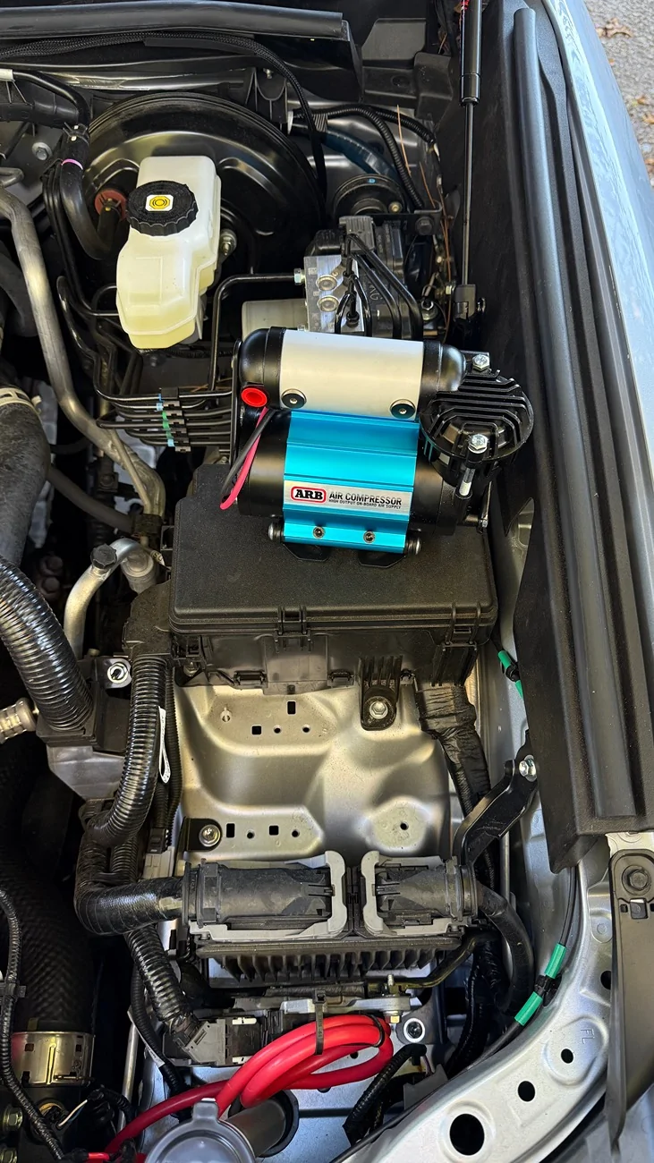

That’s exactly where mine is mounted. The installer used a bracket; not sure if they sourced it from ARB, but it fit perfectly in that space.

Have you used this yet? I also looked at this one but was afarid that it might take to long to fill up from 20 psi
Joe Dirt
Sep 24, 2025
400
189
25 ORP
Yes I have used it as testing in the garage where I deflated to 15 lb then gassed up to 34. I usually run between 34 and 36 for Highway. Very quick took around 3 minutes per tire. Really easy to set up just plug into the hitch power and have your engine running and go for it.
I'm never in a hurry to deflate or inflate like some of these other tools offer. I like this because it's simple and I can share it with friends if they need it.
Just look at the specs and do a little investigation on what the key items are. Overheating PSI pressure per wheel they even show tire sizes as the average inflation rate.

My OTT tuner observed that someone had moved their ECU down and over to make room for a compressor and the compressor and mount had to be removed for access the ECU for the tune. I suspect ECU access could also be an issue for some maintenance. So just a caution for folks installing compressor in that general location to try to keep access to all those convoluted ECU connectors from being hindered. Not saying that the install above that Vready posted does this - it looks like at least the top two large ECU connectors are still accessible - just a comment from an OTT Tech describing a tune that took longer than normal. (Honestly, that ARB and bracket looks really well done.)
