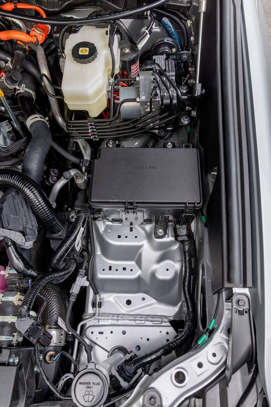

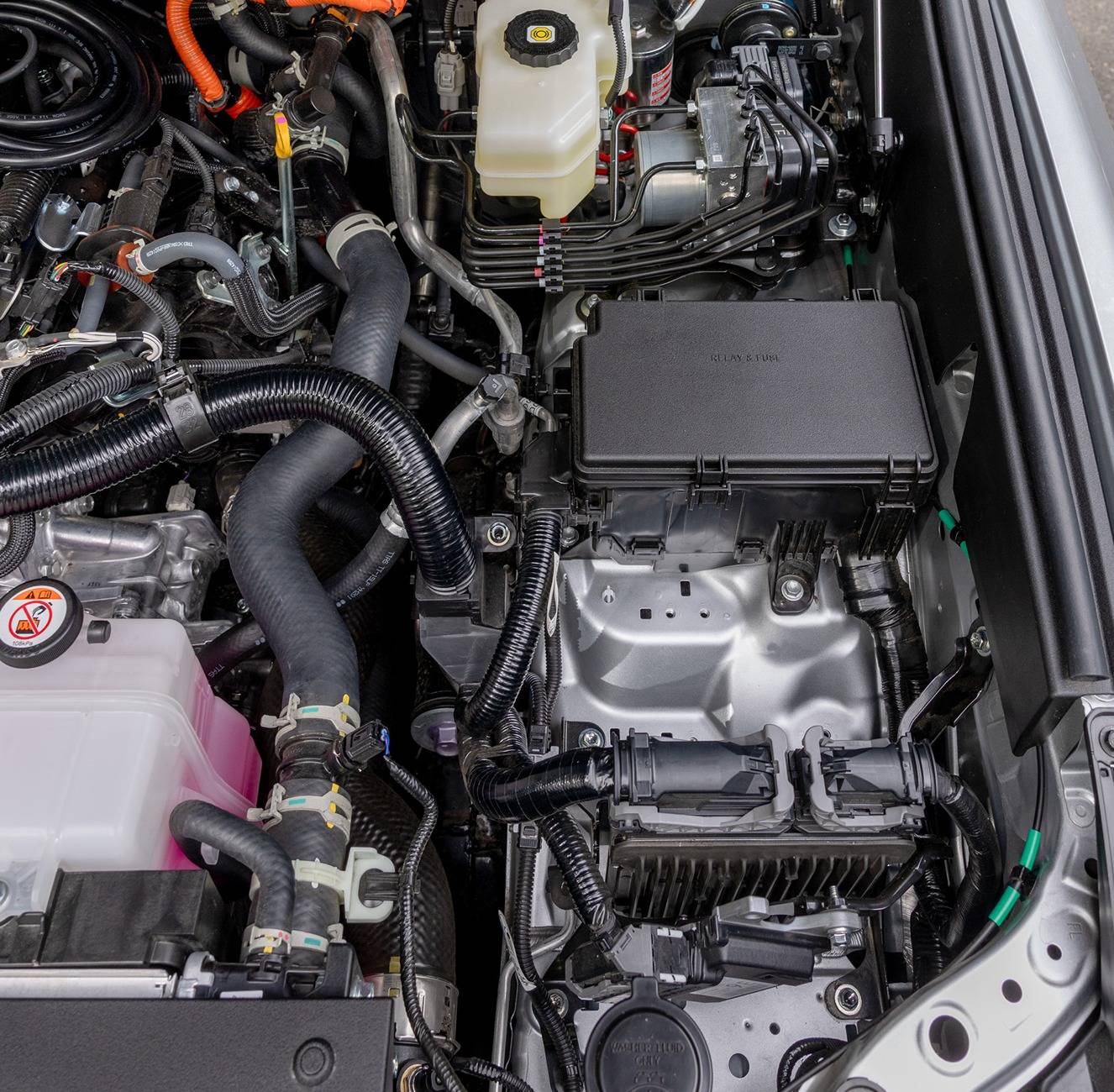

This is how it looked when I started (stock 4Runner configuration)

I disconnected the battery and removed the ECU modules, which opened up a much bigger space.

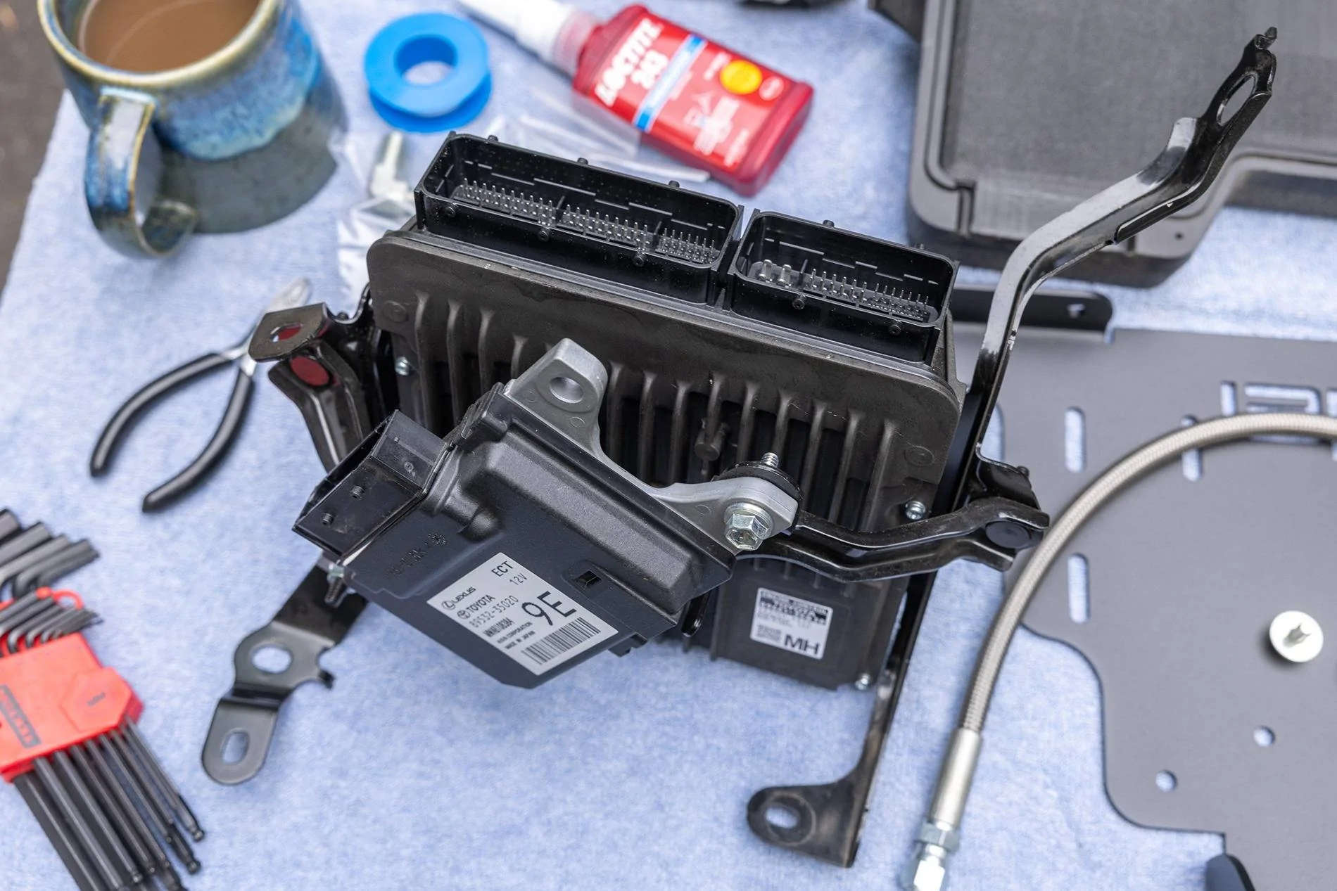

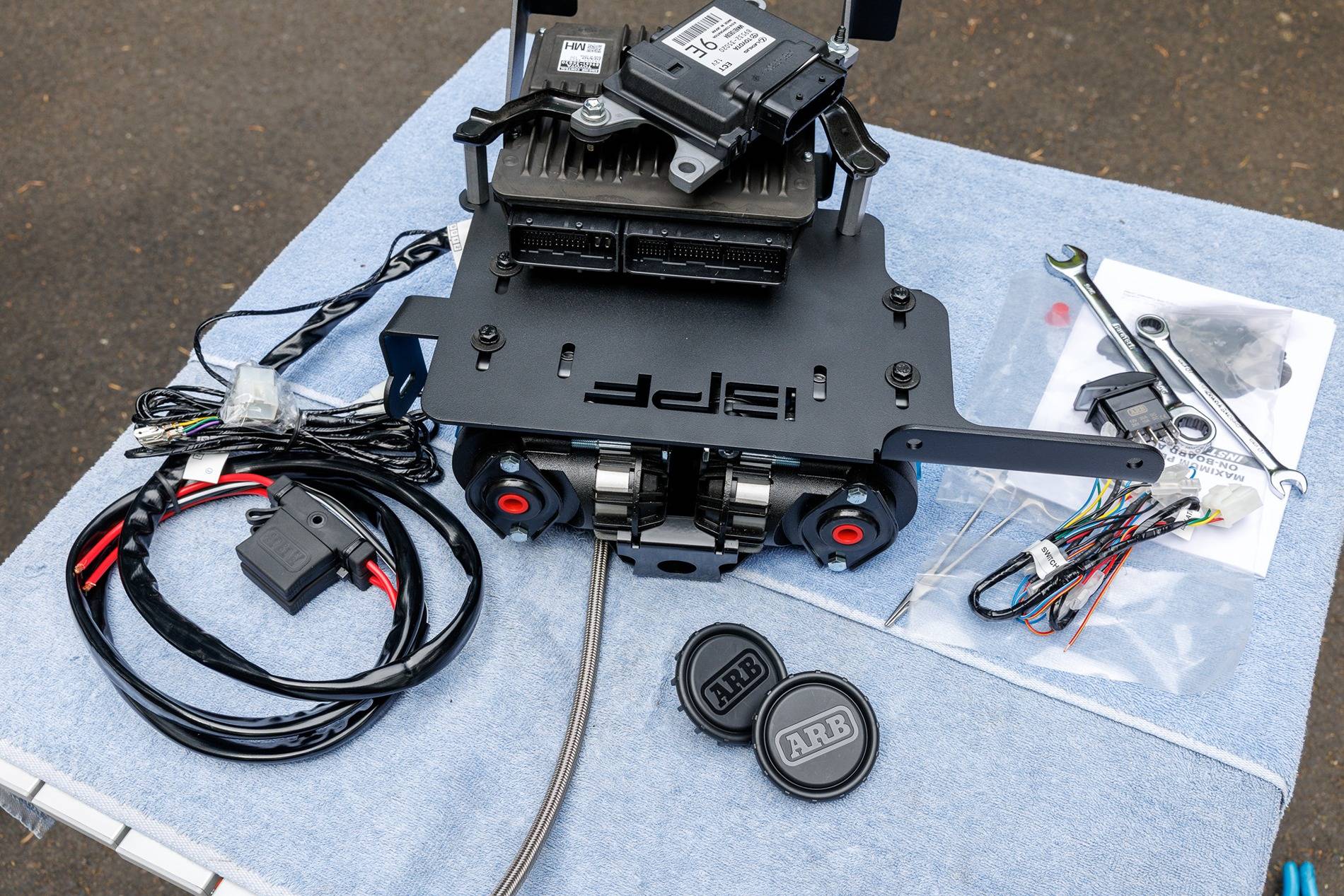

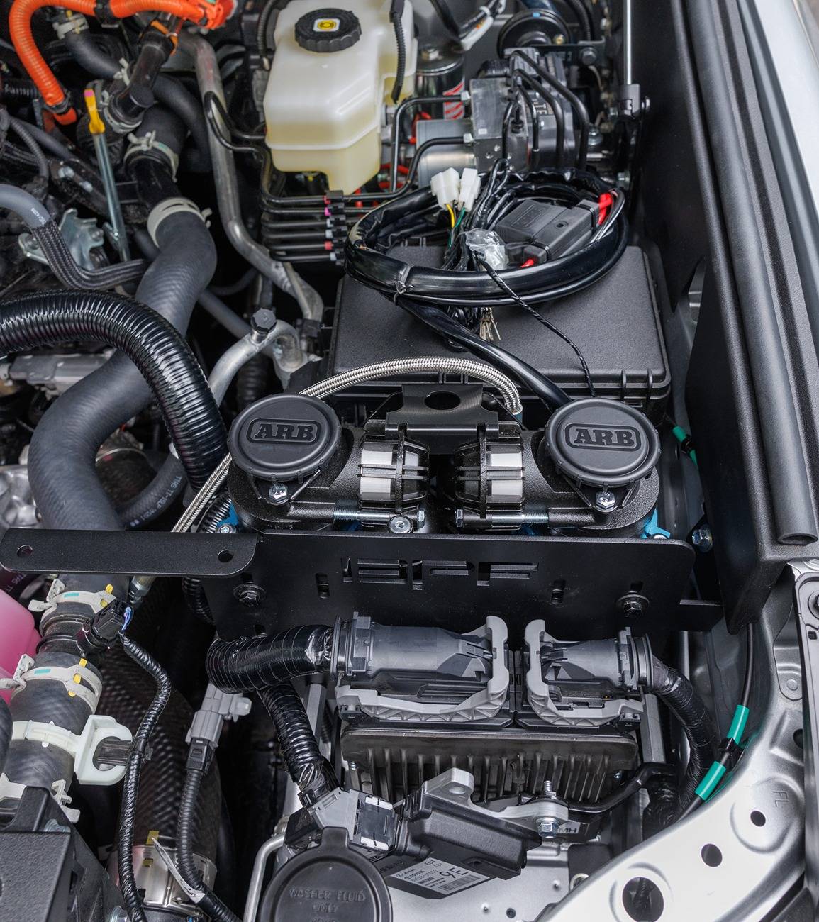

Following the instructions from Bullet Proof Fabricating (a Canadian company BTW) I mounted the compressor and ECU onto their bracket.

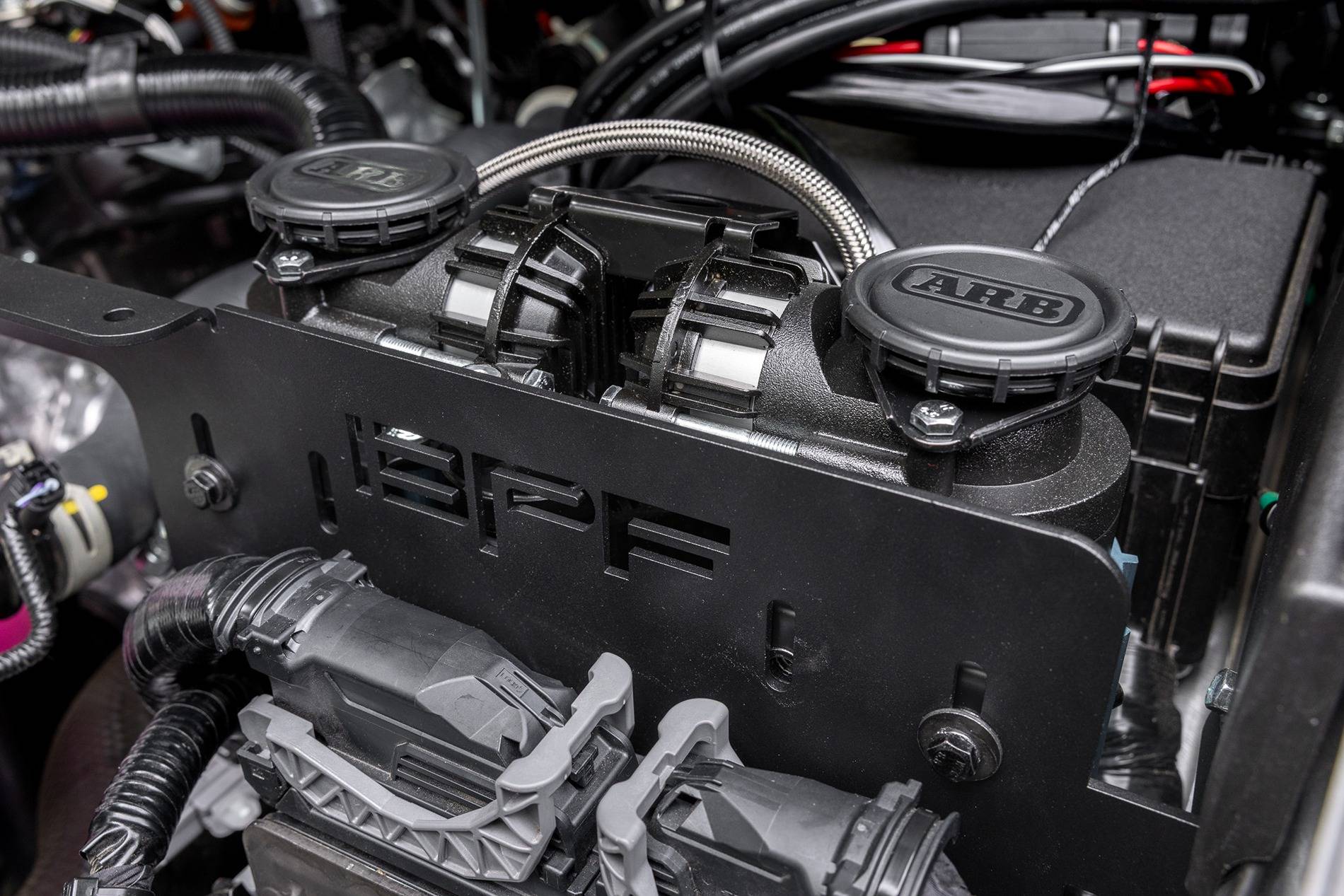

Once I dropped it in and mounted it with the original factory bolts, it looked like this:

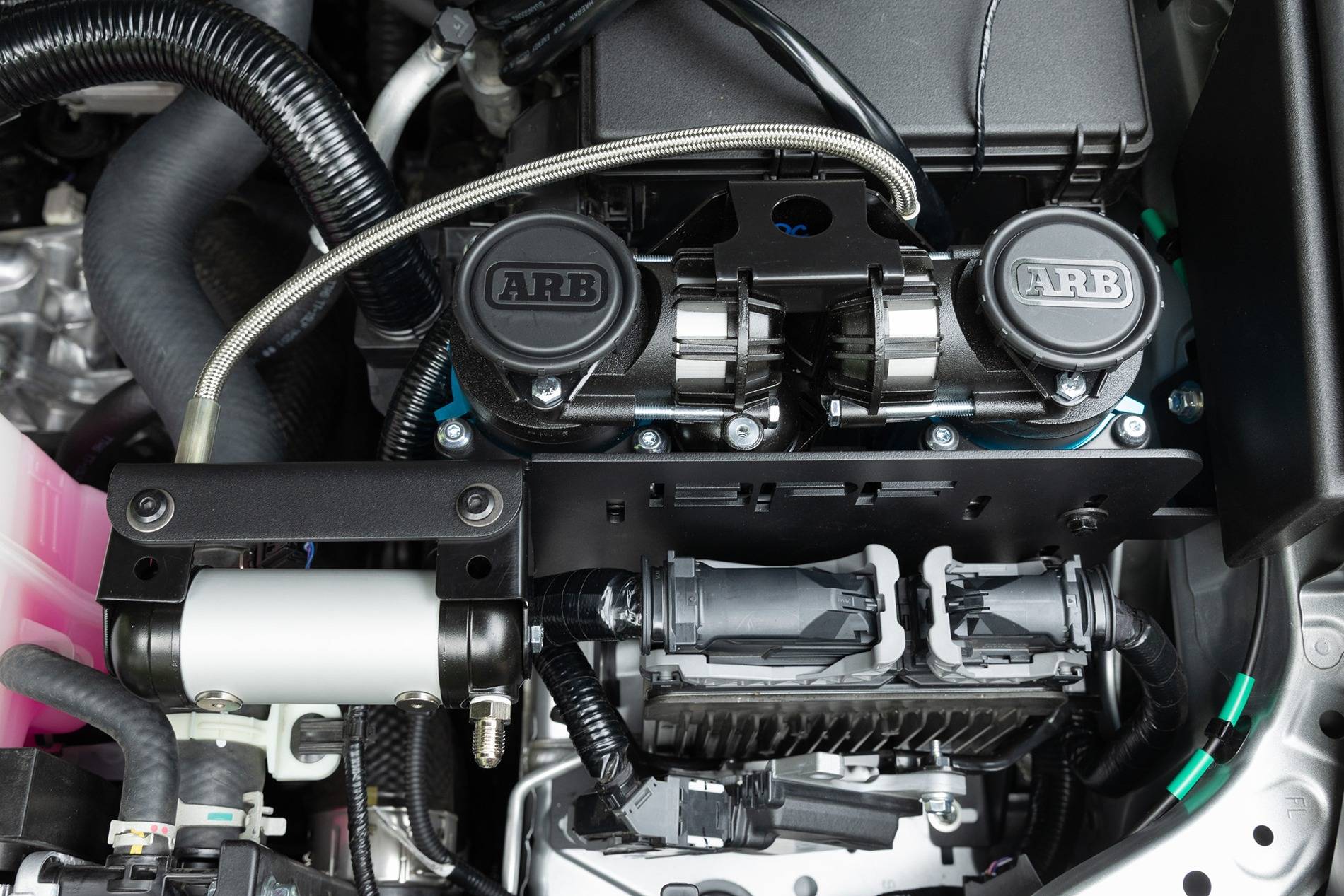

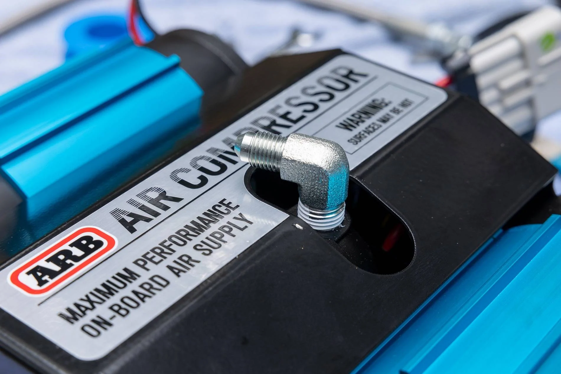

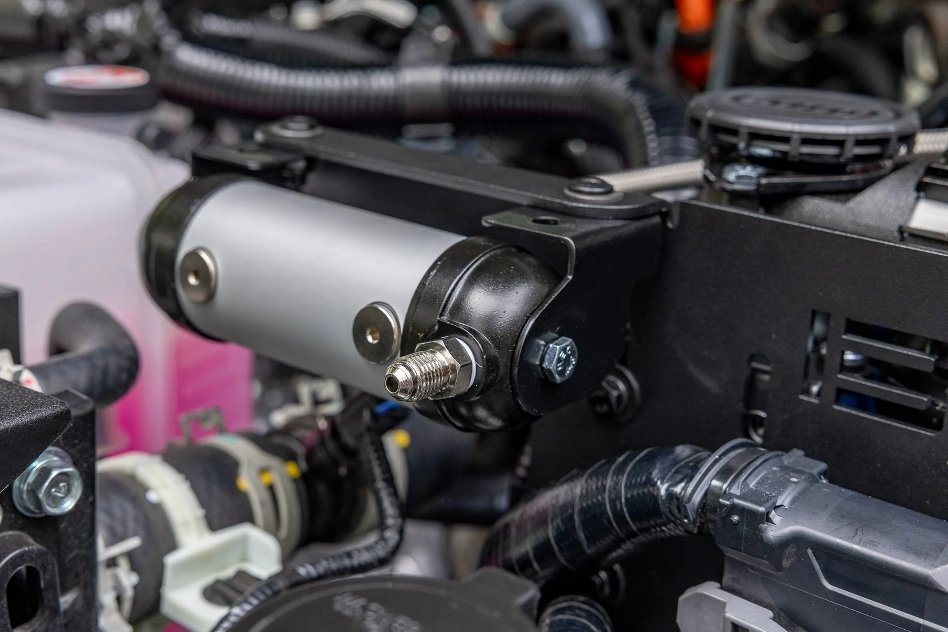

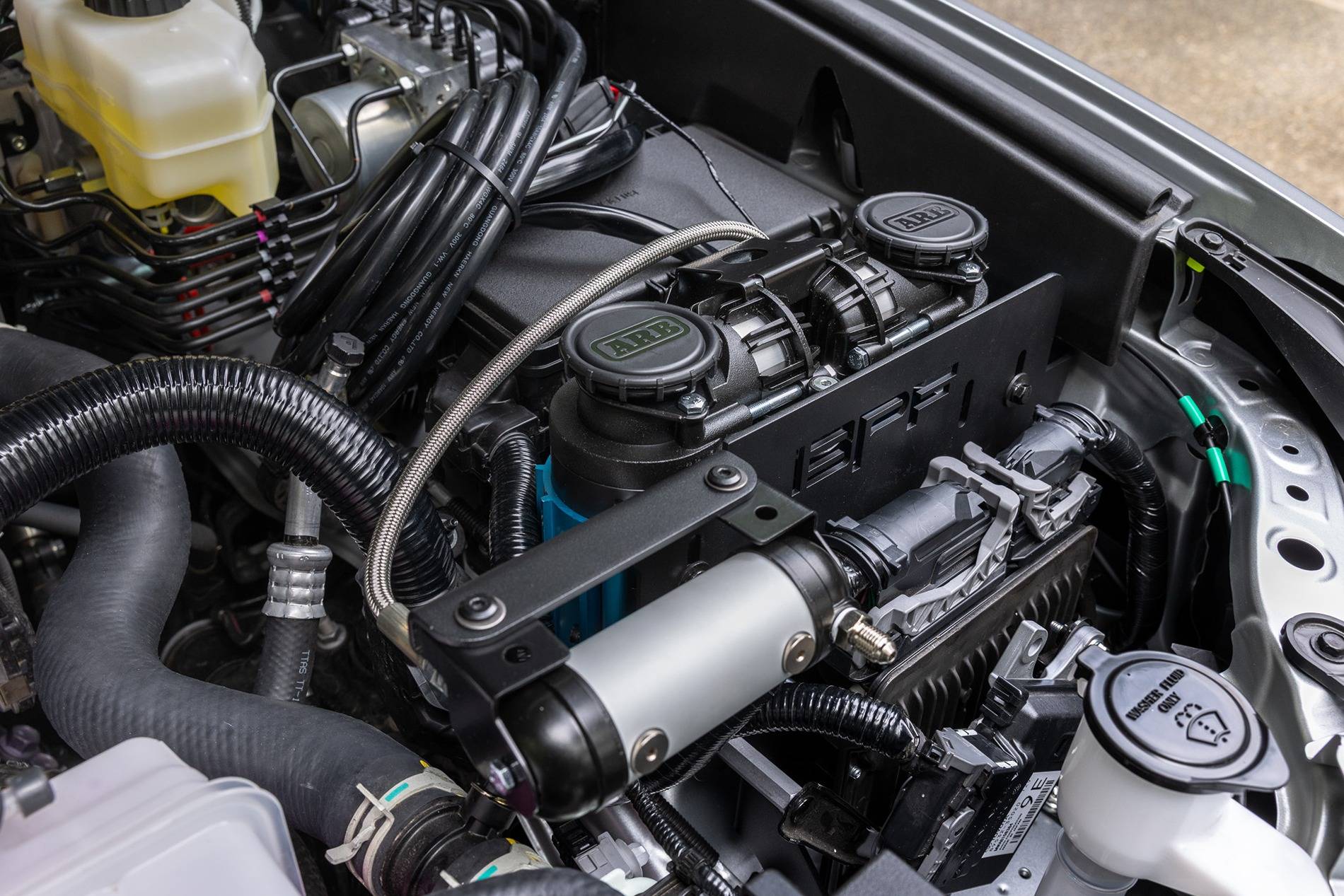

Next, I configured and mounted the ARB Manifold Kit on the ear off the left side of the BPF bracket:

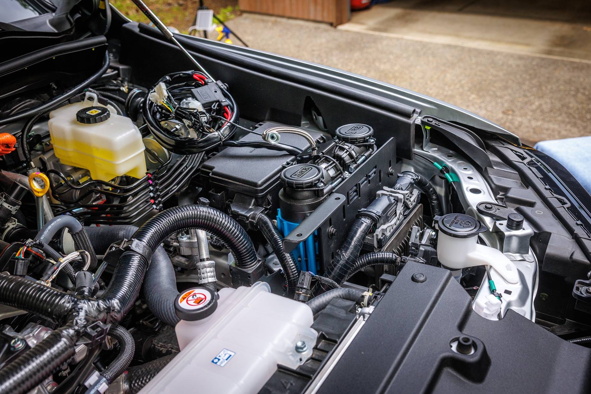

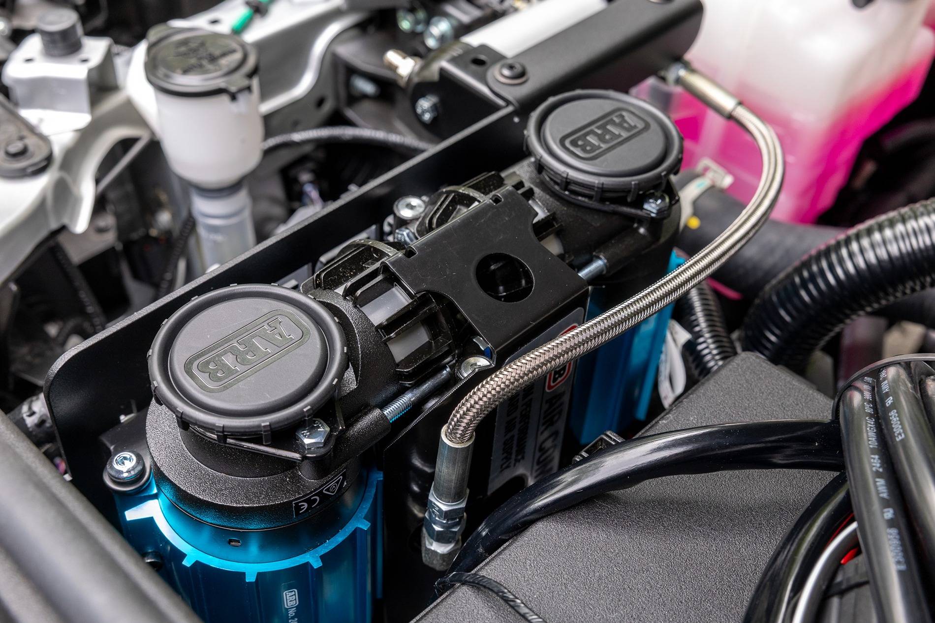

Here are a few more looks at the install:
