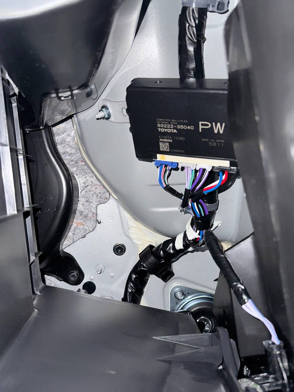

Two things I can tell you:
1. The space behind the right panel in the cargo area (above the wheel well) has a huge amount of empty space - like shoebox size! Here's a picture to show you what it looks like (top down view):

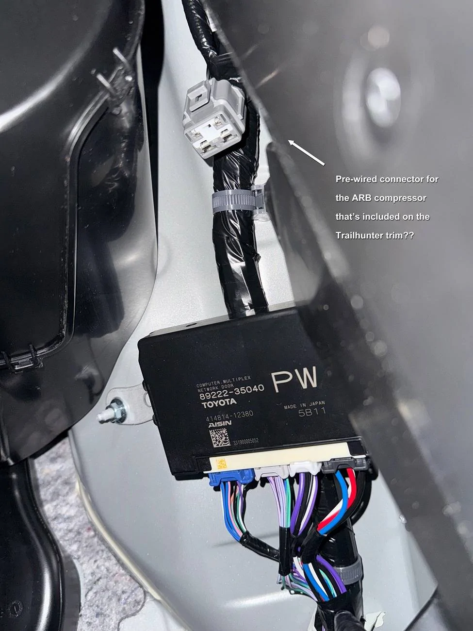

2. There appears to be an unused 4-pin connector stubbed into the wiring harness there, which is presumably intended to switch/power the ARB one that is included on the Trailhunter trim:

Thanks, i’ll take a look and see what’s possible.

The factory Air Compressor is not an ARB it is NSV
https://www.nsvauto.com/compressors (just incase you wanna know) it sits inside the rear passenger wheels well area!

Thanks for the link, Van.
It appears that NSV has integrated kits for several different vehicles (including LC). I just sent them a note via their web site asking if they might be creating a kit for 6G4R (since several of us are having a heck of a time confirming the correct Toyota part numbers and finding installation instructions.)
