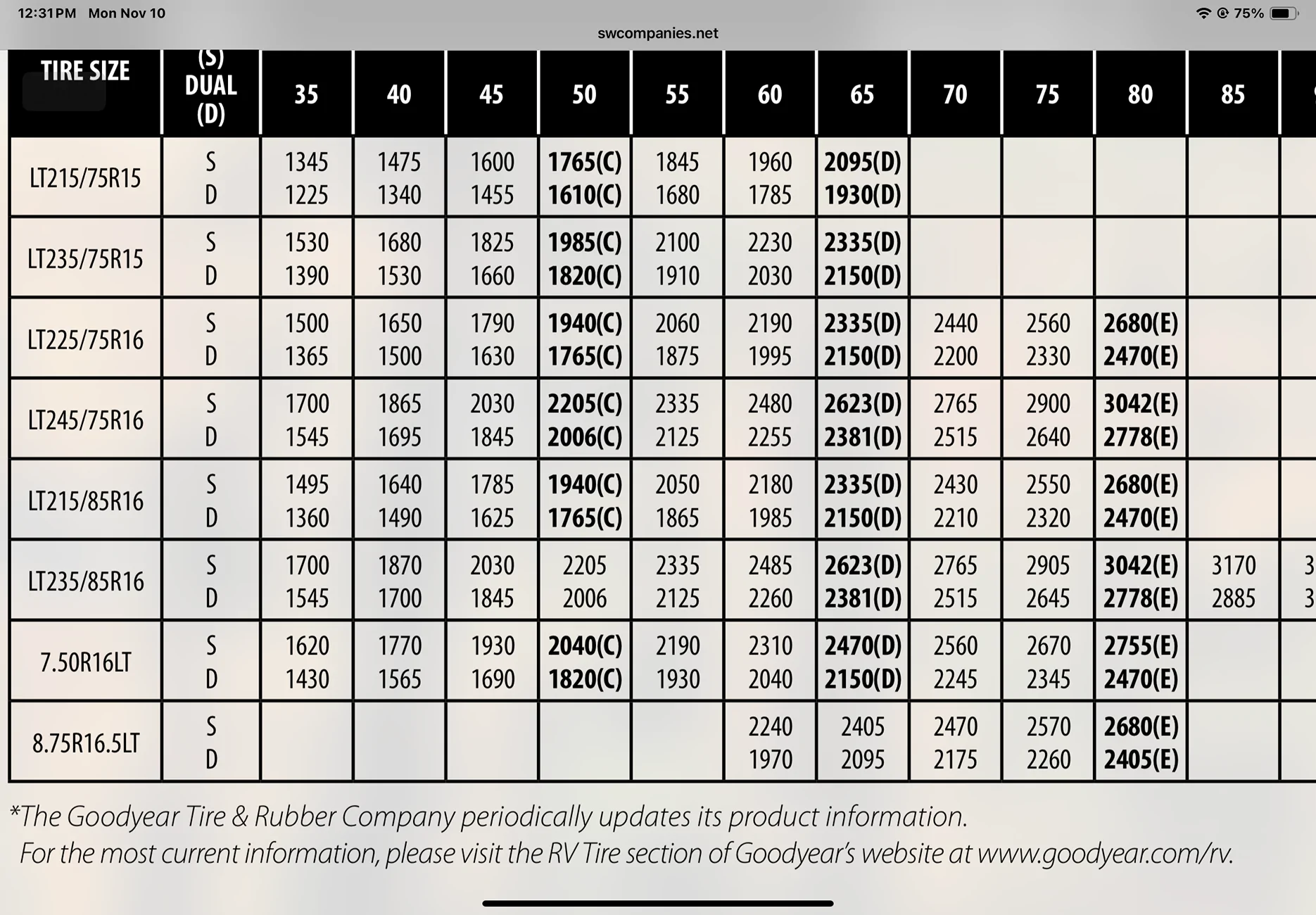

I run my SR5 at 33 psi, which is the factory recommended setting based upon the sticker located on the driver door jamb. I realize different trims could vary, but I don't understand why anyone would run higher than whatever is recommended. I just had the 5000 service completed and they set them at 36 psi and it was notably firmer and more jittery than the recommended 33 psi.
Van Solo
Van
May 20, 2025
596
396
Calgary / Canada
Once you change tire size and load ratings it is required to change the tire pressure.
It’s just facts, you can view it at
tiresize.com and view tire pressure calculator.
GetOut
Steve
Jul 31, 2025
OhiO
2025 4Runner SR5
True, but only if you actually need that higher load rating.

just remember folks. that chart is for NON "SL" tires.
personally i dont have a need for anything but a "SL" tire since i dont off road
GetOut
Steve
Jul 31, 2025
OhiO
2025 4Runner SR5
The chart is just an example that I happened to have available. There are inflation charts for just about every spec tire.
