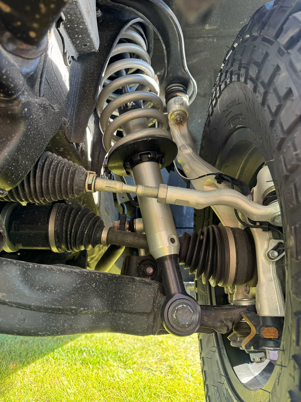

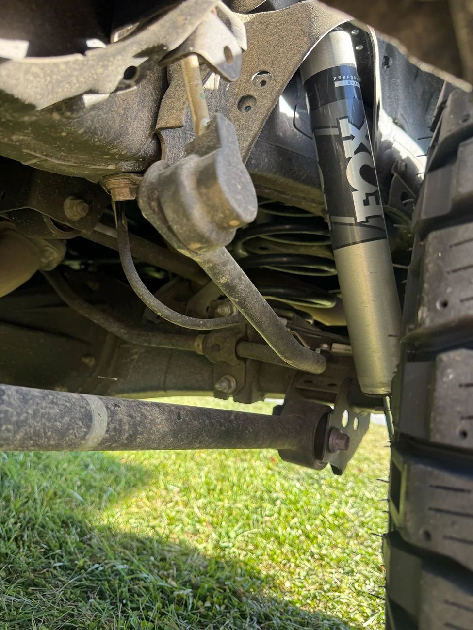

We are running Fox 2.0 Performance shocks on our 2025 SR5 and the ride is much better than the stock twin tubes. The stock shocks were very firm on compression and not firm enough on rebound, it almost drove more like a sports car and didn't handle rough road very well. We are based in Lincoln, NE and hard winters do a number on the roads out here. The kit we are running is 2" lift and we have Kenda RT 33x10.5r17 tires on. Even with the heavier tires the shocks made a big difference in ride quality. Fox has more shock offerings in the pipeline, including 2.5 Performance Elites w/ adjusters and some big 3.0 shocks. We do a lot of highway miles for tradeshows and events, the perk to the Fox 2.0 shocks is that they retain poly isolators which reduce NVH whereas the big "baller" shocks use spherical bearings at mounting points and transfer NVH to the chassis.

They are different than the TRD Pro shocks, that is correct. I haven't ridden in a new TRD Pro to be able to compare, but these 2.0's ride significantly better than the stock SR5 shocks. The SR5 stock shocks were pretty jarring.

Yessir, the front coilovers and rear shocks can be purchased without rear coils. The Fox coilovers are preset at 2" lift out of the box, you'd have to move the threadded collar down about 1" to bring them to stock-ish height.
