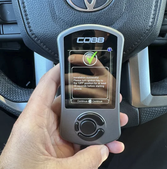

Installing the Cobb Accessport- Exciting day. I've been a Cobb Protuner for over 12 years and believe their software is among the best anywhere.

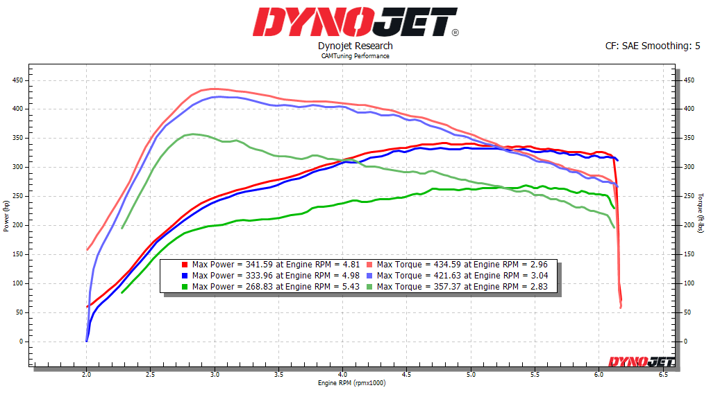

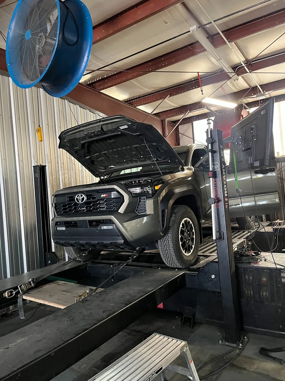

Dyno day! Did some pulls on the stock file locked in 4th gear on 91, and then started custom tuning, focusing first on the awful oem fueling curve. Then kept at it until I was happy with the curves. The gains were really impressive and the truck feels phenomenal. The shifting is so much better with the transmission tuned as well. I remapped the throttle to make it much more responsive, which really changes the driver experience.

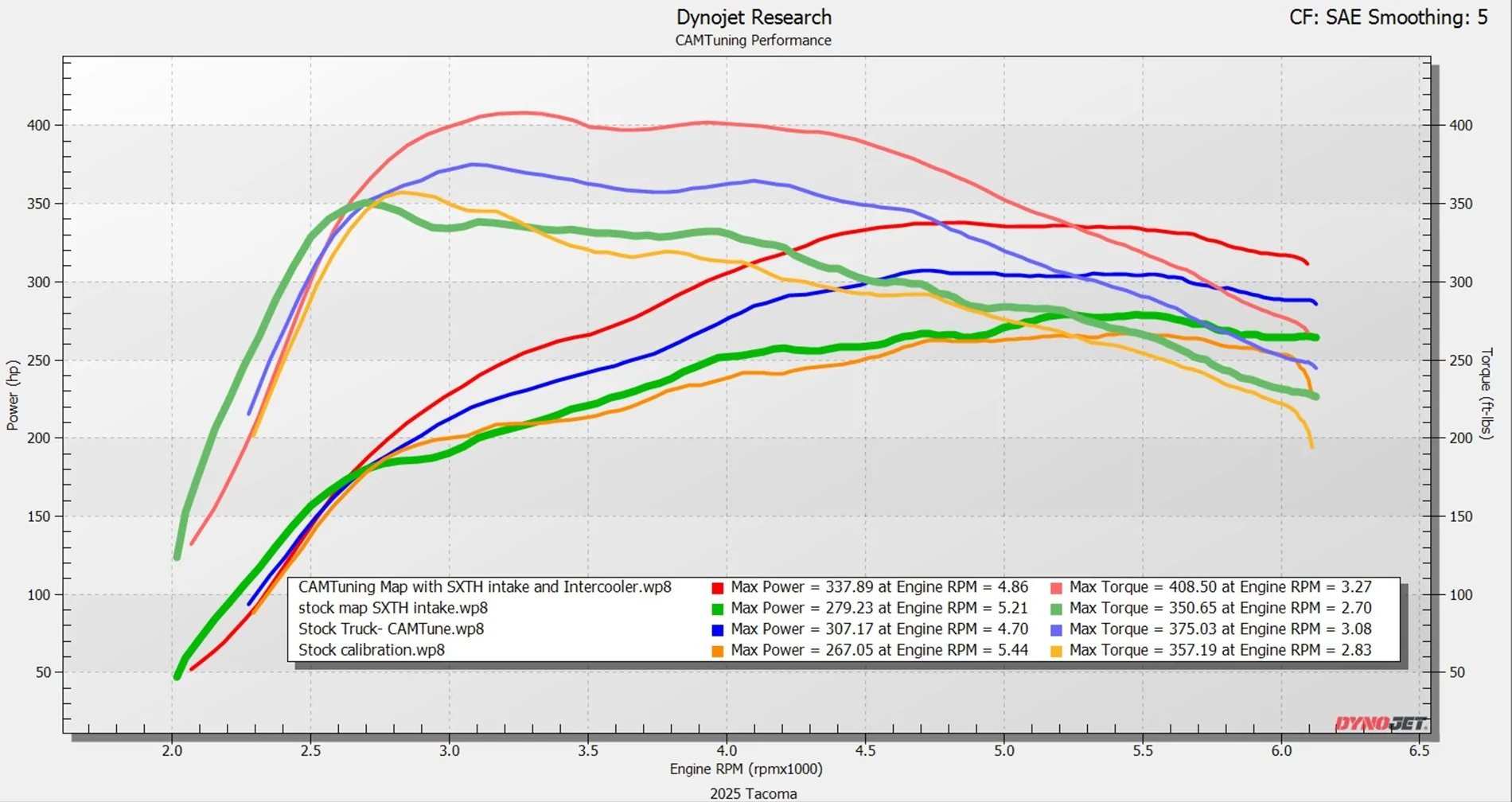

Further testing (I do a LOT of dyno pulls on this truck and now a few more local ones).
2025 2026 4runner 6th gen CAMTuning 2.4L Tuning development with Cobb Tuning Dyno Compilation 11_2_2025

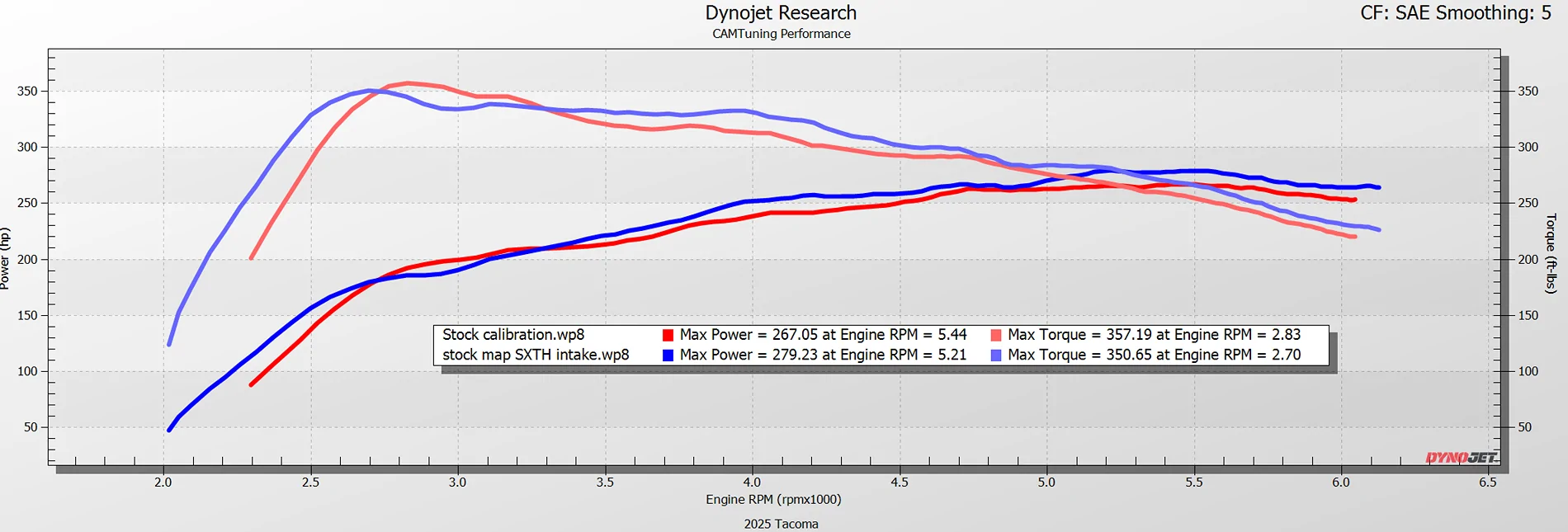

The stock tune looks flatter and happier without the intake.
Great observation. It did run a bit better before 3300 rpm, but then it makes more power and torque everywhere after that. You could argue that the intake pull has a flatter torque curve with less of a peak spike, especially from 3k-4k.
I pulled up just those 2 so it's easier to see. I truly appreciate when people take the time to look at the graphs, rather than just peak numbers. So many graphs have good peak numbers, but the curves tell a different story.

It’s time for a long overdue update on the truck.
I’m just over 11,000 miles now, and the platform has come a long way since my last post in November.
Since then, I installed a custom high-flow catted downpipe and went back through the calibration. I also re-baselined the truck in its current configuration with the SXTH Element intake and intercooler and the rest of the supporting mods. Green=stock 91, blue=all mods+stock downpipe, red=custom catted downpipe from FAFRace.
2025 2026 4runner 6th gen CAMTuning 2.4L Tuning development with Cobb Tuning downpipe vs stock vs stockdownpipe
As expected, gains are incremental at this stage. On 91 octane with the factory turbo, we’re realistically near the airflow ceiling. At this point it’s less about chasing peak numbers and more about improving how efficiently and consistently the system works:
  • Smoother torque curve
  • Quicker, more controlled boost response
  • Better repeatability as temps climb
  • Stronger midrange without artificial spikes
Every hardware change gets logged, validated, and adjusted properly. The truck continues to serve as my long-term development vehicle and my daily driver, which is intentional — real miles, real conditions, real data.
And for those wondering what’s next — the upgraded turbo is already in hand and ready to go on. The factory unit has shown us what it can do. Now it’s time to raise the ceiling.
