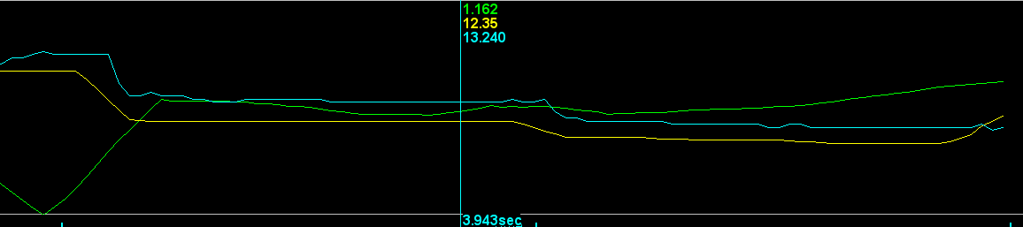

Let's review some real data from customer vehicles.
Right after install:
LTFT near zero
Reported airflow may look lower, because the way the air is crossing the MAF has changed.
Actual AFR is leaner than commanded
Fuel Trims (green) 1-3%, but AF desired (yellow) is richer than actual (blue)

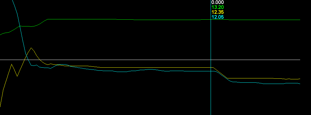

After some drive time:
Total fuel trims (mostly long term in this case) goes positive (adding fuel)
Commanded AFR and actual AFR line back up
“Extra power” goes away
Fuel trims (green) ~13%, but AF desired (yellow) and actual (blue) are well matched:

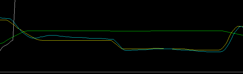

Properly calibrated fueling *after revision based on data logs- this is a real customer of mine, tuned remotely.
Fuel trims near 2% (green), AF desired (yellow) and actual (blue) well matched:
2025 2026 4runner 6th gen Tuning Facts - Understand Your 4Runner Like We Do at CAMTuning 1774450349168-7t
This is why airflow comparisons between intakes can show misleading data. If the MAF scaling isn’t correct, you’re not comparing airflow—you’re comparing sensor interpretation, and the engine running conditions are not a direct comparison.
Real gains from an intake come from reducing restriction pre turbo and improving how easily the turbo can move air. But if you see an immediate jump in performance without calibration changes, you need to wonder whether it’s actual airflow… or just a measurement shift.
Here's the key takeaway: airflow data only means something if the MAF is calibrated correctly.
