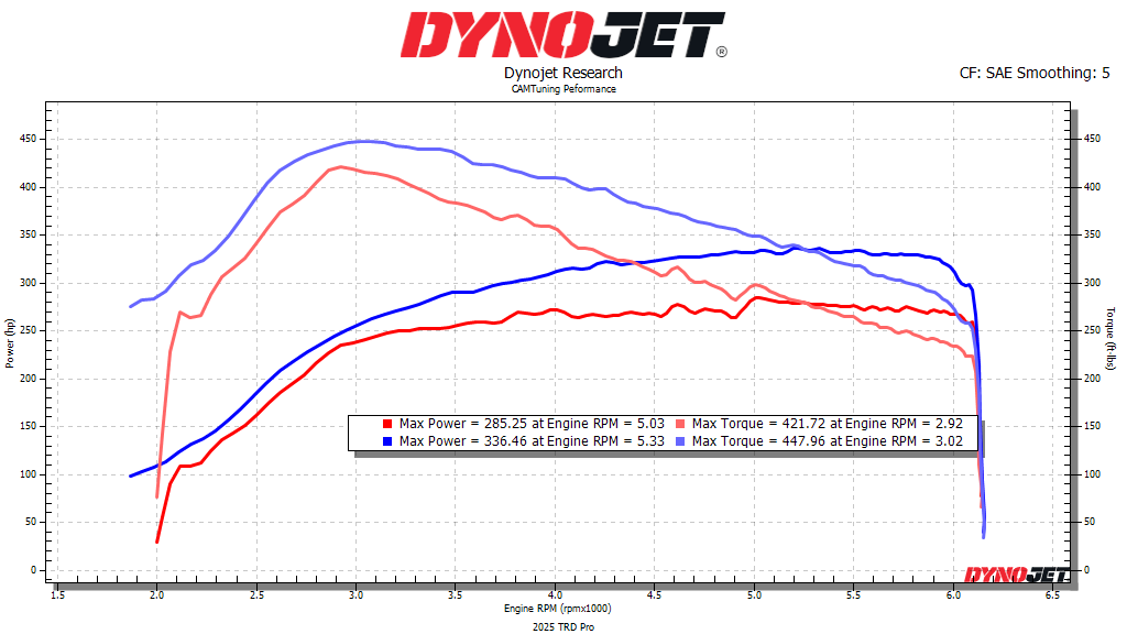

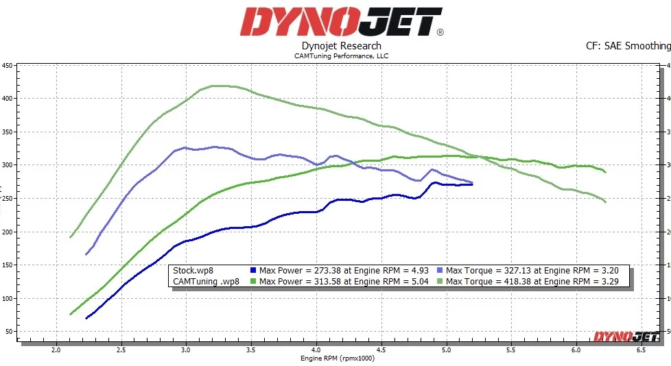

Yes, I’ve tuned my truck in completely stock form, and we’ve also dyno tuned many stock trucks (hybrid, and non, both on our dynojet and another shops hub dyno) on 91. So I’m not just stacking parts and guessing — I’ve seen what these do in factory trim.
On a fully stock truck, 91 octane, safe calibration, you’re realistically looking in that ~310–325whp range depending on dyno type and conditions. The factory hardware is actually pretty capable within that window.
Here's a our development truck, completely stock, non hybrid during early development.
2025 2026 4runner 6th gen CAMTuning 2.4L Tuning development with Cobb Tuning stock vs tuned (no mods)

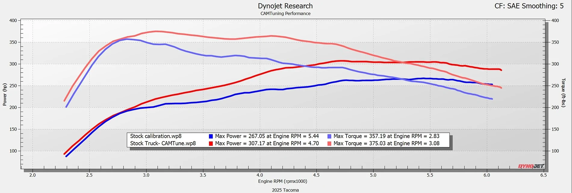

Here's an example of 2 different stock hybrid Tacoma's (Sorry, no 4Runners, but same/same) with before and after results on 91. The difference of ~10whp in these on both baseline and tuned power is due to larger tire size on the 2nd graph (35") but the delta is nearly identical.
2025 2026 4runner 6th gen CAMTuning 2.4L Tuning development with Cobb Tuning 2025 trdpro
2025 2026 4runner 6th gen CAMTuning 2.4L Tuning development with Cobb Tuning CAMTuning Hybrid stock vs tuned

The estimated HP that I was provided with the SXTH CAI and a tune was 315-317, and those dyno numbers posted by @CAMTuning line right up with that.

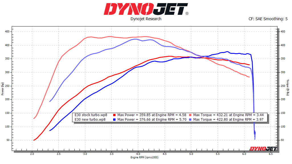

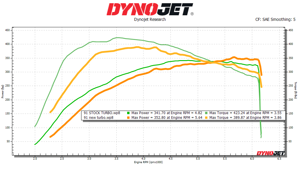

New turbo went in the truck this last weekend. Install was surprisingly easy compared to other platforms I've worked on. The shared oil feed/return line is nice. I did some road tuning on it right away, and performance was not a huge improvement.
I got it on the dyno to verify and did a total of 30 dyno runs dialing in a smooth boost curve (~21 psi tapering to 19-20)
These 91 octane runs are apples-to-apples with the previous stock turbo setup.
The new turbo does carry boost a little better up top, but the tradeoff was a noticeable loss in low-end response and only about an 11whp peak improvement over the stock turbo configuration. There's always a trade off in low end when you go to a larger turbo, but typically it comes with the reward of higher hp and torque in other regions of the powerband.
For context, the E30 comparison isn’t apples-to-apples because the earlier run was on the stock downpipe with the stock turbo, while the current setup is new turbo + high flow downpipe.
I didn’t design or spec this turbo myself — I worked with a turbo builder to try something different on the platform. That’s part of development. Sometimes the data confirms an improvement, and sometimes it shows the OEM setup was already very well matched.
My suspicion right now is that the turbine side may simply be a bit too large for this engine’s displacement and operating range, which hurts response and area under the curve even if it carries boost slightly better up top.
I’m obviously a little disappointed in the performance, but I’m glad we did the testing before ever promoting a turbo upgrade. This is exactly why I test combinations on my own truck before recommending them to customers.
I also think it’s important that when new hardware gets introduced on these trucks, real dyno data is shared so people can see exactly what the changes are.
Real development means putting the parts on the truck, running the tests, and sharing the results — good or bad.
Stock turbo will be back on within the next couple of days, and I'll decide what direction to go next.
Dyno charts below.
91 on stock turbo vs new turbo
2025 2026 4runner 6th gen CAMTuning 2.4L Tuning development with Cobb Tuning CAM NEW TURBO 91
E30 on stock turbo and new turbo (stock turbo was still on the stock downpipe). With more time I could have smoothed this torque curve, but the gains were going to be underwhelming so I just stopped here.
2025 2026 4runner 6th gen CAMTuning 2.4L Tuning development with Cobb Tuning E30 NEW TURBO OLD TURBO

Hmmm, agreed on disappointment for gains vs. cost on this custom turbo.
I will be watching the FAFR big turbo thread to see what that does with great expectations.

This is a one - off turbo I had a reputable turbo maker build for me. It took almost 4 months, even though I was promised a few weeks. This turbo is not available anywhere on the market.
Good and bad update though, depending on how you look at it.
While reinstalling the stock turbo today I discovered the upgraded turbo already has compressor wheel contact with the housing and noticeable shaft play after less than 20 miles of use.
That obviously shouldn’t happen, and it likely means the turbo wasn’t operating correctly during the dyno testing. For now the stock turbo is going back on while I sort this out with the manufacturer.
Hopefully this turbo builder can fix it- but this is the cost of development.

That contact could certainly explain the difference in response and lack of larger torque and HP gains
I feel your pain. Pioneering any engine and turbo program is never cheap or easy, even when parts are good.
