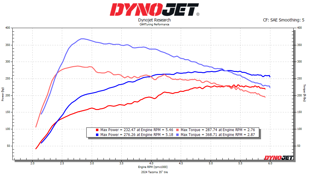

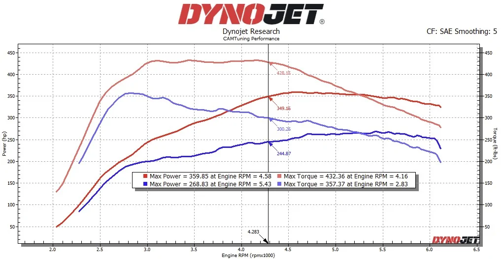

Session 6: Rotating Weight: Why Bigger Tires Feel Like Lost Power (and How Tuning Gets It Back)
Let’s take a quick break from sensors, trims, and tables and talk about something you can feel immediately behind the wheel: rotating weight.
Earlier this week I had a Tacoma on the dyno running significantly heavier tire and wheel combo than stock. No engine changes. Same truck. Same dyno. The only variable was rotating mass.
(These tires are ~65lbs each, on factory wheels)
The baseline result was exactly what you’d expect:
  • Lower measured power
  • Slower acceleration
  • A drivetrain that had to work harder to do the same job
But here’s the part most people miss.
That “lost power” isn’t gone — it’s being used.
Why rotating weight matters more than vehicle weight
Rotating mass (tires, wheels, driveshafts) doesn’t just need to be moved forward — it has to be spun. That means:
  • More torque required to accelerate
  • More load on the engine and transmission
  • Slower rate of RPM change
  • Heavier demand during shifts
This is why trucks often feel:
  • Sluggish after tire upgrades
  • Lazy to downshift
  • Less responsive at part throttle
What the dyno showed
Despite the heavier setup, once calibrated correctly:
  • Torque gains were equal to—or better than—stock-tire trucks
  • Throttle response improved noticeably
  • The power curve became smoother and more usable
2025 2026 4runner 6th gen Tuning Facts - Understand Your 4Runner Like We Do at CAMTuning 2024 non  hybrid tacoma 35i
The tune didn’t “add magic horsepower.”
It reclaimed efficiency that the stock calibration wasn’t designed to preserve with heavier rotating mass.
OEM calibrations are built for factory tires.
Once you change that equation, the strategy needs to change too.
The takeaway
Big tires don’t ruin performance — unaddressed calibration does.
When torque delivery, throttle behavior, and shift strategy are aligned for the added rotating mass, the truck stops feeling heavy and starts feeling intentional again.
