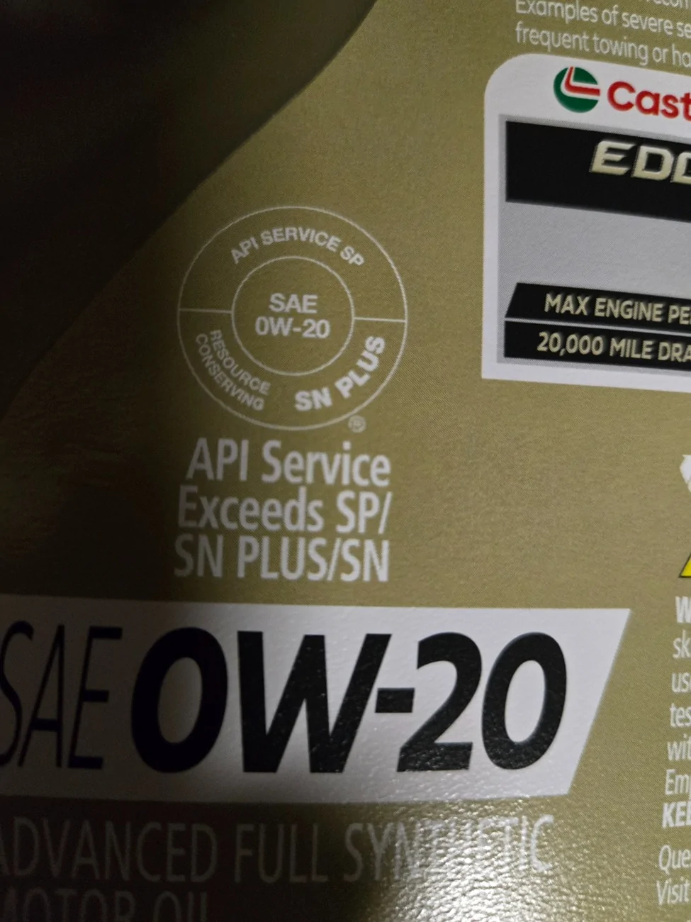

Yep,
I fall into the same practices with new cars. I have just under 600 miles on mine and have already done one oc. Interestingly right after the fresh oil was put in the engine liked it significantly and MPG went up.
I did not see anything out of the ordinary as far as debris that would be alarming other than some very very slight glitter.
Probably will be doing a second OC at around 1K then fall into the 3K oci, These are so simple to do an OC, can do it in less than 45 minutes.
First OC I used Kirkland 020 full synthetic, the next OC I'll jump over to Castrol 020.
I've tried many many high grade brands of oil over the years and find that if they're certified and have the API badge you cannot go wrong.
Just my two cents.
