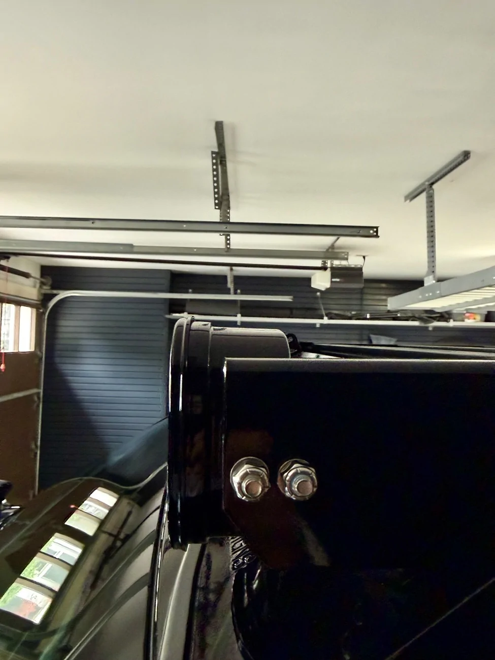

The Squadron lights add about 1/3” with their covers on.
On a plus note, I’m told that the moonroof will still clear to open, but I haven’t had the courage to try it yet. 🤭
Opens just fine. Tilt goes between bars and the fully open the glass goes under roof not over.

I am curious how much the vehicle weights with all that
They claim its 1.75 I can tell you that the rack is lower than the top of the shark fin antenna. So if you can get it with the antenna you can with the roof rack. Now adding any lights to that can make it taller depending on the light bar
Thats good to know

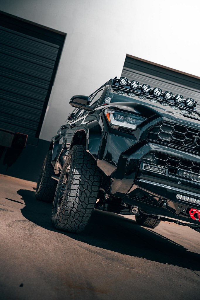

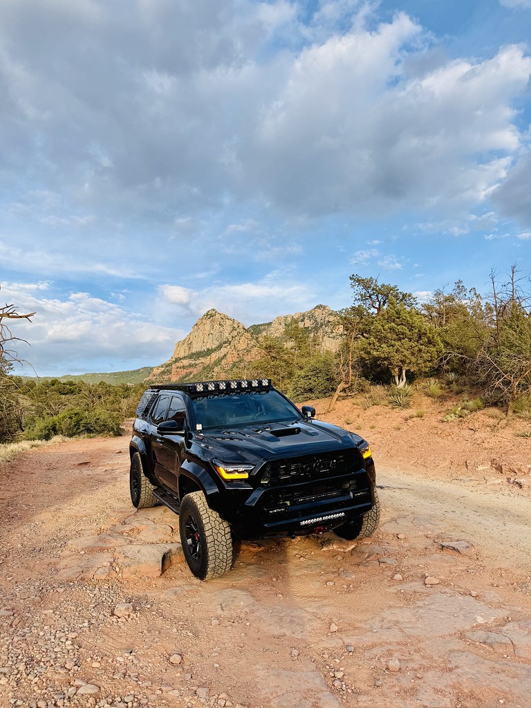

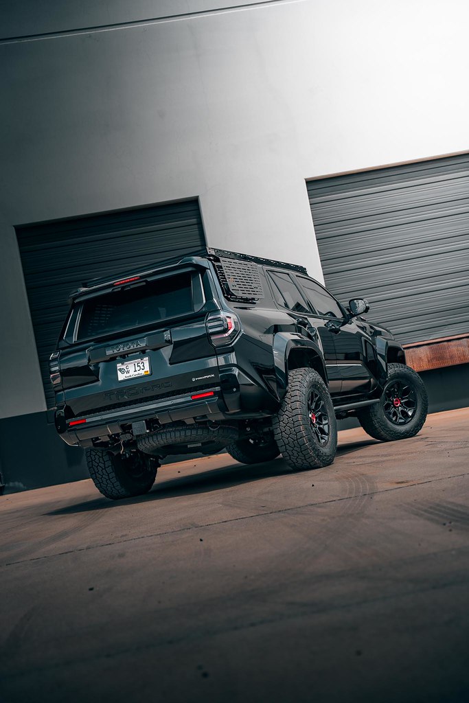

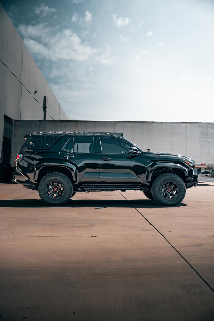

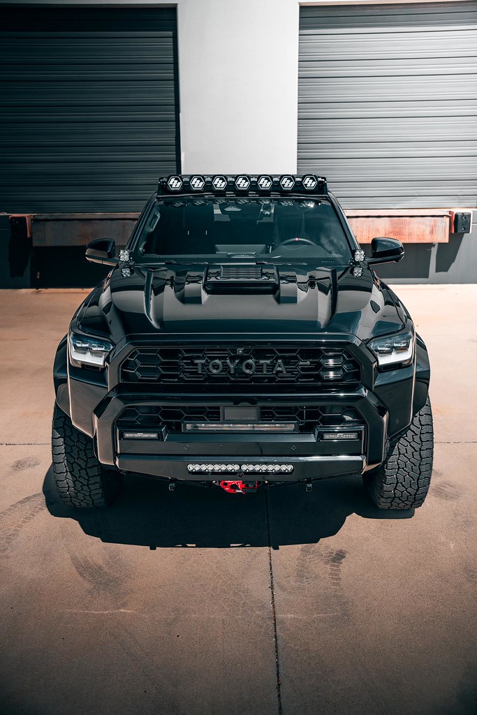

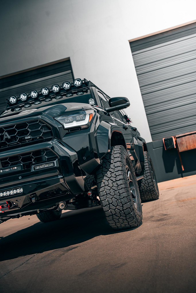

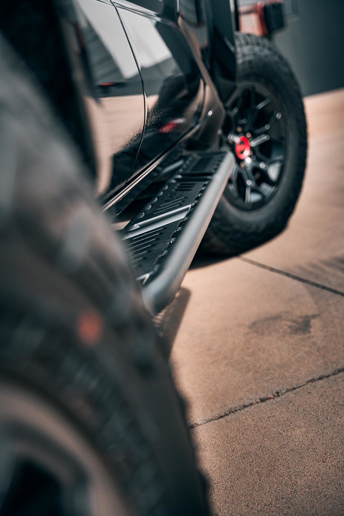

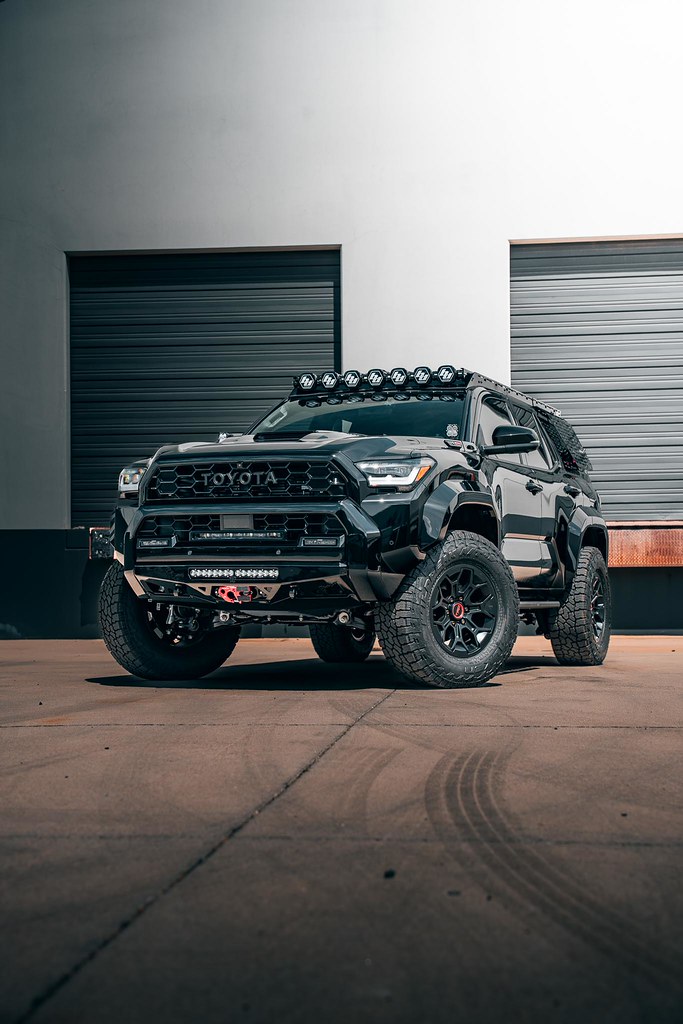

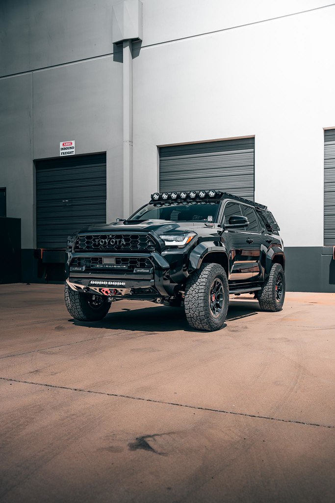

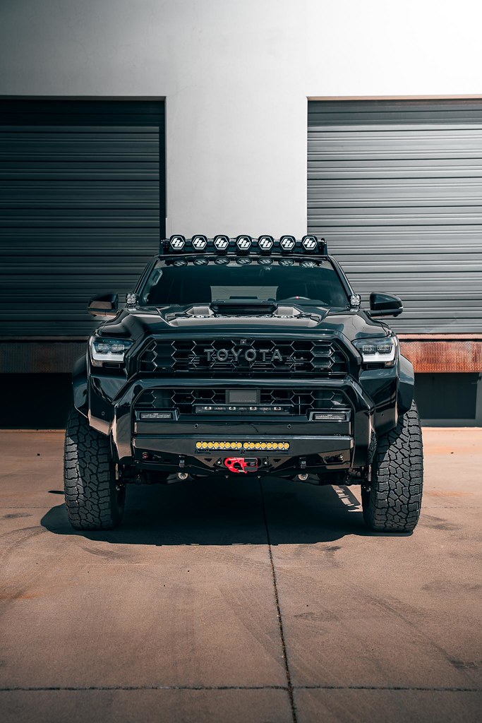

Hi :)
I got my truck delivered a few months ago, and at first I was only planning to put a little bigger rubber on it and call it a day. But as usual, and partly because all you here are a terrible/awesome influence, things quickly escalated to a full build. Keep in mind that this is my first ever Toyota of any kind so the learning curve was very steep, and so in addition to all the info on tis forum I reached out to Wescott Designs to guide me. My wife an I were going to spend the Month of May in Sedona AZ anyway so I shipped my truck to them in Phoenix ahead of time and picked it up last week when I landed, so the timing and logistics fell perfectly in place.
The vision for the truck was to strike a balance between high off road capability but also to be able to be used as a daily driver, so I didn't want to go overboard with suspension mods. Driving it both and off road for the last week I think we hit the sweet spot of the compromise, so I'm super happy with it. I also wanted to do something a little different given that the truck is black so I had them paint all the accessories (except rock sliders) gloss black, which helps my ocd. I especially like the Rago bumper because it looks as if it could be OEM to me. Thanks to @papadop88 for that inspiration and also for helping me figure a couple of other things out.
Here's the list of mods (wrap and tires were done before I sent it to WD):
- Full Xpel wrap/Full Xpel ceramic coating/front tint to match rear/windshield PPF
- 285/70/18 Falken Wildpeak A/T4W
- 1” Spidertrax black wheel spacers
- Wescott Designs Lo-Pro Roof Rack (gloss black)
- Baja Designs XL Pro Linkable LED Light Bar (for roof rack)
- Wescott Designs Ditch Light Brackets
- Baja Designs Squadron Pro Black LEDDriving/Combo Light Pods
- Rago Fabrication Center Mount Winch Front Bumper (gloss black)
- Rago Fabrication SkidPlate for Center Mount Front Bumper
- Baja Designs 20" Sport Light Bar (in Rago bumper)
- Warn VR Evo 10-S Winch
- Epic Hawse Fairlead
- Factor 55 UltraHook
- Wescott Design Molle Panels (gloss black)
- Wescott Designs Kickout Sliders
- Wescott Designs Preload Lift Kit
Pics and the associated IG post:
I think I'm done messing with it for now, the only other thing I might do in the near future is get some aftermarket 0 offset 18s to get rid of the spacers.
Hope you guys like it. :)

Eyeballing it from memory they're about the same height, but a quick call to Wescott (I dealt with Tyler) will give you a definitive answer. (y)
The height of the Low Pro Rack is 1.75" or slightly lower than the aero antenna fin on the roof.
Hope this helps
