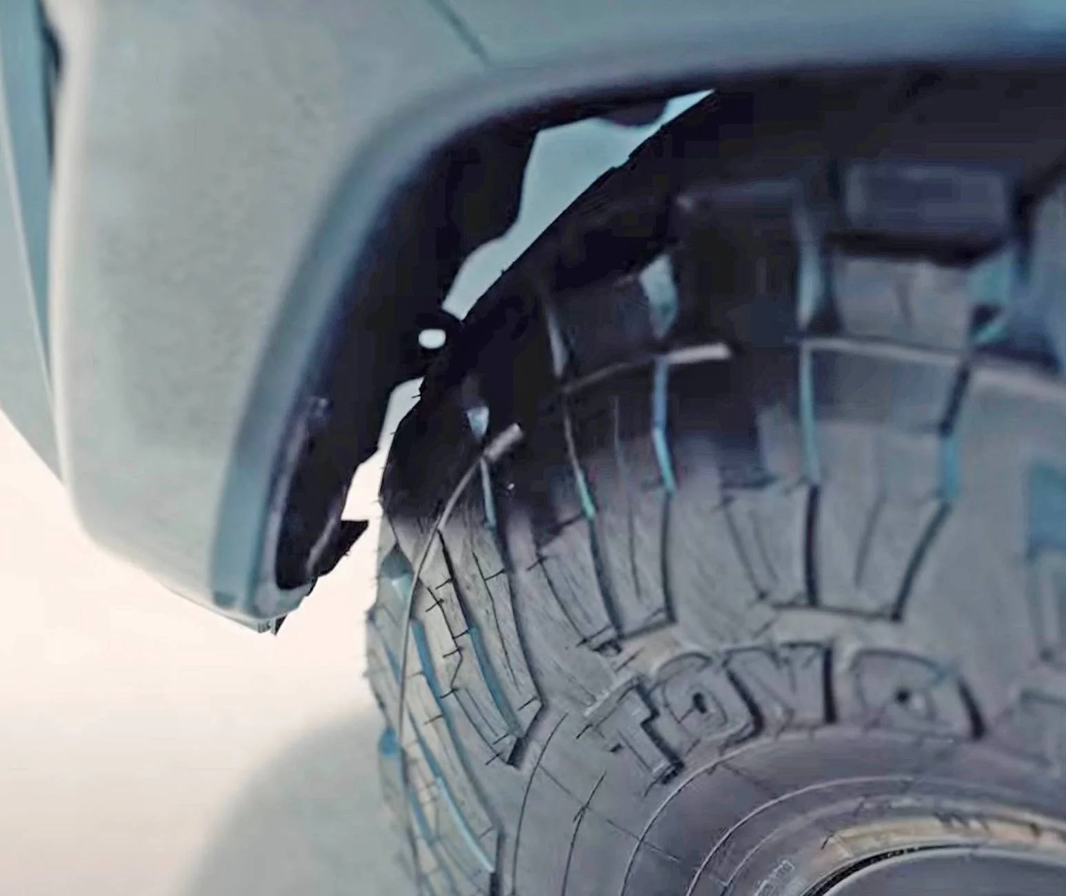

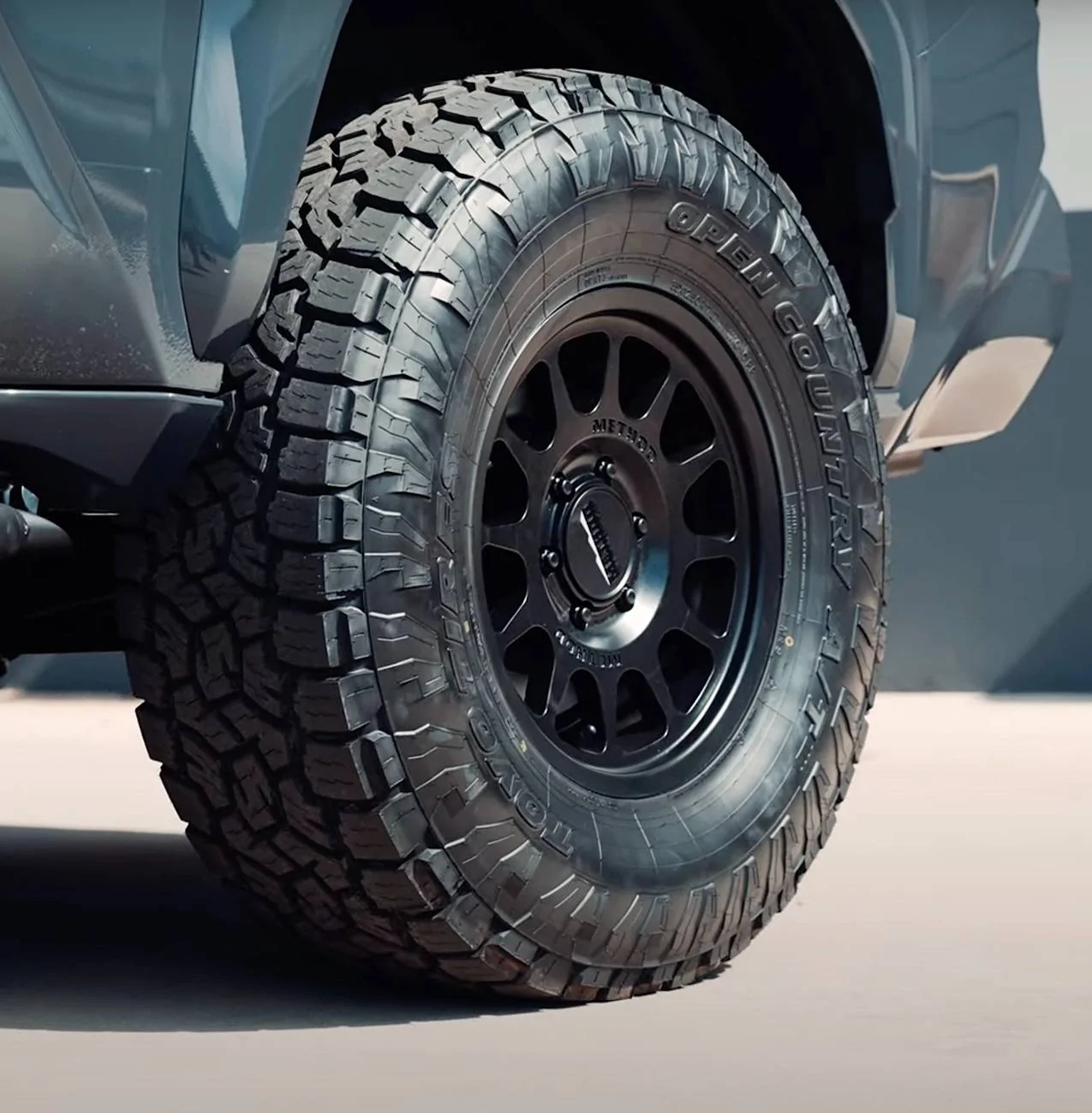

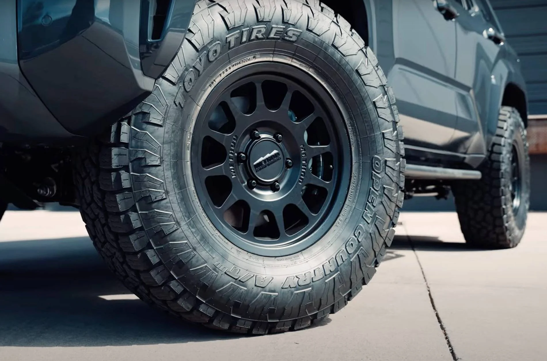

  • ? Optimized Wheels and Tires: Equipped with Method 703 wheels (17x8 +35 offset) and Toyo Open Country AT3 35x12.5R17 tires. Tire pressure sweet spot found between 31–33 PSI for comfort.

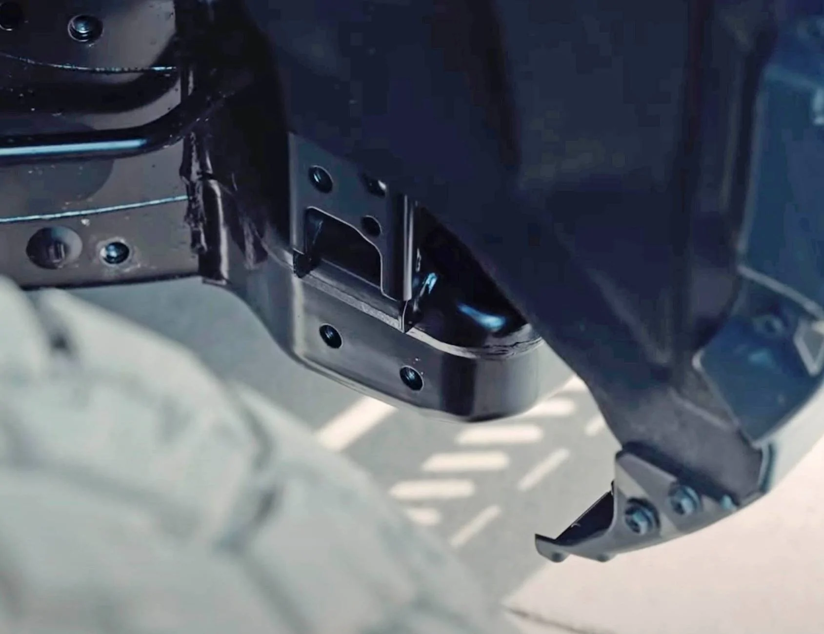

  • ? Precision Modifications: Includes modifications like liner push, clip trimming, and removal of the safety mount to prevent tire rubbing.

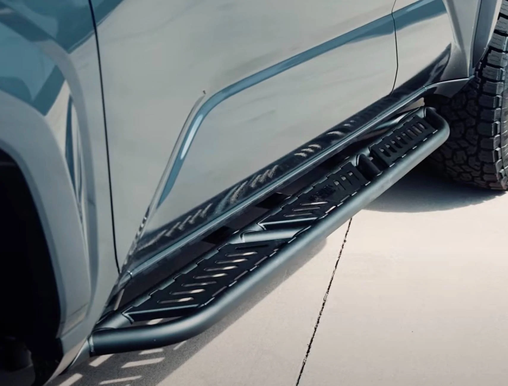

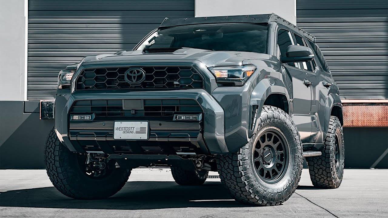

  • ? High-Quality Rock Sliders: No-kickout MIG-welded rock sliders with signature top plates for durability and aesthetic appeal.

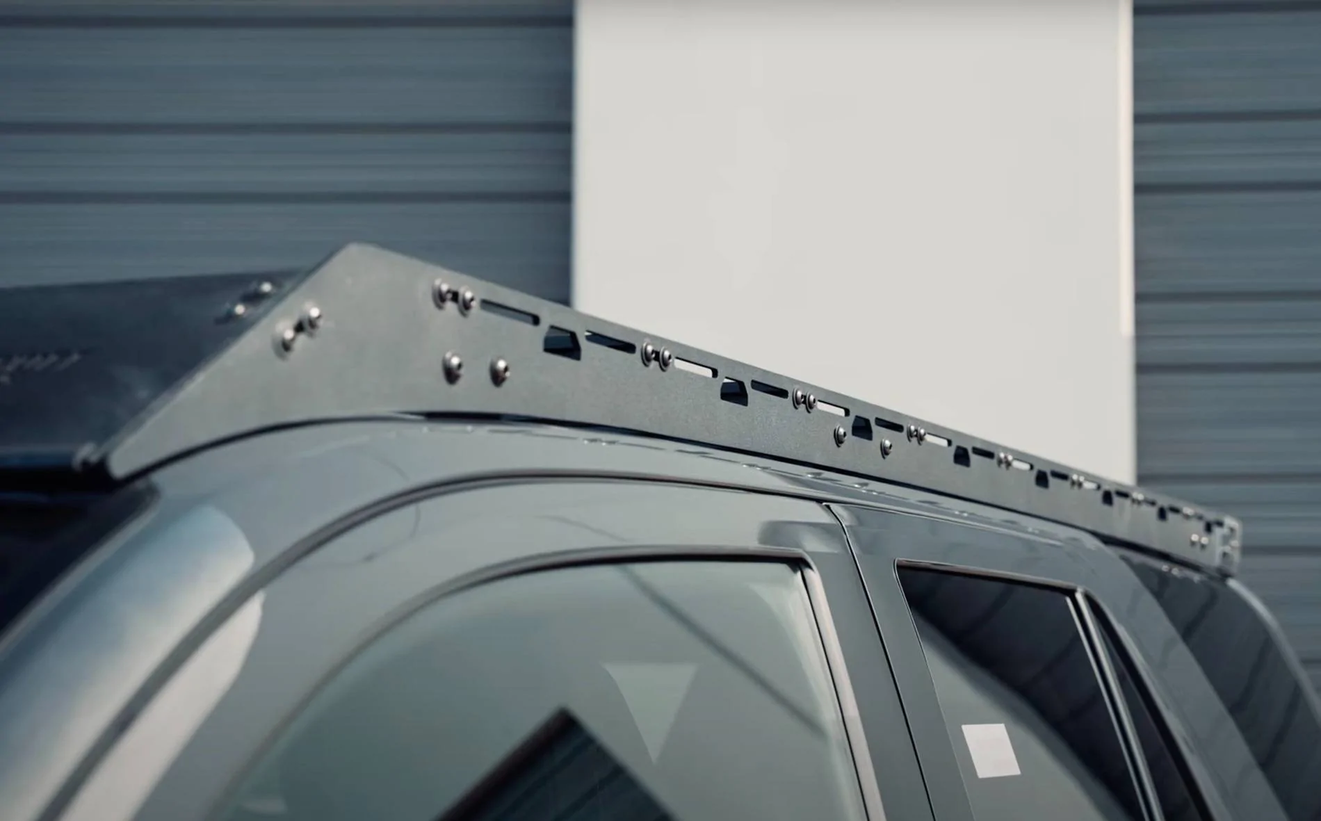

  • ? Ultra Low Profile Roof Rack: A low-profile roof rack designed to blend seamlessly with the vehicle’s lines, reducing wind noise and enhancing OEM appearance.
  • ? Unique Touches: Features such as a stainless steel bottle opener and detailed design elements show attention to craftsmanship.
  • ? Striking Visual Impact: The presenter believes this is the best-looking color, emphasizing how much better the vehicle looks when lifted and seen in person.
Wheels & Tires Specs
  • 17x8 +35 offset wheels and 35x12.5R17 tires represent a common yet optimal aftermarket upgrade for off-road capability.
  • 31–33 PSI tire pressure range is noted as the ideal for balancing ride quality and tire wear without using heavy-duty "E-load" tires.

Preload lift kit?
Likely. Westcott has used their Preload Collar Lift Kit in all their builds so far. If they went with a new lift kit here, they would have mentioned it.
