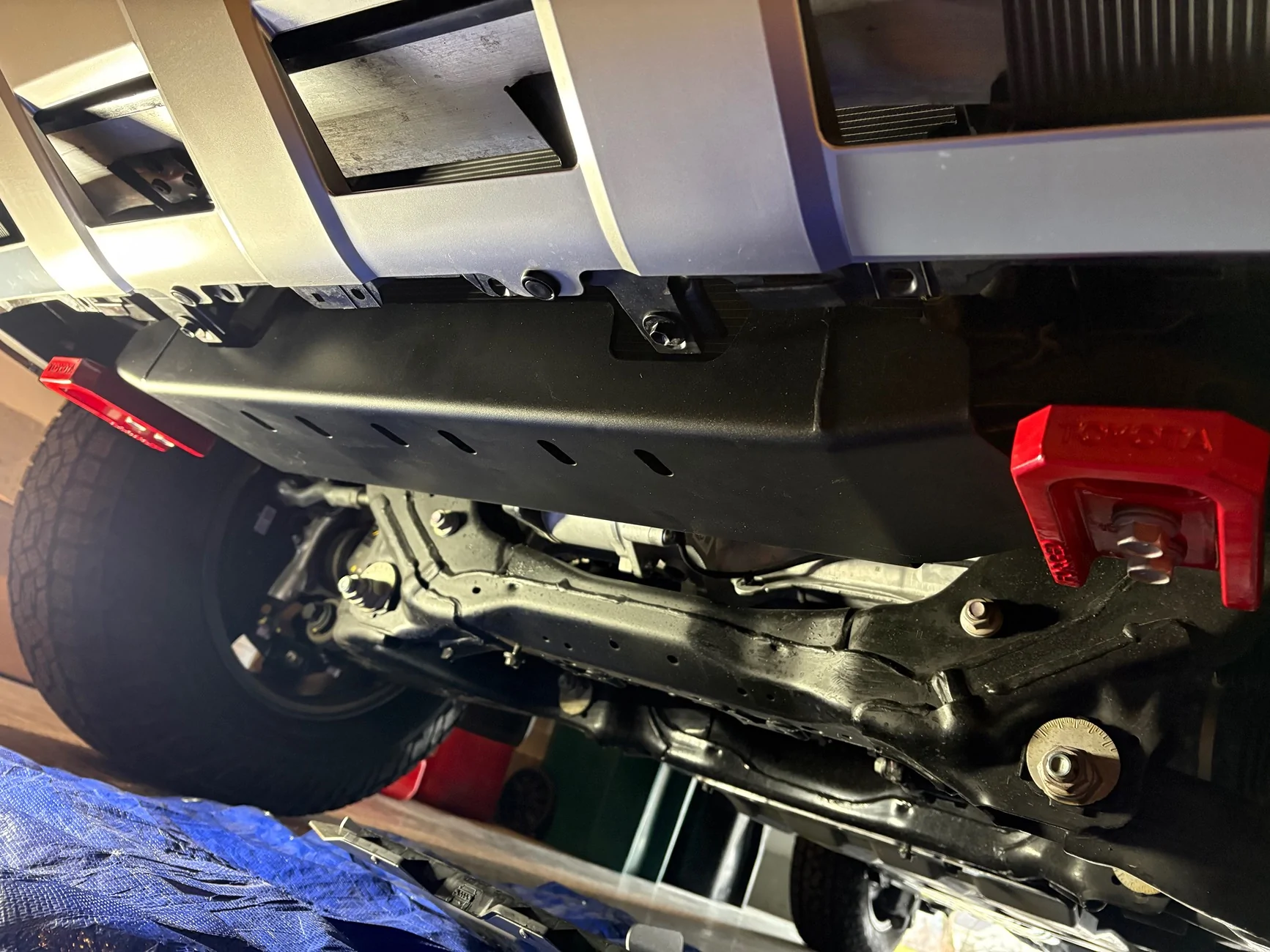

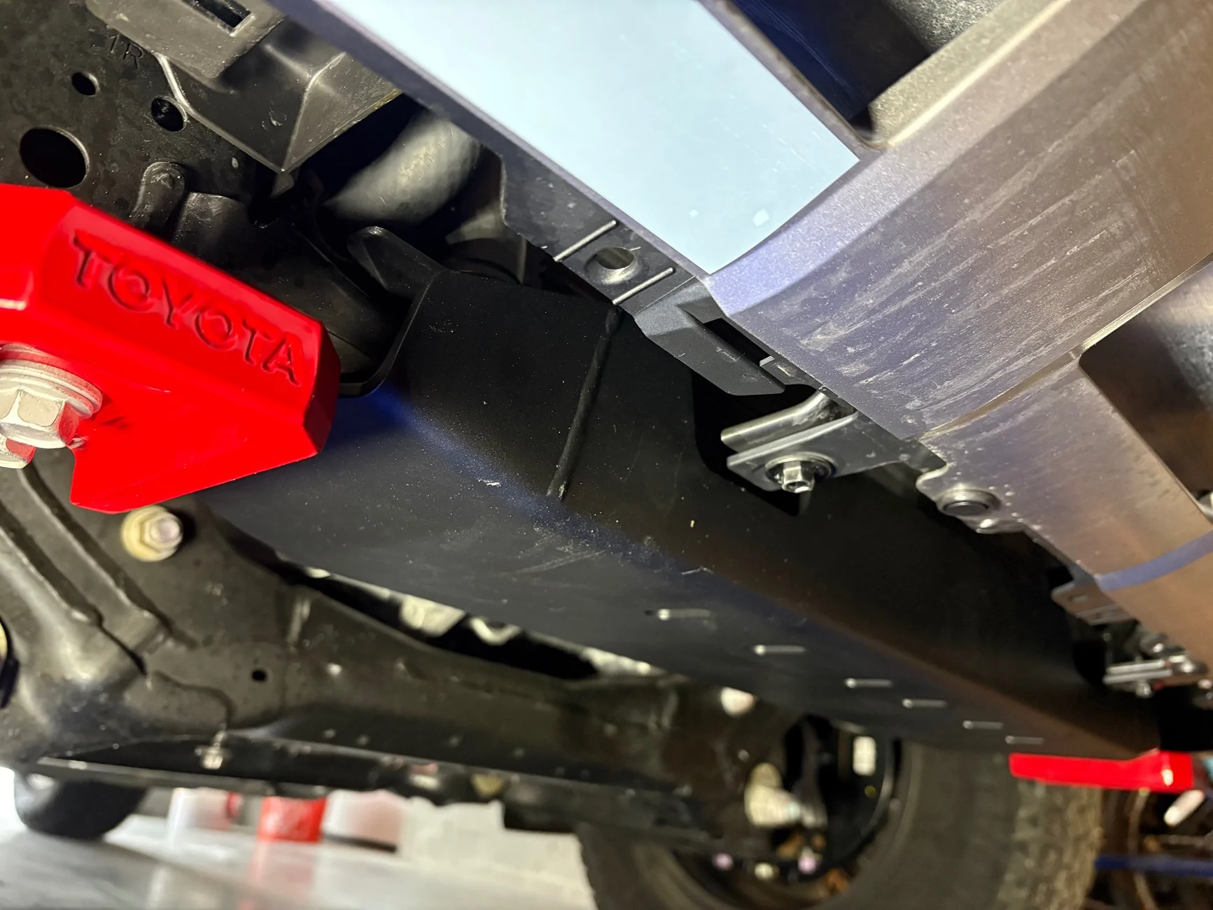

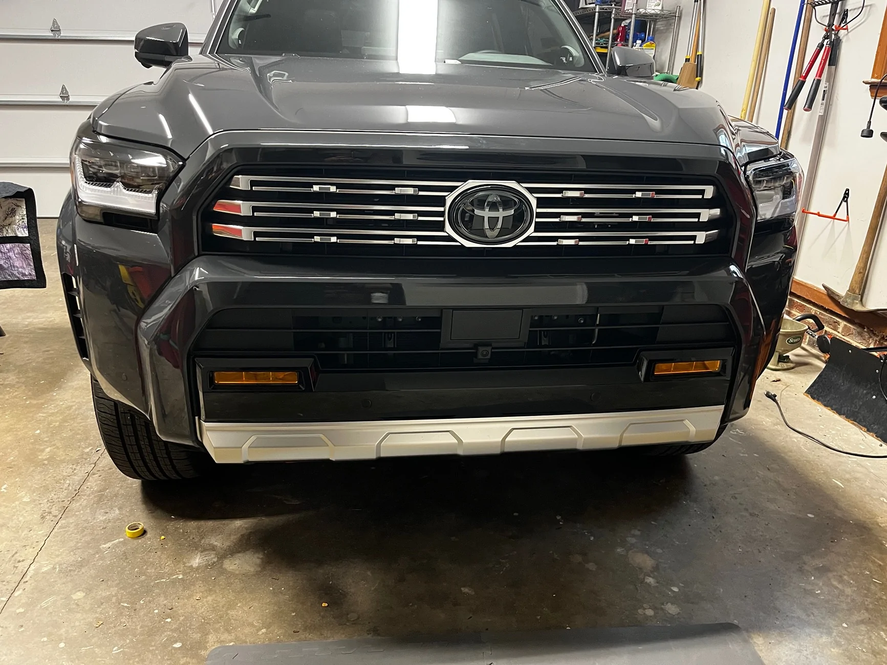

Since I already had the front skid dropped to install the Slee radiator crossmember reinforcement, I went ahead and did my second oil change at 1,600 miles after lunch. While waiting for the oil to drain, installed the rear tow hook.

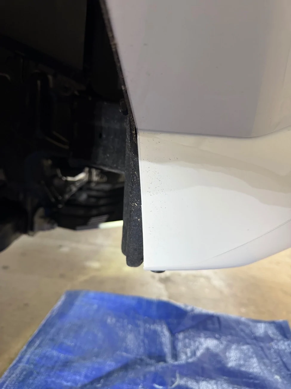

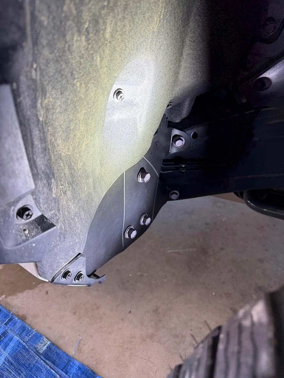

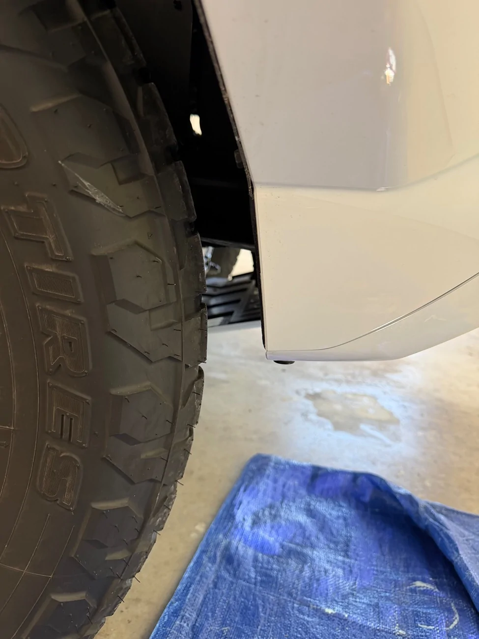

ARK Crash Bracket Delete and Front Fender Liner Tuck on TH.
Waiting on back orders for bumper, winch and rocker rails so trying to get the TH prepared for upgrades.
ARK Crash Bracket Delete cleaned up rear of front wheel well. Super easy with included instructions. Quality product - probably going to replace more of the OEM liner with their splash guards.
Front liner protruded 3/4 - 1” into wheel well. I was hitting it with full lock on the stock 265’s. Removed attaching bolt, drilled new hole in liner, tucked it and secured with 5/16 Flange Bolt and Lock Nut. Much cleaner now.

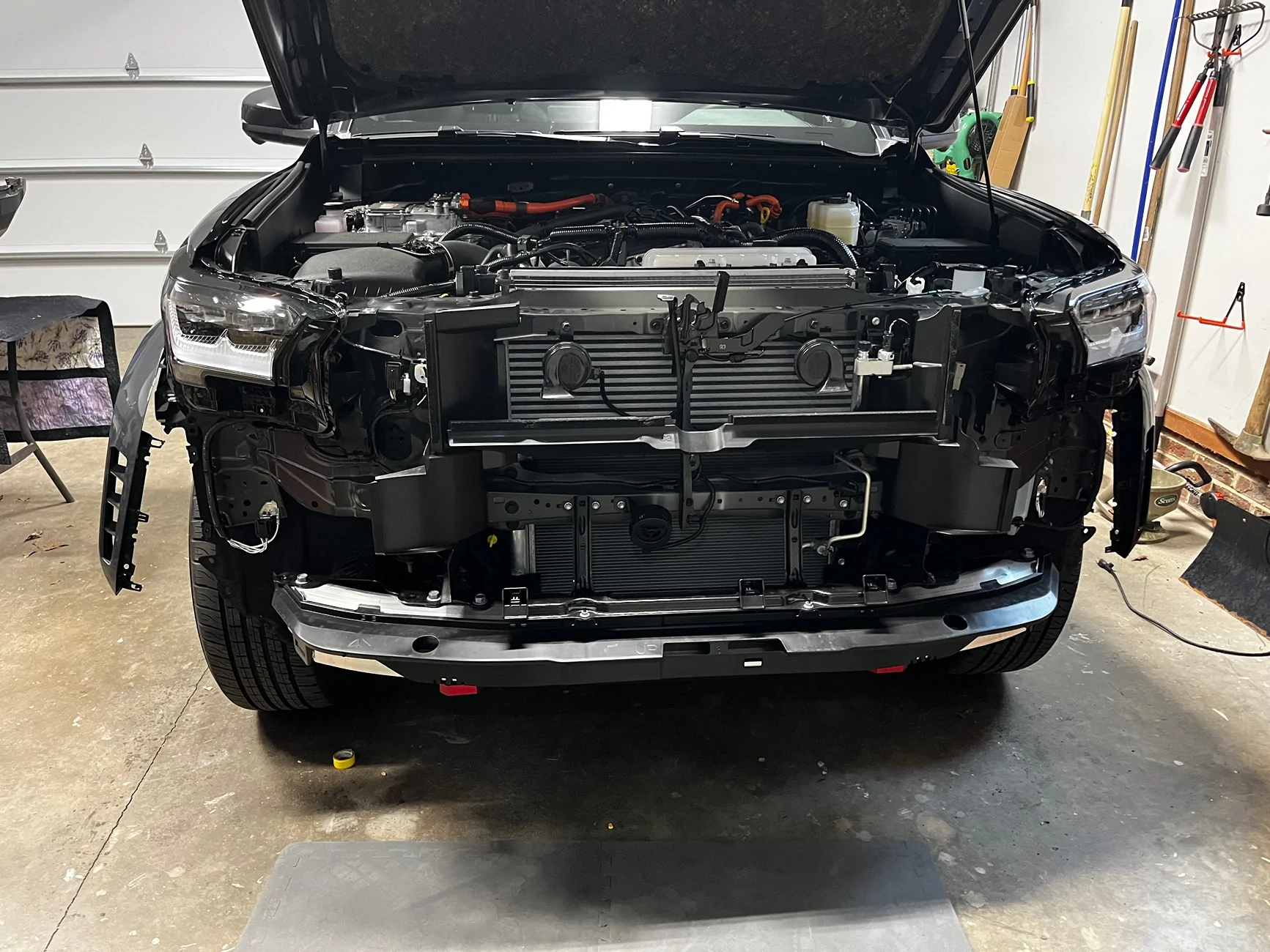

2 hours and 50minutes from hood up to hood down. YouTube time included. Not hard but patience required.
I live in fear that I’m not going to get it to fit back together right given the amount of plastic clips. All for one small grill. But I still have it on my to do list.

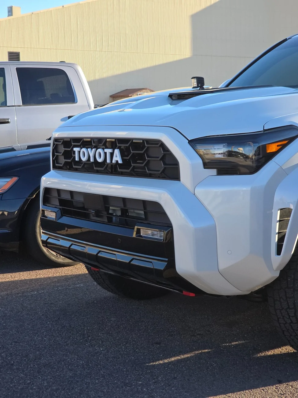

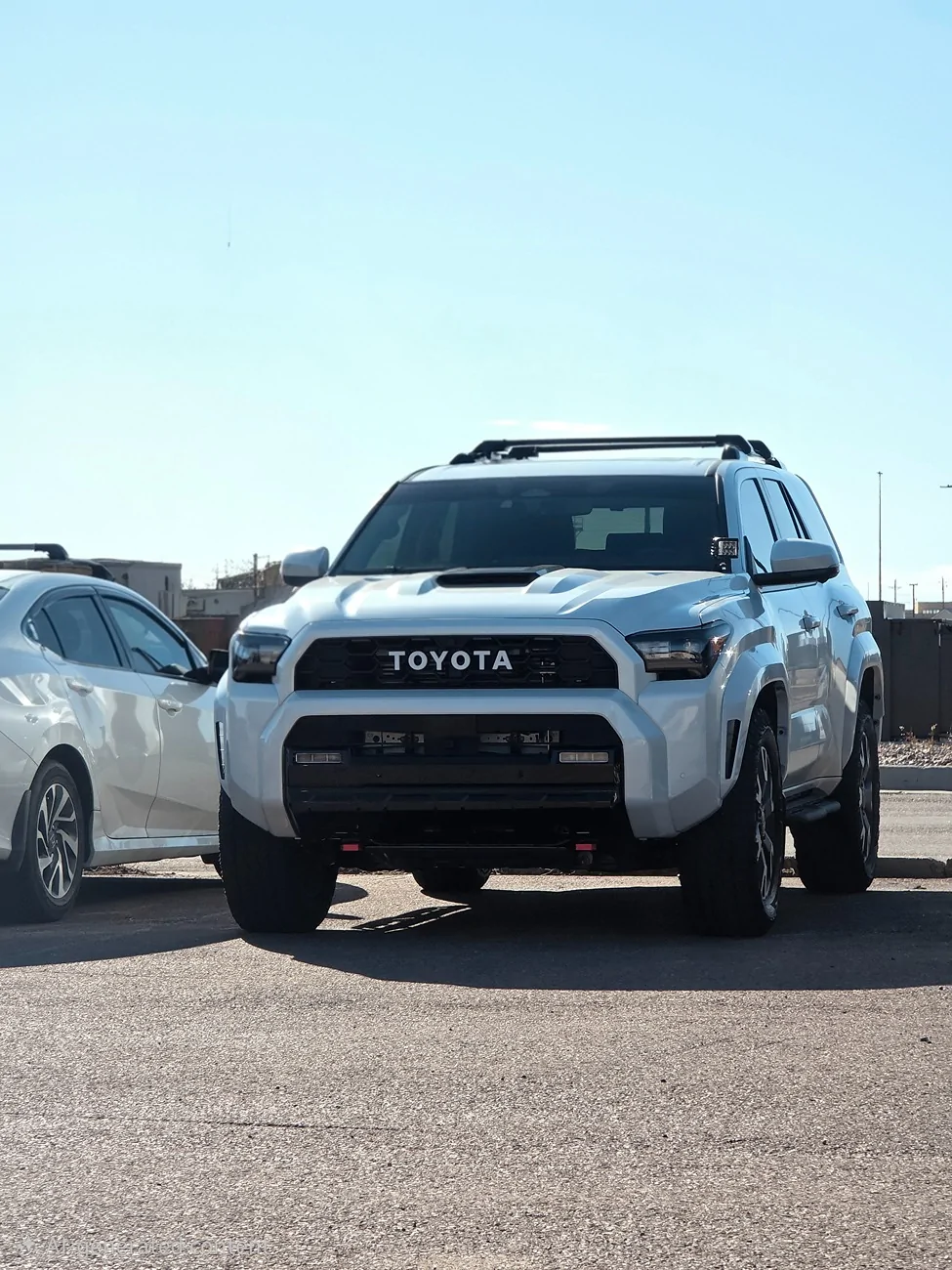

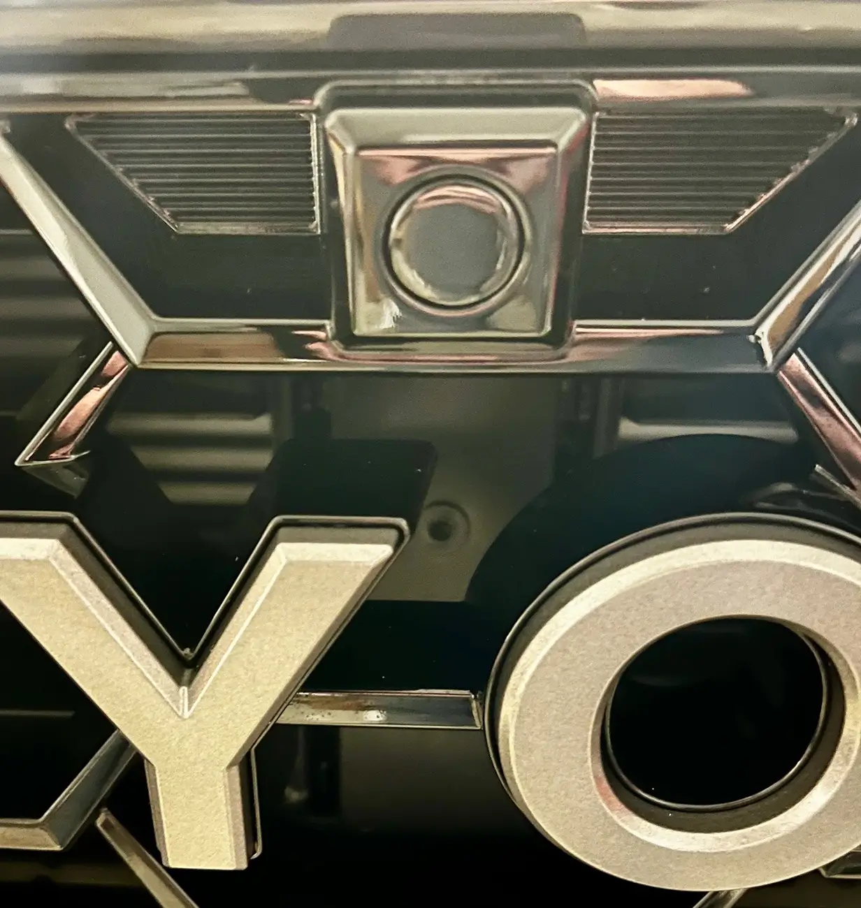

https://kocreations.shop/products/heritage-grill-camera-hole-plug
It's small 3d printed plug. Since I got the glossy TRD Pro grill, I did a light sand and sprayed it with some gloss black paint (it comes matte finish). Couple dabs of superglue on the corners to hold it in. Cheap and easy and looks good
@get.outside.75 Awesome, thank you! Are you happy with the upper grille glossy and bottom matte? Seems to look fine in the pictures but not sure how it looks in real life.
Thanks again!
Thanks again!
Yep I am very happy. For 99% of people, you would have to point out the difference. It's even less noticeable on the limited because I have a glossy black valence where the fog lights are.

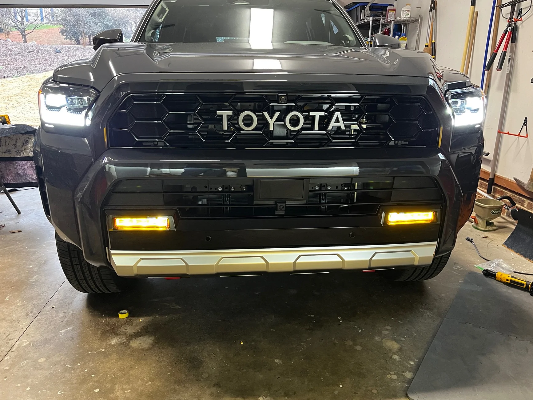

That's the light I have in there. Same color and everything.
I think I own four of them now, my green ones have lasted years of abuse in the garage.
