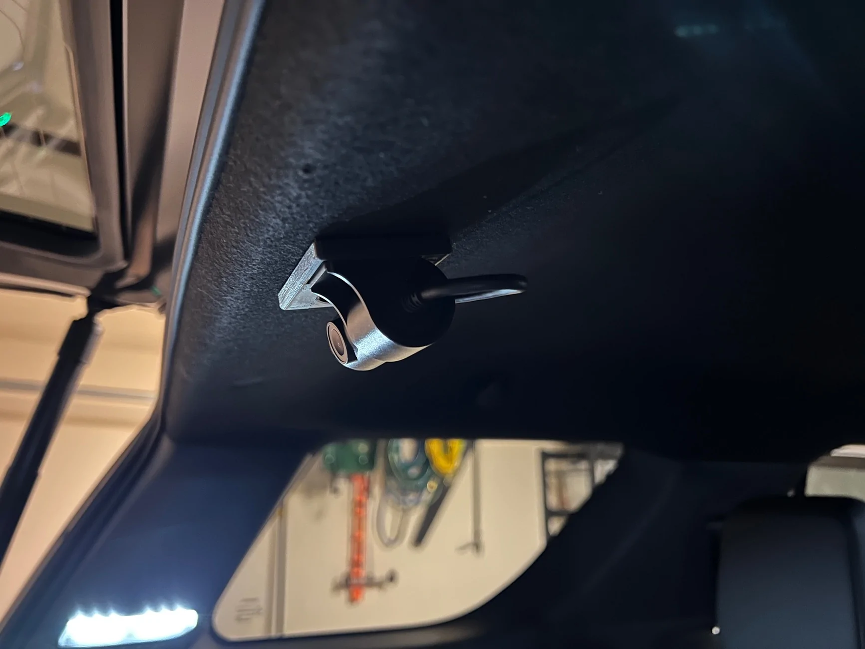

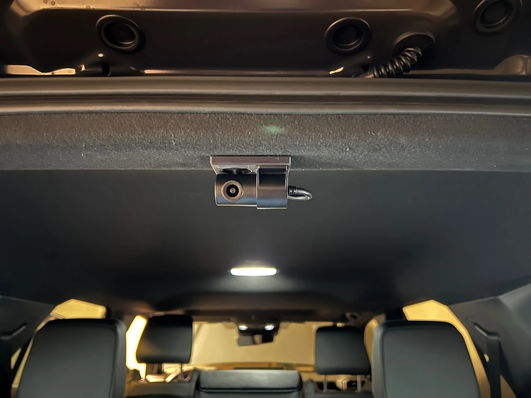

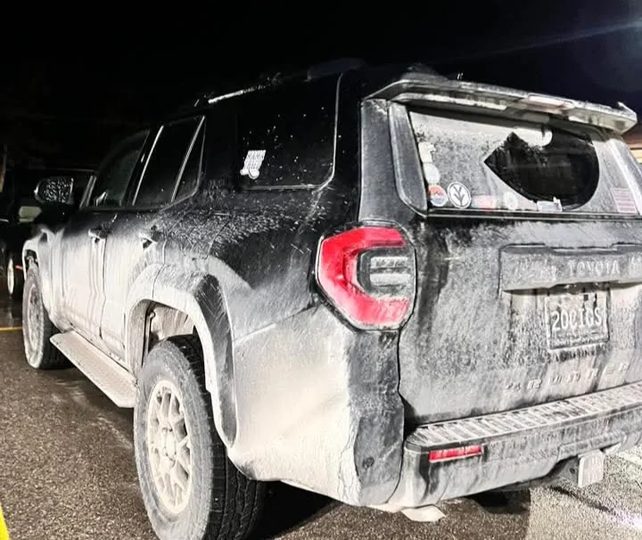

I put that mount & rear cam on the passenger side. Because when the rear window is dirty (like this) you won't see anything!
Good idea, there is enough slack to move it over. Thanks for the heads up.

Do you have a video on how you ran the wires?
I do not, sorry. I ran it on the driver side of the roof. Had to loosen or remove all the plastic trim and pull down the door gaskets on the drivers side. There is just enough room to run the cable behind\above the side curtain airbag. It took a while using a flashlight to see how everything was attached as I used pry tools.
I wouldn't dare try it without a tutorial. good work.

I ran rear dash cam wiring straight back using wall fish tape. Inserted it into the headliner from the tailgate and it came out near the driver’s visor. Pulling the cable back, it seemed to get hung up on something about halfway across, but it didn’t take much to work it free and pulled all the way back. It took less than 10 min total and required no removal of any trim pieces.

I have fish tape and would have done it this way if I didn't have the sunroof, there was not much room and a lot of roof geometry. I'm sure if I did that method it would have taken less time overall and less risk or breaking plastic pins on the trim parts.
