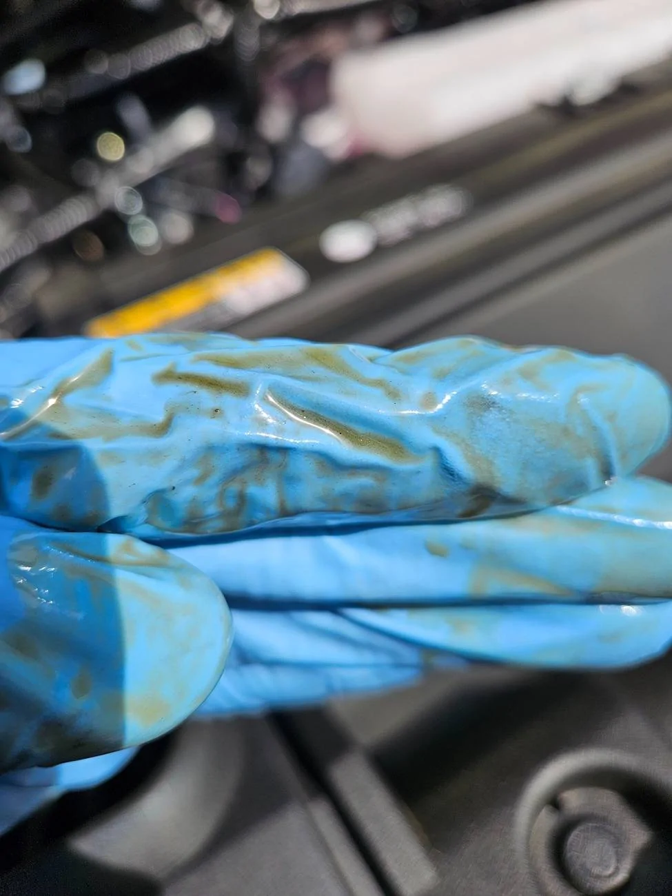

Performed the first 1,000 mile oil and filter change today on the Trailhunter. Easiest oil change I have ever done on any vehicle.
Didn't see any metal bits and shavings or other deposits in the oil
With this thin oil they all settled to the bottom for me and I also leave the pan draining for quite some time until it stops dripping. Nothing floats like on more viscous 5w40 oils. I have to pour some out and then i can see it in the last bit of oil at the bottom. Maybe the hybrids go through a different prep process

Its not bearing material, those do not come in contact with the crank otherwise wise id have a spun bearing by now. Its cylinder wall and ring shavings. I currently build performance engines and this is normal for any engine, I don't know what your filter looked like or how good your eyes are but the dust that comes out would be pretty hard to see with a naked eye on a soaked filter element, youre not going to find a 10 gram chunk of aluminum in it. If you dont believe you need to do then you don't have to do it. Your truck will be perfectly fine.
I did it, and my eyes are perfectly fine. Not a single speck of metal. Not the first oil filter I've cut open. I currently build performance engines as well and have never ever seen that much metal after a break in period just saying. That's excessive

Did my 1000 this weekend, ran it through a paint strainer with a shop towel and a 3" magnet laying on top. Ran it until it stopped dripping. Did the same with the filter.
Got no metal. Ran clear.
Not saying don't do the 1000 oil change, not sorry I did, just saying I didn't pick anything up.

Dropped the oil at the 1000 mile mark to flush out the expected metal particles and will be repeating it at 2500 and 5000.
This is completely normal for all new and rebuilt engines so nothing is abnormal here for people that arent familiar its a visual representation to remind you how dirty they really are.
Do not run 10k miles without changing the oil.
